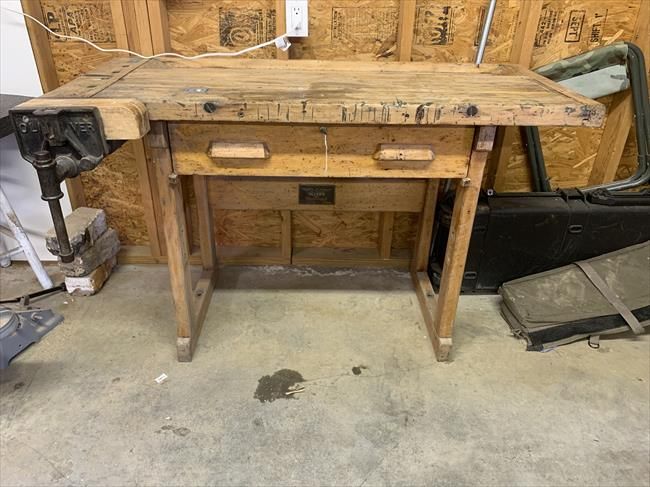

Popular Post Heidi Posted May 16, 2020 Popular Post Report Posted May 16, 2020 We picked this bench up at an estate auction and have been trying to research and gain any knowledge about the history behind this bench. We found it odd that it’s made by Oliver Machinery Co. There is no machine or serial number on the Oliver metal plaque, and can not find a number on the vise. Thanks in advance for any help! p_toad, Artie, HARO50 and 2 others 5 Quote
Cal Posted May 17, 2020 Report Posted May 17, 2020 Welcome aboard Heidi, glad to have you here. Have you tried to contact Oliver directly? They are still in business, and may be able to give you the info you are looking for: https://olivermachinery.net/company Good luck with your search! Gunny, HARO50 and FlGatorwood 3 Quote
Popular Post Larry Buskirk Posted May 17, 2020 Popular Post Report Posted May 17, 2020 (edited) Hi Heidi, Welcome to The Patriot Woodworker. I believe the bench you have is listed as a No. 1251 in the 1917, and 1923 Oliver catalogs. The vises are also listed. The 1917 catalog can be found here. http://www.vintagemachinery.org/pubs/609/20375.pdf The 1923 here. http://www.vintagemachinery.org/pubs/609/5128.pdf It looks like yours might be missing a front brace Edited May 17, 2020 by Larry Buskirk Gunny, HARO50, FlGatorwood and 2 others 5 Quote

Popular Post Heidi Posted May 17, 2020 Author Popular Post Report Posted May 17, 2020 4 hours ago, Larry Buskirk said: Hi Heidi, Welcome to The Patriot Woodworker. I believe the bench you have is listed as a No. 1251 in the 1917, and 1923 Oliver catalogs. The vises are also listed. The 1917 catalog can be found here. http://www.vintagemachinery.org/pubs/609/20375.pdf The 1923 here. http://www.vintagemachinery.org/pubs/609/5128.pdf It looks like yours might be missing a front brace We are missing the front brace, we are certain on that. The brace that is currently on the back legs should be on the front. It was moved to the back legs for stability Cal, HARO50, FlGatorwood and 3 others 6 Quote
Popular Post Gene Howe Posted May 17, 2020 Popular Post Report Posted May 17, 2020 Are those braces morticed into the legs? Could you move the back one forward and, fabricate one for the back. Artie, FlGatorwood, Cal and 2 others 5 Quote
Popular Post Heidi Posted May 17, 2020 Author Popular Post Report Posted May 17, 2020 Just now, Gene Howe said: Are those braces morticed into the legs? Could you move the back one forward and, fabricate one for the back. We can absolutely do that! p_toad, Gunny, Artie and 2 others 5 Quote
Popular Post Gunny Posted May 17, 2020 Popular Post Report Posted May 17, 2020 I have seen that brace removed on other tables as well. Usually when it is shoved against a wall and the user doesn't want to jamb a toe when working at bench. Bigfooted people problems?? FlGatorwood, Artie, p_toad and 2 others 3 2 Quote

Popular Post Heidi Posted May 18, 2020 Author Popular Post Report Posted May 18, 2020 5 hours ago, Gunny said: I have seen that brace removed on other tables as well. Usually when it is shoved against a wall and the user doesn't want to jamb a toe when working at bench. Bigfooted people problems?? We absolutely believe that’s what happened. It was sitting up next to a wall. Cal, FlGatorwood, Artie and 2 others 5 Quote
FlGatorwood Posted May 18, 2020 Report Posted May 18, 2020 Your workbench is in the 1917 catalog on the lower left of page 267. The front brace is about knee high. Welcome aboard, Heidi. So good to have you here. Cal, Artie, Gunny and 1 other 4 Quote
