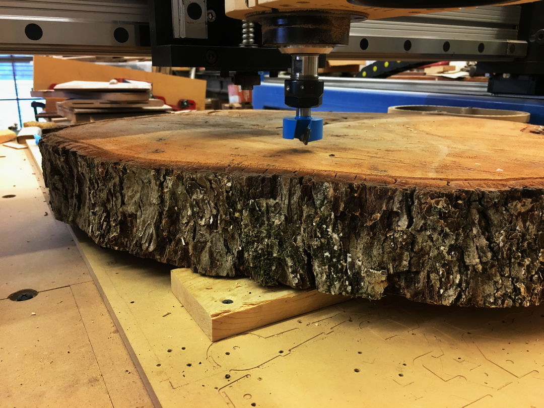

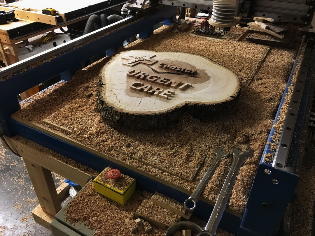

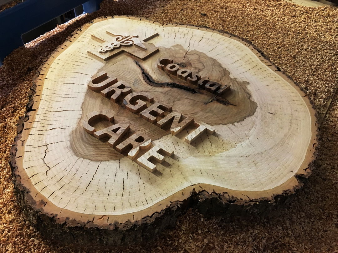

May 17, 20206 yr Author comment_229018 Thanks, Cal! It finished out at 1.6", got some heft to it. Weight is right at 11.2 lbs. Yes, the CNC makes a great planer. I took four passes with a 3/4" bit, stepping down about 0.020" each time so I could get it level but keep the piece as thick as possible. Given the glue up and how things like this go with boards being a tiny bit unlevel after the glue up, if I had known the lowest point then I could have done this in one pass. But it only took about 4 minutes per pass so it wasn't too bad. Basically, if I can get it clamped to the spoilboard in some fashion then I can level it. The largest piece I've done this with is making a sign out of a slice of Pecan. I cut it with the DC off so I could watch and get good photos/video. I think it was 25" at the widest point. 1.5" bit for surfacing Chips everywhere! Finished sign (customer put a clear coat on it front and back) David Report
