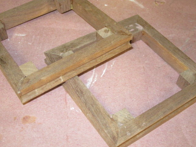

On my current jewelry box project, I made some small feet to hold it off the dresser top.
The best way to do these is to glue up all four corners into one frame piece.
Then do the profiling while they are larger pieces
Then cut and do any final shaping, and attach to the bottom of your box.
