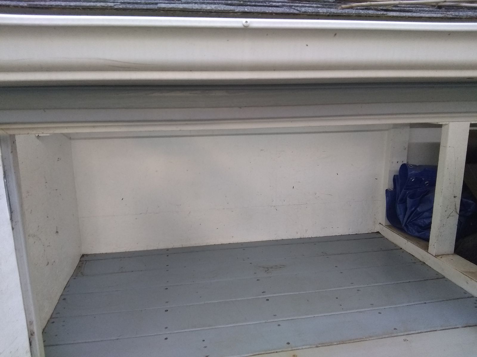

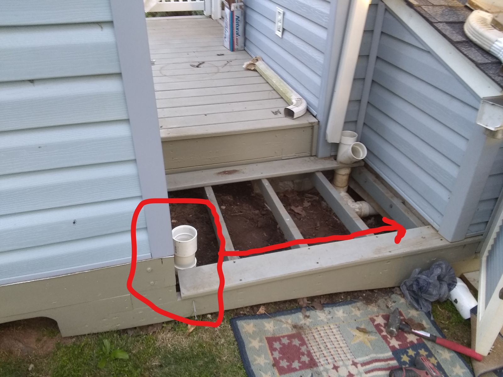

Finally have some time and supplies all in hand so I got started on adding a extra port for the gutter I installed off the storage shed.  When I built the original system I thought ahead and made sure the flooring inside the storage area was removeable with cutting it open.  Just unscrew and pull boards back up, then when done reinstall.  That part worked well.  Had to cut into the 3 inch PVC and add a junction as well as the add on leg.  No real problems, just takes some time.  Got it all done late last night about 2030.  Decided to leave it in place and if weather was good remove gutter and paint them.  Got a lot of gutter from neighbors house when he decided he hated cleaning them so took them down.  Only parts I had to buy was 2x3 downspout, and a 10 ft section of 3 inch PCV pipe, seems I was 10 inches short on supply.  Cost on project about $20.
Glad I left the gutters up.  We had some storm last night with heavy rain.  Checked today no leaks.  Next up is the deck boards outside.  Have the lumber but this rain, forget it I ain't going out today.
