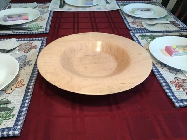

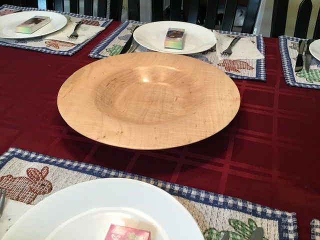

The largest platter I’ve ever turned.  A 15 inch silver maple platter.  I turned this on my Laguna Revo 1216 lathe on the outboard side.  A bit nerve racking doing it.  First I used the worm screw in the chuck and I probably should have used a face plate...once I had the bottom done and made the tenon for the chuck, it was easier hogging out the inside.  I’m pleased with the way it came out...and so is my wife! I sanded up to 4000 grit, then used triple e and finally Aussie oil.  Hope you folks like it...

That is fantastic! Love the wide rim.
Was this turned green?
Thanks Lew.  I wanted to try and do a platter that would be like a shaker style and thought the wide rim would do it.  The silver maple is dry.  I got it from a local hardwood lumber yard.  The piece I got was 2 inches thick by 15 1/2 inches wide and 3 feet long.  It a beautiful piece of maple.

Well done. How was it turning outboard on the Revo?
It was strange.  I mounted the piece on the lathe using the worm screw.  In think I would use the face plate next time.  Speed was a definite factor on the outboard side, and with the fact that the lathe vibrated pretty bad until I could get it round.  Once I had the bottom turned and put the shape I wanted, it went well once I was able to flip it around and hog out the platter and shape the top....but it was a lot of fun....
