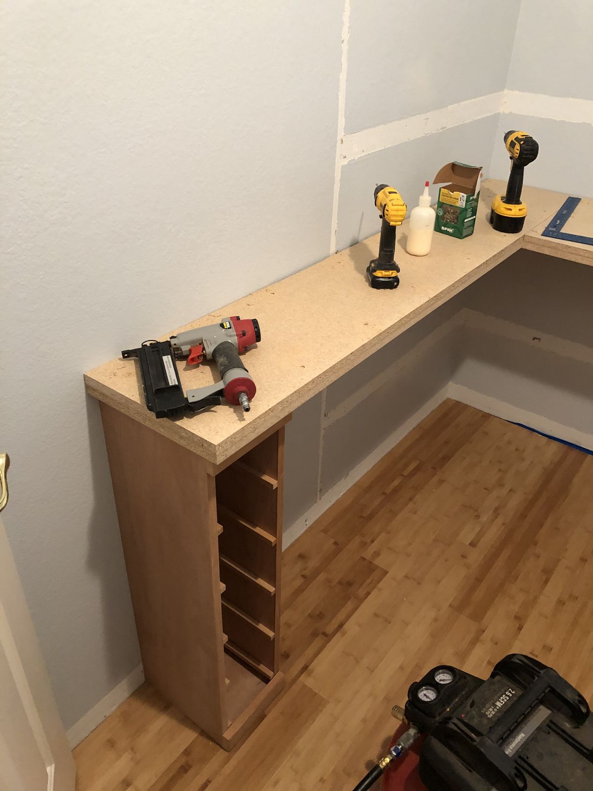

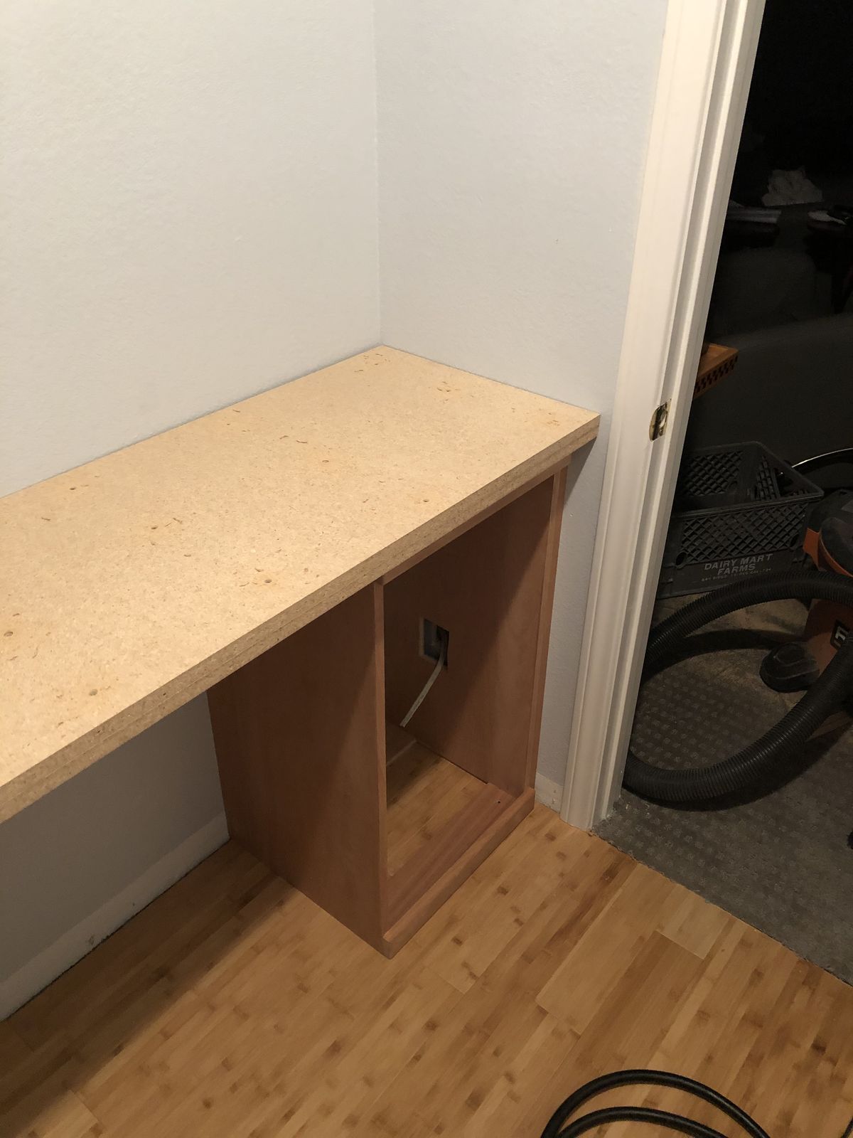

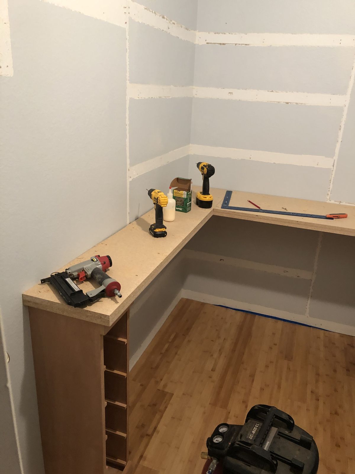

Productive day today. Got the cabinet carcasses in and sub counter done. Has particle board gotten heavier or just me older. Hmmm.
Paul
The sheets on the bottom of the pile are heavier.  :D

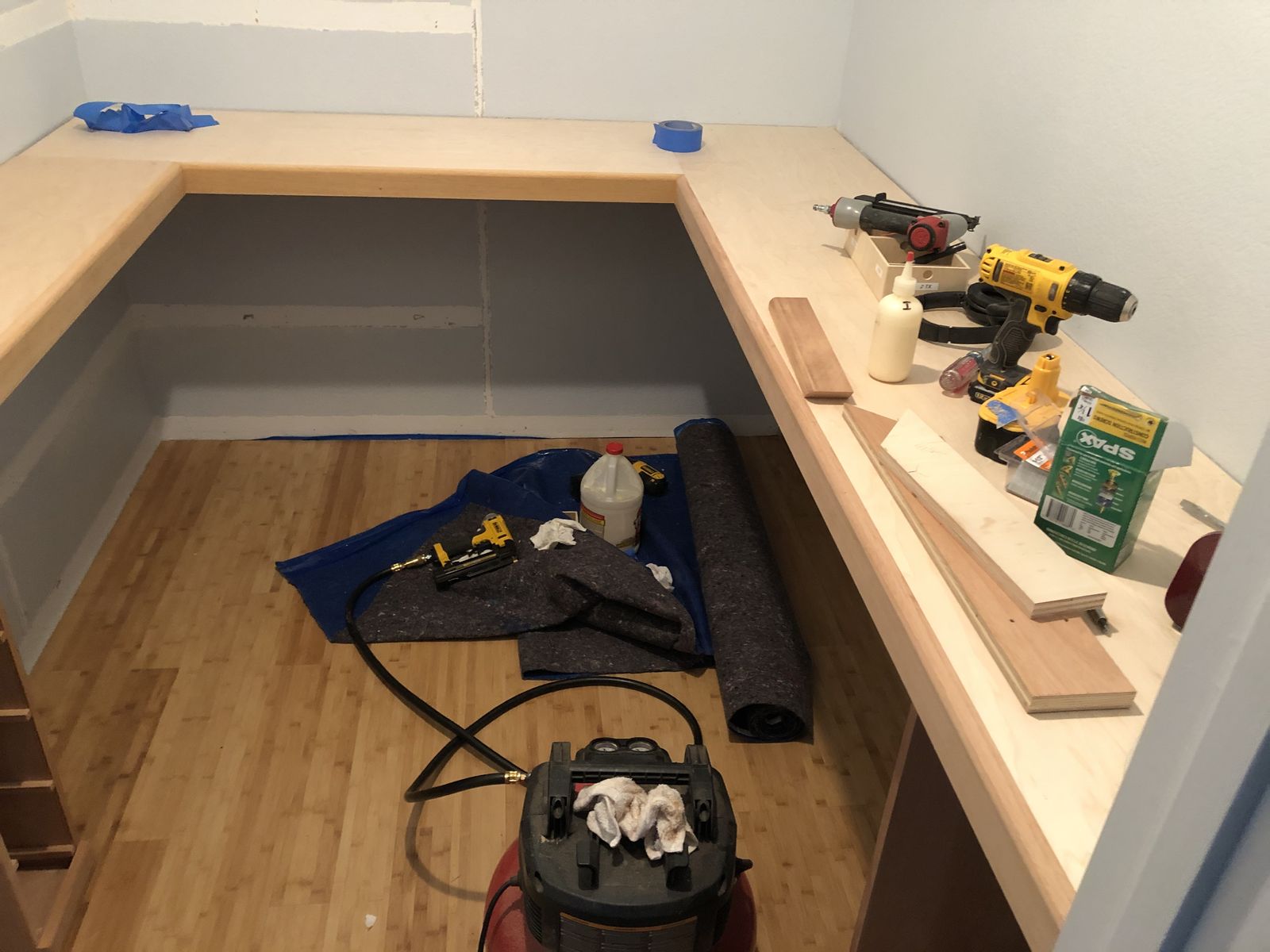

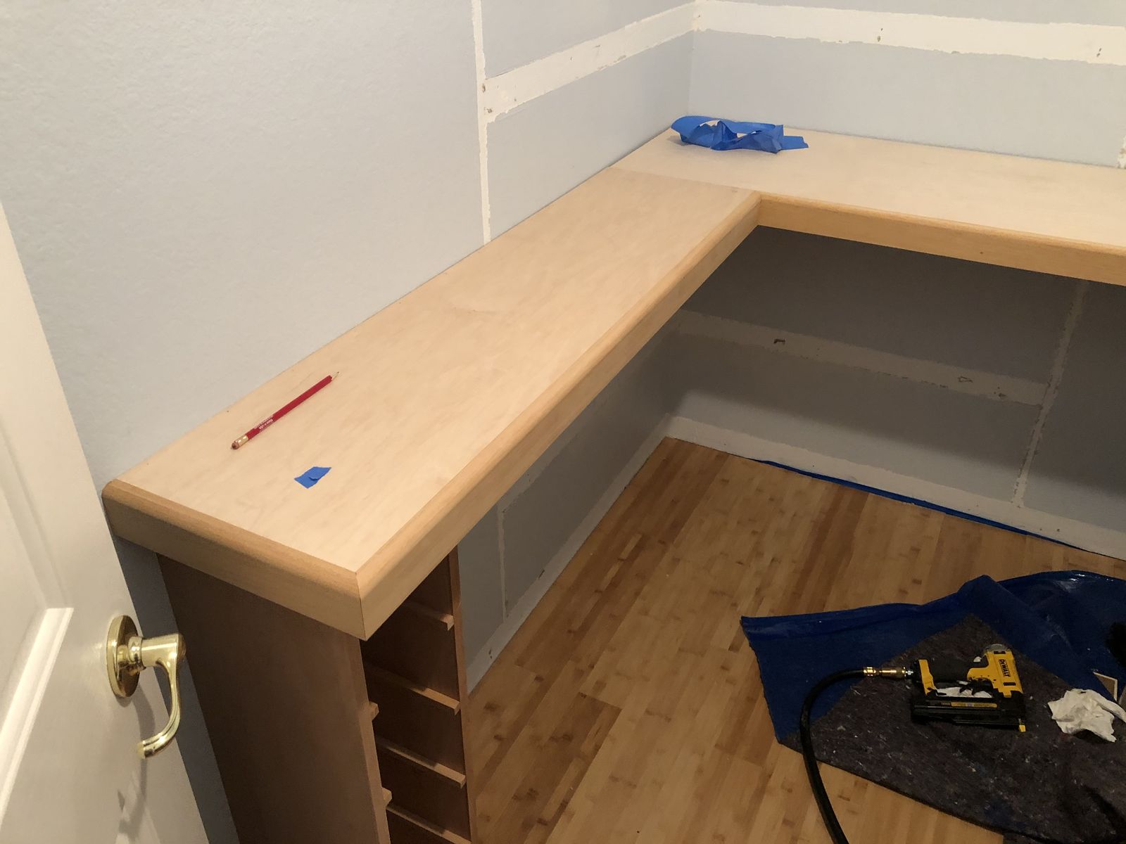

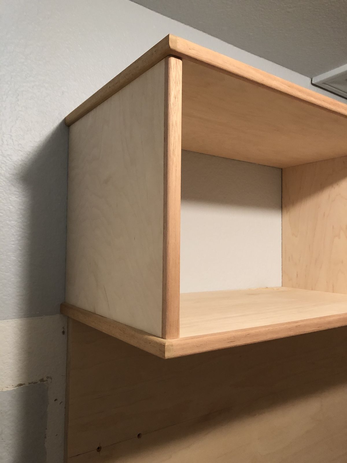

Didn’t have that much time to spend on the project today but got the maple counter top on and the mahogany bullnose.
Paul

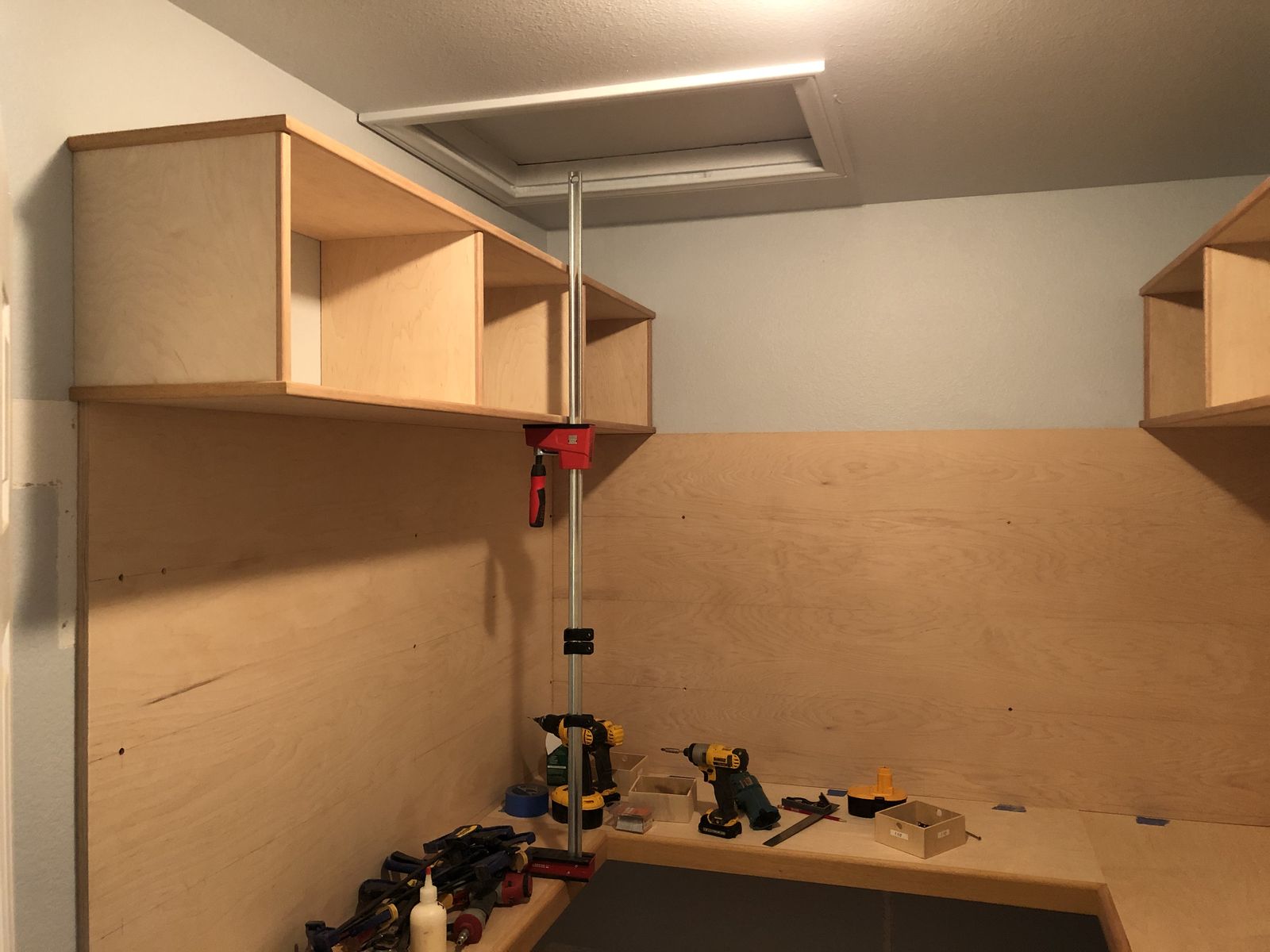

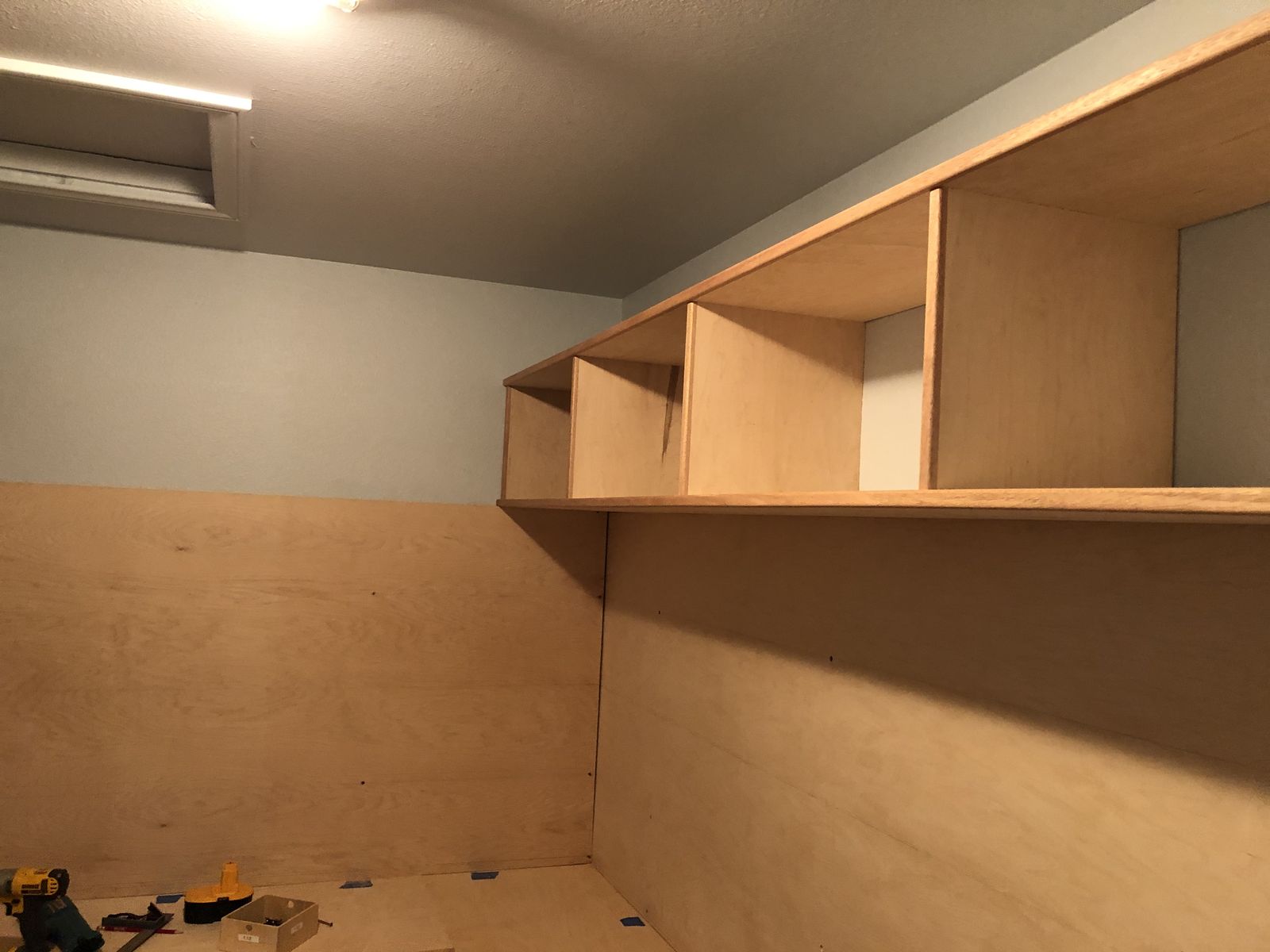

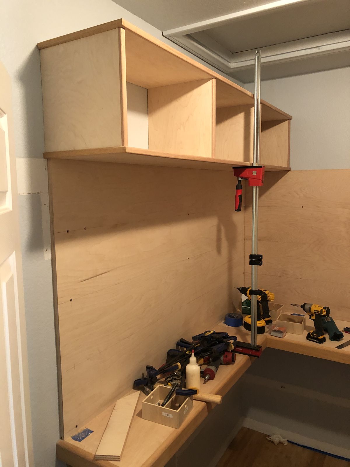

Progress today ! The ply wall space and uppers are in.
And looking mighty nice too Paul.
Hi Paul nice build is the attic access still accessible?

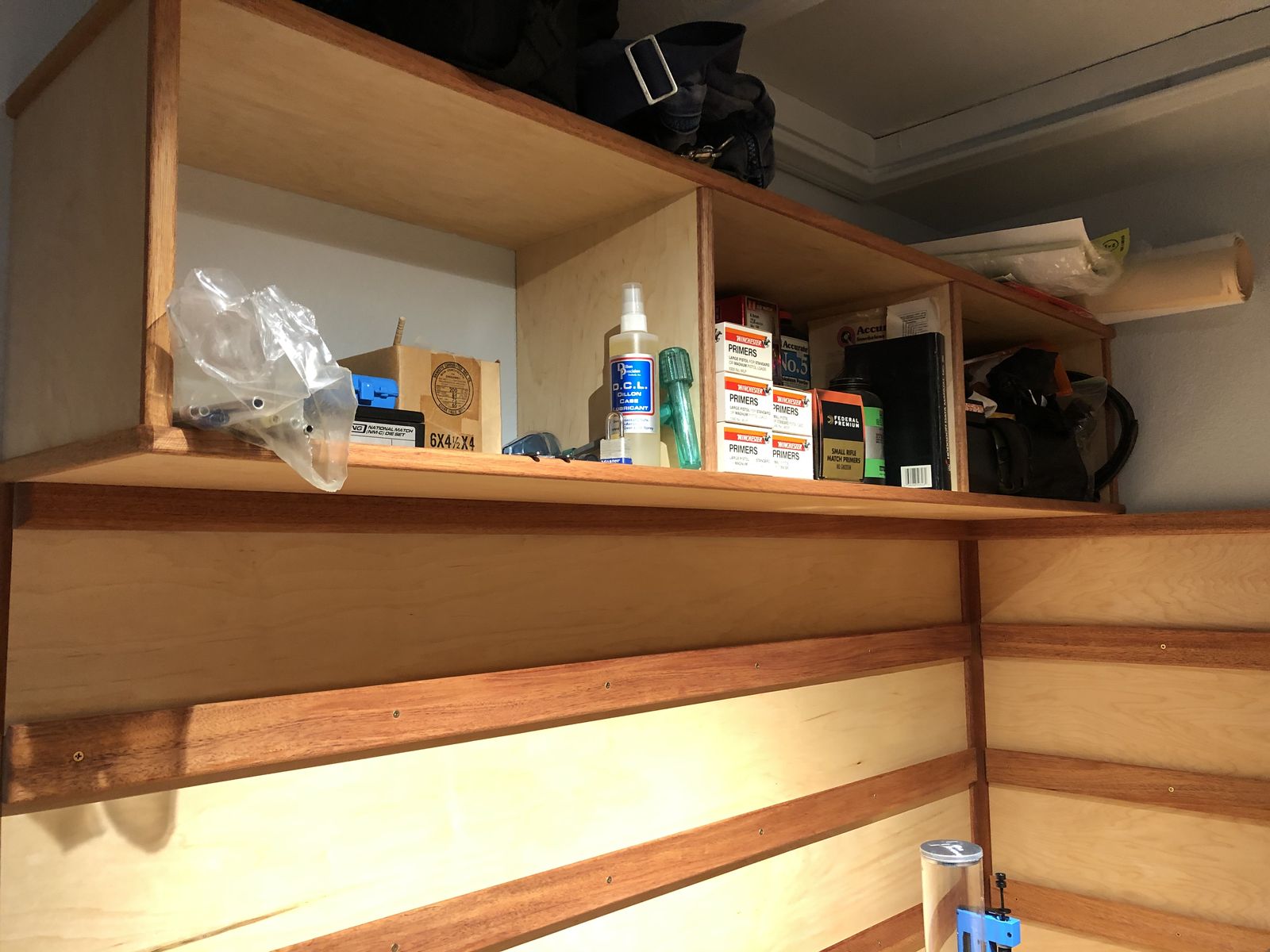

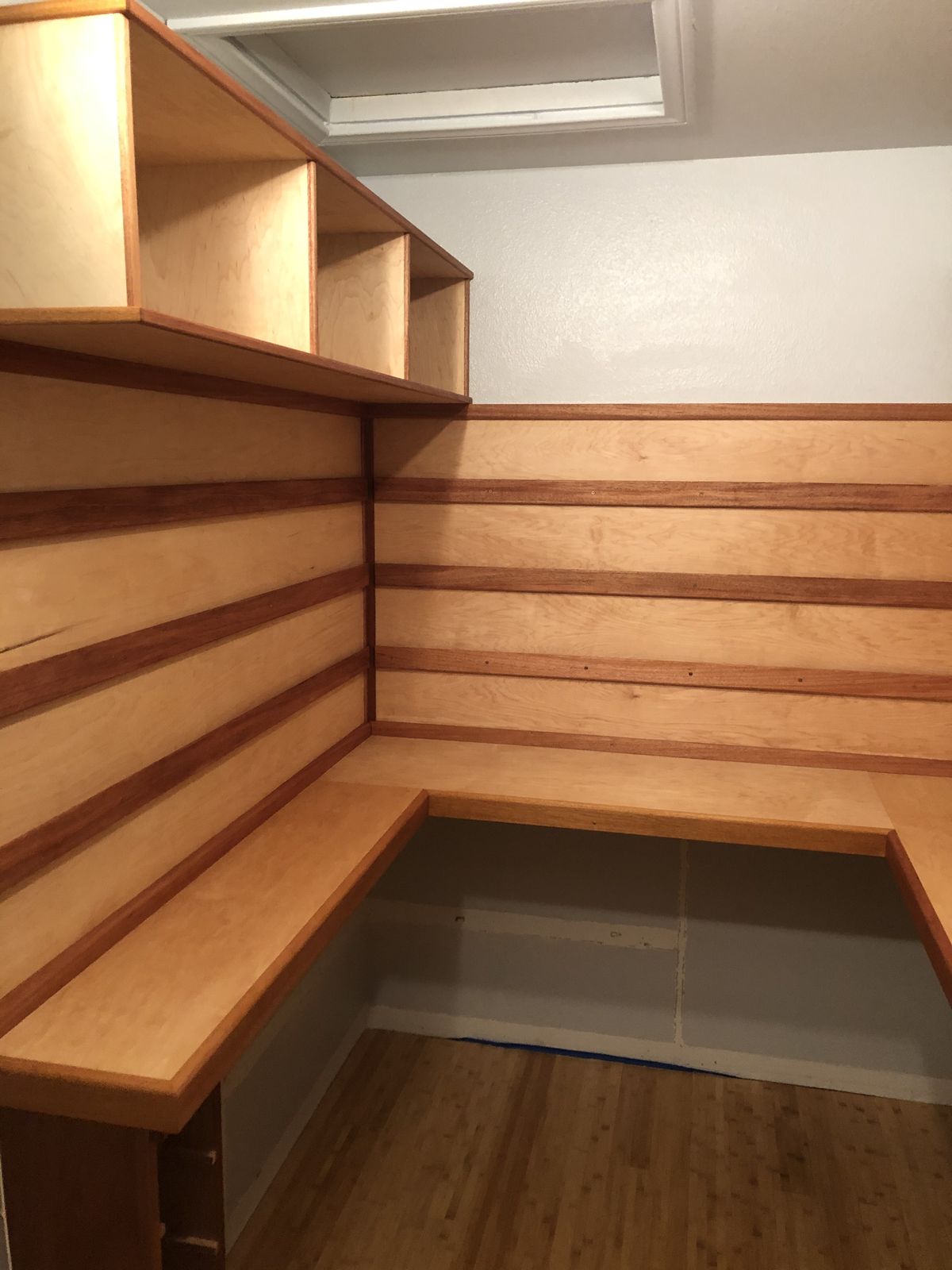

Yes it is. It is essentially the same dimensions as the shelving when it was a closet. The other factor was being able to remove that shelving unit so there is unobstructed access when needed. I finished trimming out the room, sanding and first coat of finish on !

Looking real good.

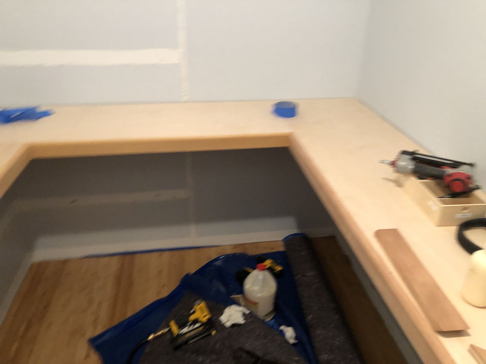

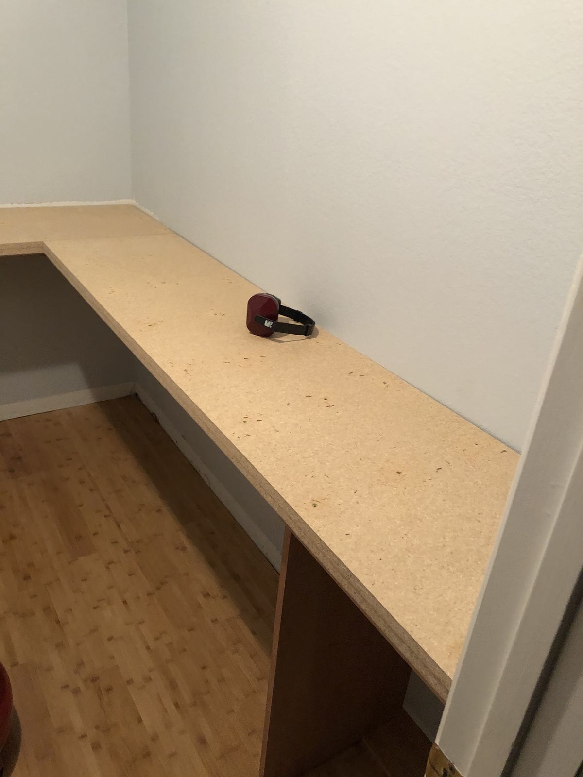

How is that countertop supported in the back of the room? I can see some floor support on each end, but am curious about the part I don't see.
It’s a monolithic type counter. It’s supported with the ledger on the back of the counter and the on the cabinets at each end. There are three layers, two of 3/4” particle board and one of 3/4” maple ply. Each layer is glued to the one below and cross laminated at the corners so no other support is needed. It is rock solid.
Paul
2 1/4 in he's thick, yeah solid would be accurate.:D
I needed to be able to slide my chair around the room unobstructed. Its a small room. It’s also a very quick and cheap way to get solid countertops.
Paul

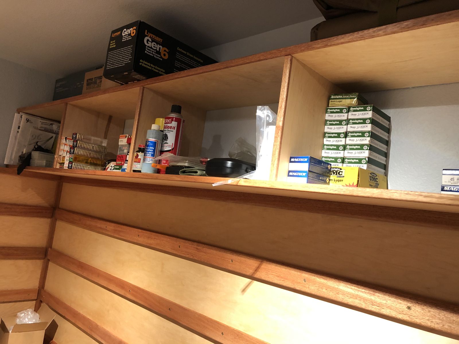

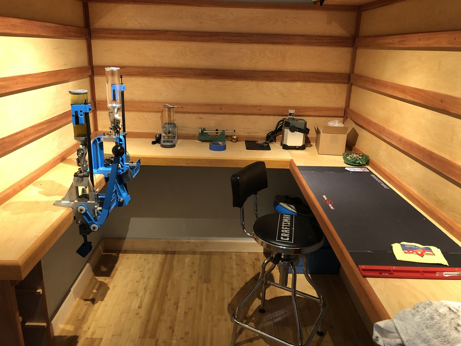

As usual, excellent job, buddy! I really like the French cleats. Please show us them in use when you get the containers built.
Nearing the end of this project. I still have to make the drawers. I finished gluing up the drawer sides today which is the hard part. I got the presses installed and all my components out of storage boxes and on the shelves. Getting close to making ammo.
