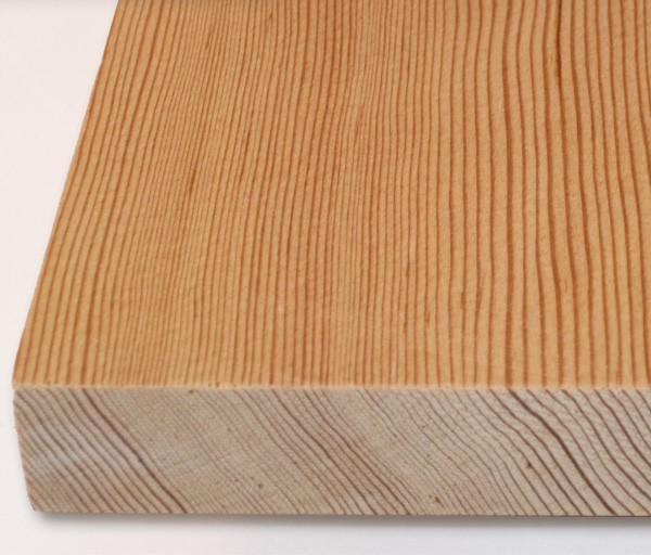

March 13, 20206 yr Popular Post comment_221451 Local Lowes carries some clear pine which is mostly slab cut. To me straight grained Douglas Fir is quality pine. Report
March 13, 20206 yr Popular Post comment_221456 Pine is in the eye of the beholder as far as new lumber is concerned stay away from cathedral grain unless building boxes for utility use or shelves. The grains Dan showed are good for anything and will make a great looking project , problem is it usually costs more and may not be in the widths you need. Also higher grades will usually have tighter grain and therefore usually is stronger. Report

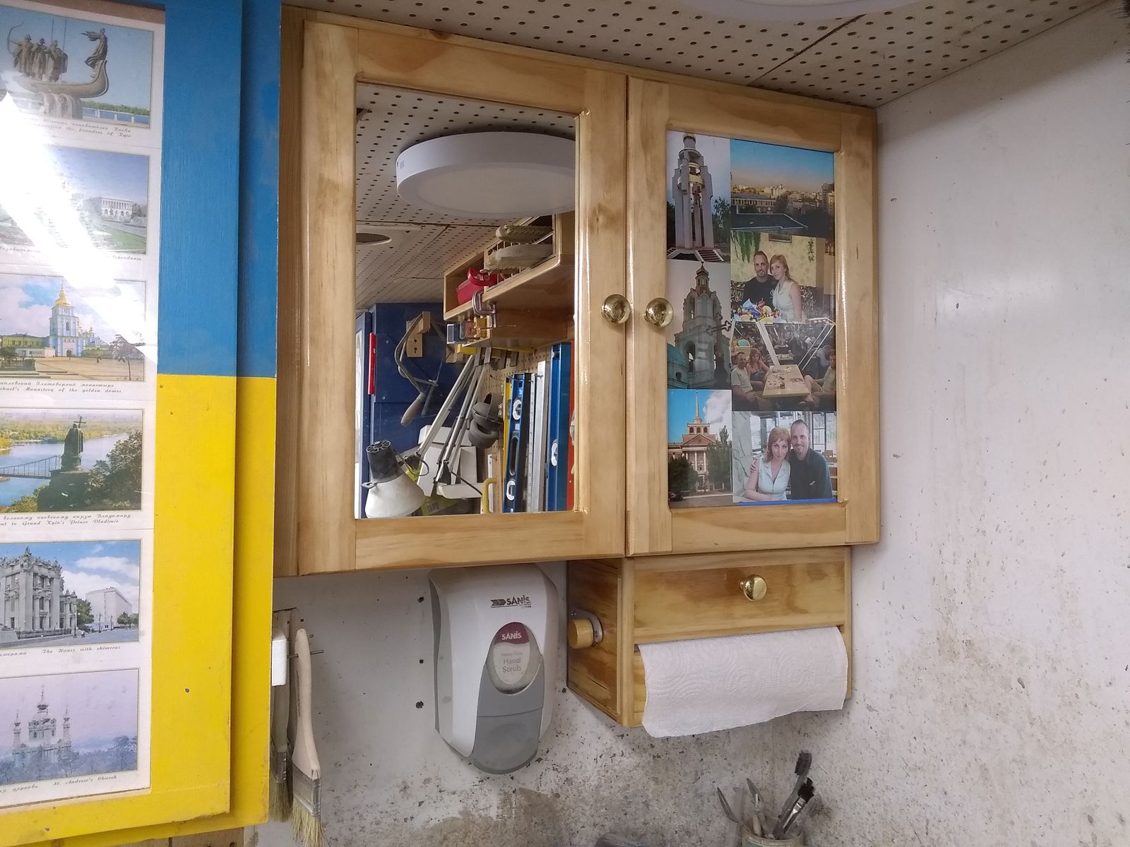

March 14, 20206 yr comment_221479 3 hours ago, Gerald said: The grains Dan showed are good for anything and will make a great looking project I agree, the face frame and door frames were made with the same Clear Pine from Lowe's. Report
