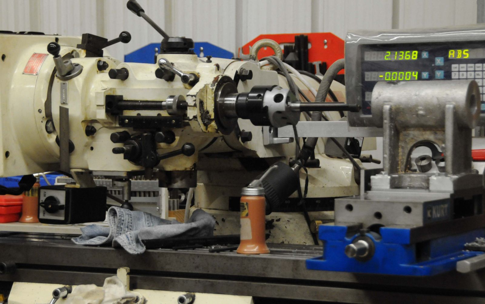

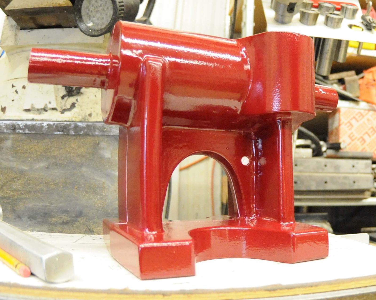

March 7, 20206 yr Popular Post comment_220818 I've been making a tail stock for an old Delta lathe. 1950's? I cast the body using a junk alloy wheel from a Mazda. Bought a piece of 3/4" acme threaded rod and a 1 3/4" piece of steel rod. The rest was from various pieces of scrap. Took me way longer than it should have but it turned out to work quite well. I did it mainly to see if I could. I'm a wood worker not a machinist. In retirement I decided to try metal working. Bought a mill & lathe. I still need to do some cosmetic clean up. Now I need to find a tool rest for it. Report
March 8, 20206 yr Author Popular Post comment_220860 Larry B, There is no model # on it. Serial # tag is 121-6167. It was given to me in the early '70s, in pieces. No tail stock or tool rest. The spindle taper was damaged, had been spun. Spindle bearings were locked up. Step pulley was missing set screws and had been spun on shaft. Had glue all over it. I have an employee that likes to turn. His lathe is a total, flimsy, cheapy. I have the leg set and original motor & wooden shelf. I told him he could have it and I'd try to make a tail stock. Making the tail stock pushed the limits of my metal working. There were a lot of setups to do. I made the casting pattern in wood and the core was made using sodium silicate & sand. It took me 7 tries to get a good core. Sand casting aluminum isn't all that hard but doing it well..., I hope to get better at it. The pattern is split down the middle and indexed with dowels. Report
