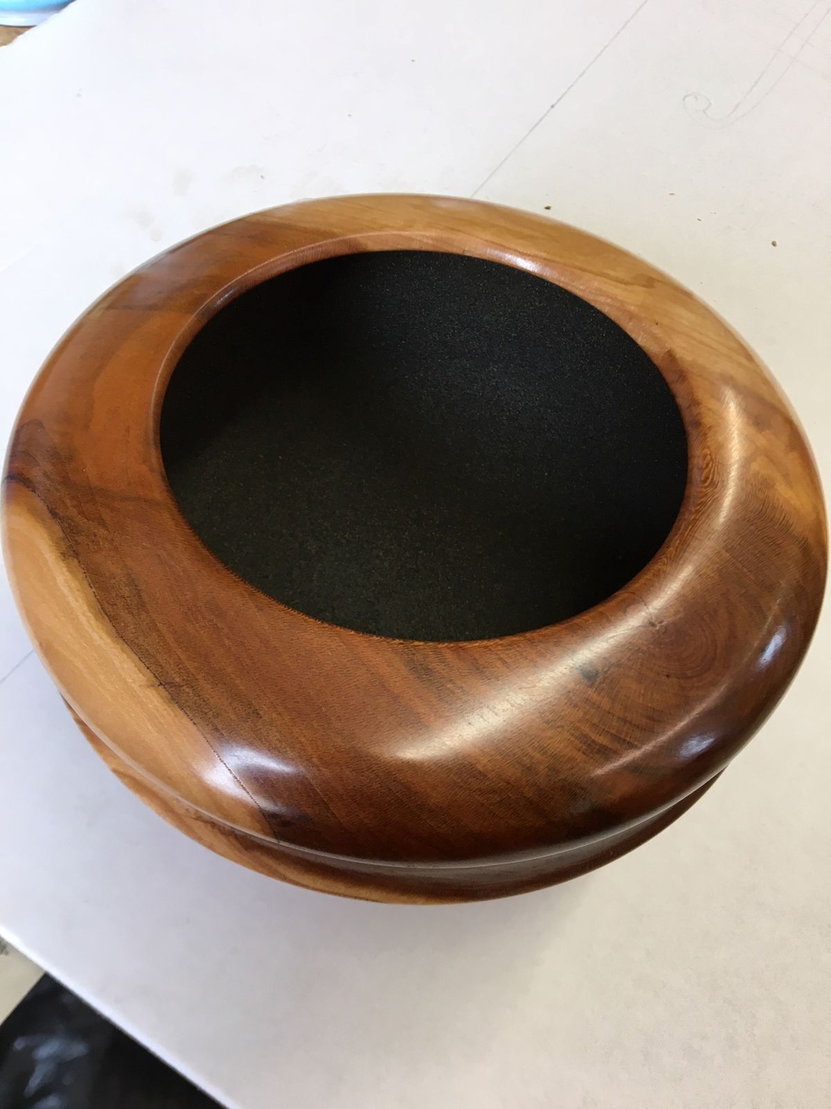

February 27, 20206 yr comment_219919 I'm still working on how to finish the inside of vessels. Still looking for tips and wisdom. Somebody posted some wisdom here a few months ago that for a vessel with smaller than a five inch opening, people don't or can't look inside that well to see the finish. I think there is truth in that. From that post, I have tried black gesso on the inside but struggle with its sturdiness with any use. It is basically an acrylic paint, from my understanding. Here, I used a cobblestone spray paint. It adds a sturdy texture to the inside that contrasts with the super smooth outside. My artsy friends really like it, and it is a whole lot easier than trying to finish the inside as smooth as the outside. I'd still like to hear from others about how they finish the inside of vessels with small openings. Report
