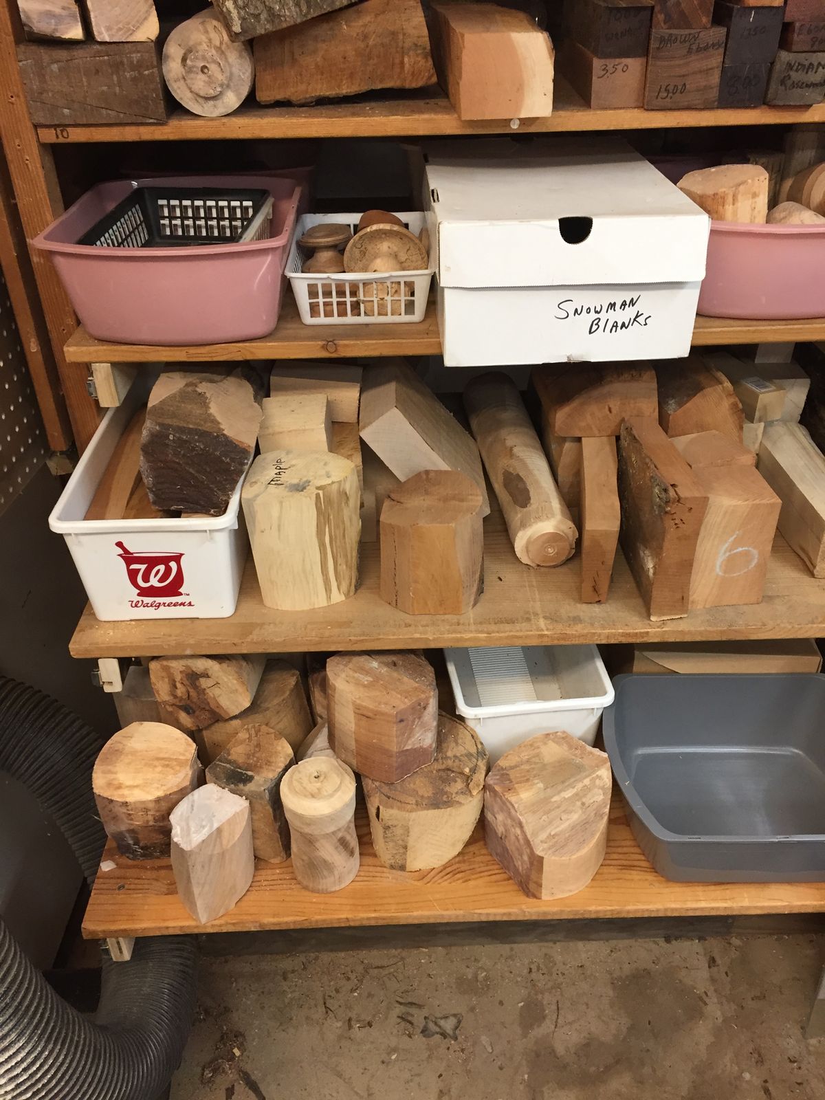

Finished this project today. 912B1C73-DFF3-425D-BB05-DDEC57BF2A9A.jpeg.1ffac0bedbffb7866b6630e3845e6e12.jpeg

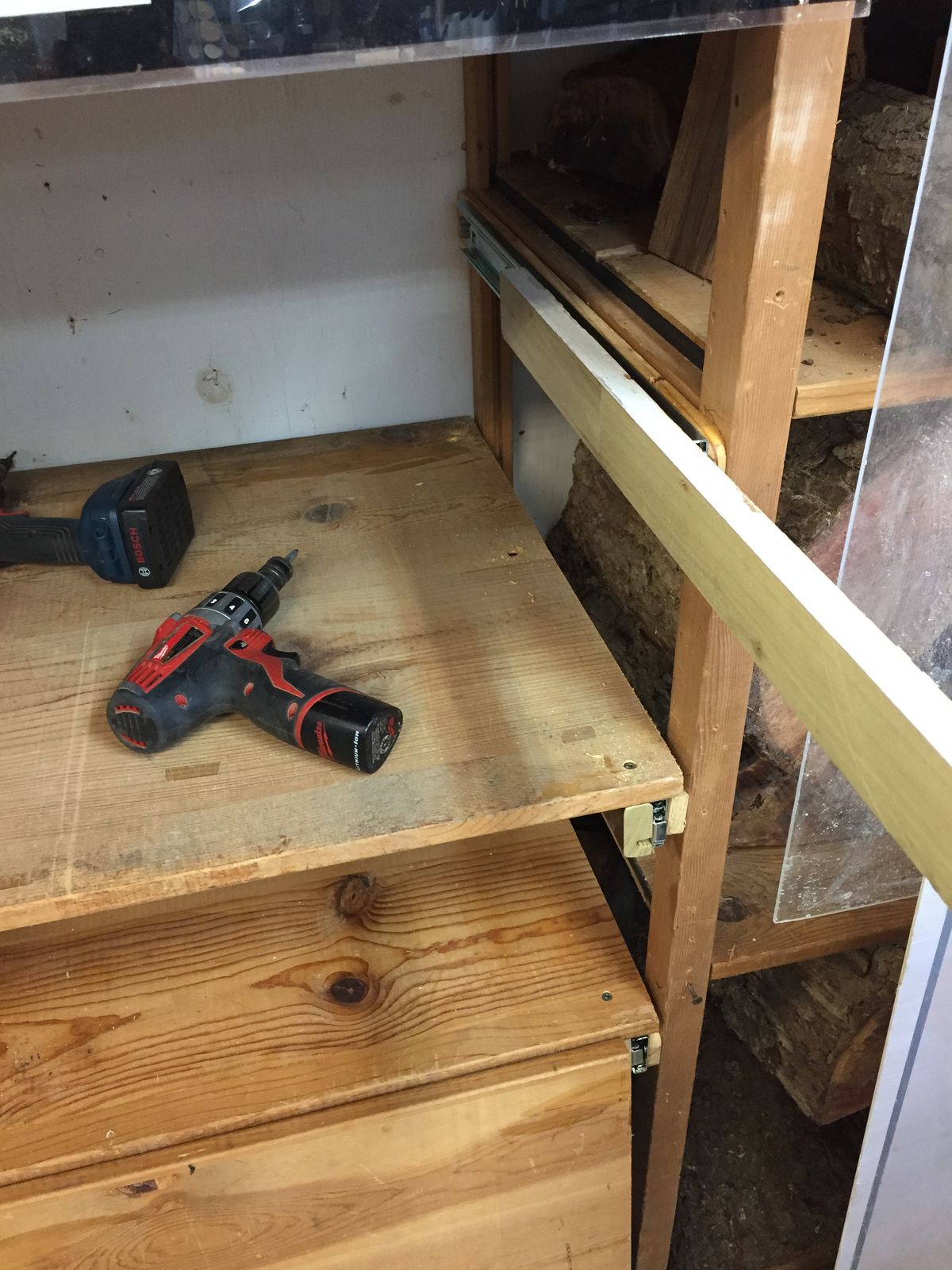

Installed strips to mount slides on the shelf uprights.
Installed the slide to uprights and then to a strip to mount the shelf onto.
This is the shelves installed and partly loaded. May have to place a strip at the back of each to stop blanks from falling off when pulled out. Oh the shelves were some that fit the original system but damaged slightly. Measure on each 24 x 36.
Gerald I have done this before and after a time remade the bottom with short sides and a back to keep things from falling.
Add another in support of adding the back or rail on the back to prevent items from falling behind and preventing the shelf from returning to its normal position.  Otherwise, a great plan and well executed.
I seriously misunderstood how you were going to use the slides. I thought you would place them flat under the tray, (that was the Seiler reference I mentioned). You really got that set up nicely.....well done! (Sorry for my misconception.)

Y'all were not deceived but the plan changed. I was going to lay the slide flat on one shelf and attach a second shelf to the top of it. I reconsidered this plan due to the fact that the shelves on these supports are held down by gravity and not by any fasteners. Now my thoughts were that a heavy slider would cause the back of the lower shelf to tip when the slider is pulled out and therefore a design change.
     Yes I think backs are coming to stop the fall off in that area too. Although if all the stock on it were square it might not be much of a problem. And is I had enough baskets for smaller stuff also not a problem. But that is for another time right now.
