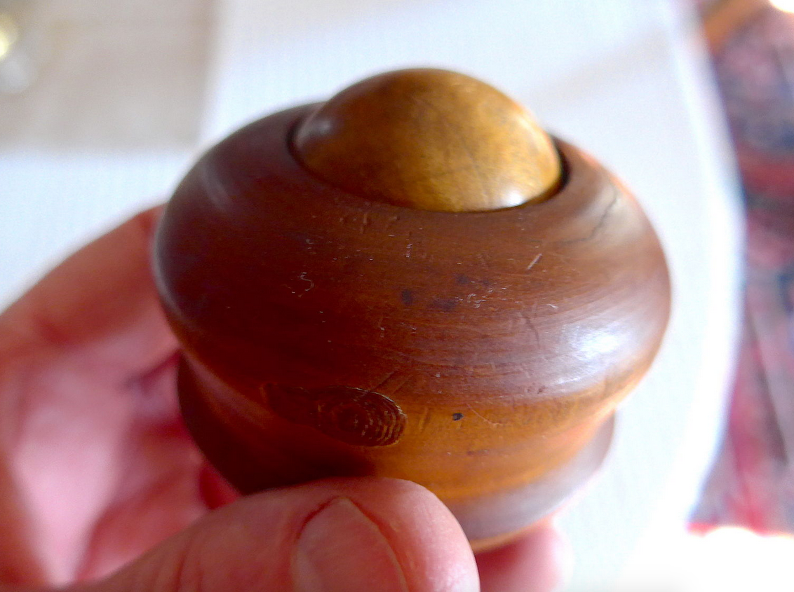

February 21, 20206 yr comment_219395 I picked up this wooden object at our local auction house and was wondering if anyone can tell me the use for it? I think I know? It seems to be turned from a boxwood or hard maple wood, the ball rolls around nicely inside of the socket without falling out. It's stamped as Pratt & Lambert. Report
February 21, 20206 yr comment_219397 I'll give it a WAG. Use it to massage your palm and wrist when it cramps up while painting. Report

February 22, 20206 yr comment_219449 "pratt & lambert varnish marker" search turns up repair pens. Maybe @kmealy might know. Report
February 23, 20206 yr comment_219505 Roll it over your varnished surface to check for drying status. Report

February 28, 20206 yr Author comment_219964 On 2/21/2020 at 3:37 PM, HandyDan said: I'll give it a WAG. Use it to massage your palm and wrist when it cramps up while painting. Dan, you're the closest to the use of this thing. The auctioneer told me that this was used for "massaging" the body but he didn't say which part. I like your answer. Now........ how was this put together???? Report
February 28, 20206 yr comment_219965 I would cut a block into two pieces, turn the socket for the ball into each piece, insert the ball and carefully glue it back together and turn the out side to shape. The socket and ball should be thoroughly waxed before gluing. Report
March 9, 20206 yr Author comment_220978 On 2/28/2020 at 9:08 AM, HandyDan said: I would cut a block into two pieces, turn the socket for the ball into each piece, insert the ball and carefully glue it back together and turn the out side to shape. The socket and ball should be thoroughly waxed before gluing. As explained to me, the ball was turned separately, then really dried, while the cup was turned with the wood extremely wet, and then the two put together(ball into wet cup). Anyone care to duplicate this?????? Report
