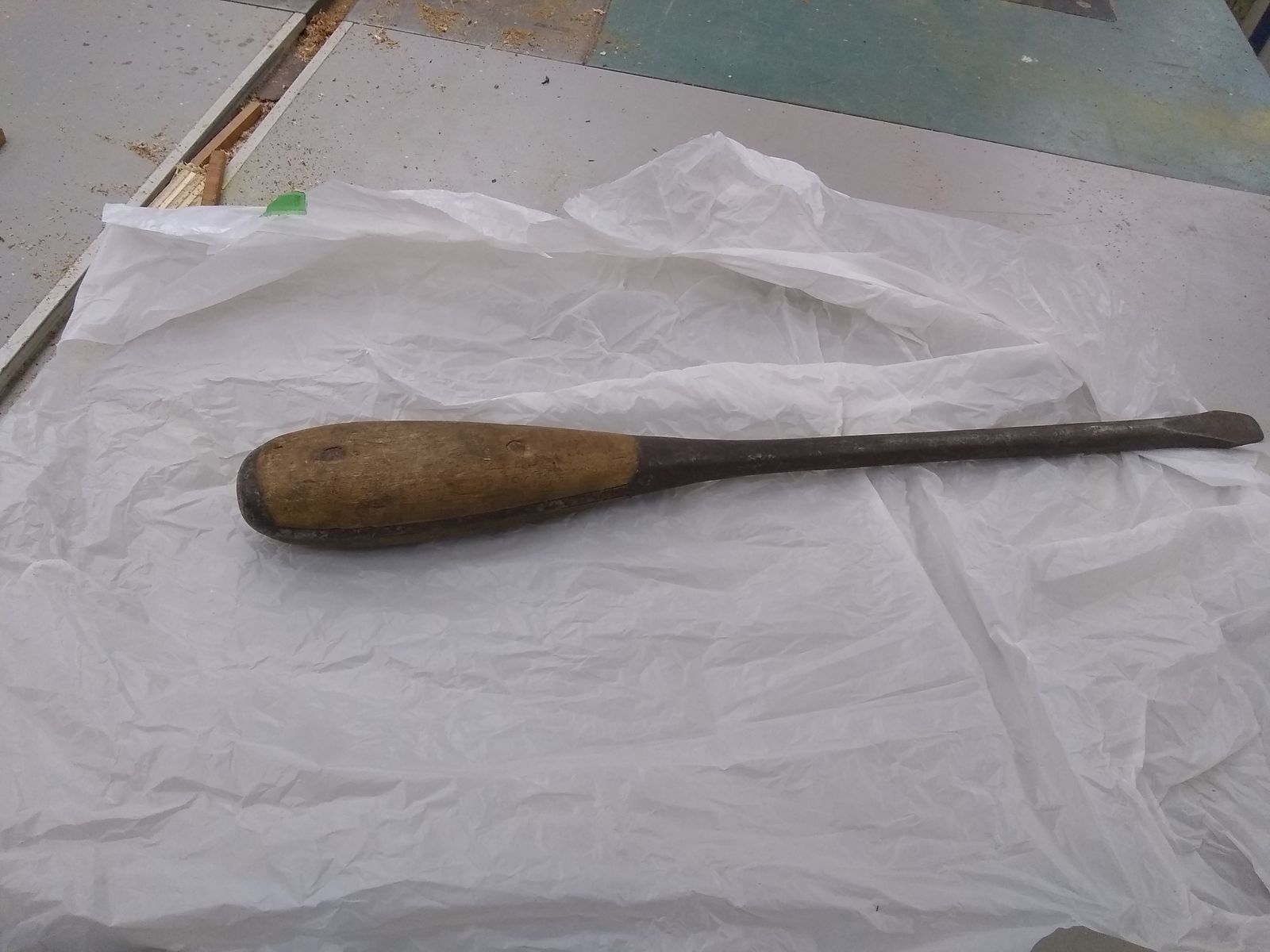

Okay I have this screwdriver, unless someone comes up with a different name for this tool, and it belonged to my Grandfather.  The wooden handle inserts needed replacement, got stabbed the other day.  I removed them and made two replacement pieces to fit the angled edges.  Used some 100+ year old mahogany.
So my question is what would be the best way to go about attaching the handles again.  Then any suggestions on carving down the handles to fit this nicely?

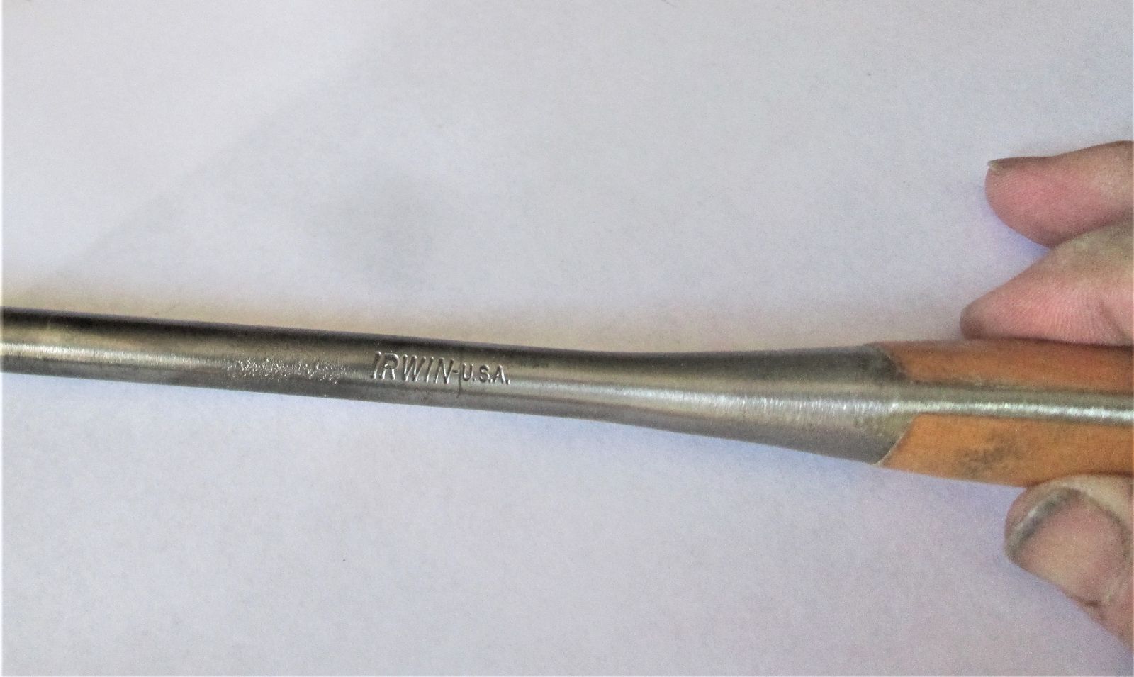

I posted pictures of the numbers I found inside the handles.  Anybody got any ideas on how old this thing is?

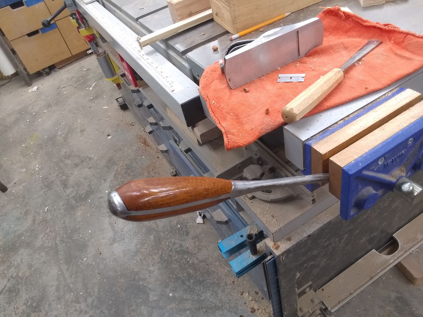

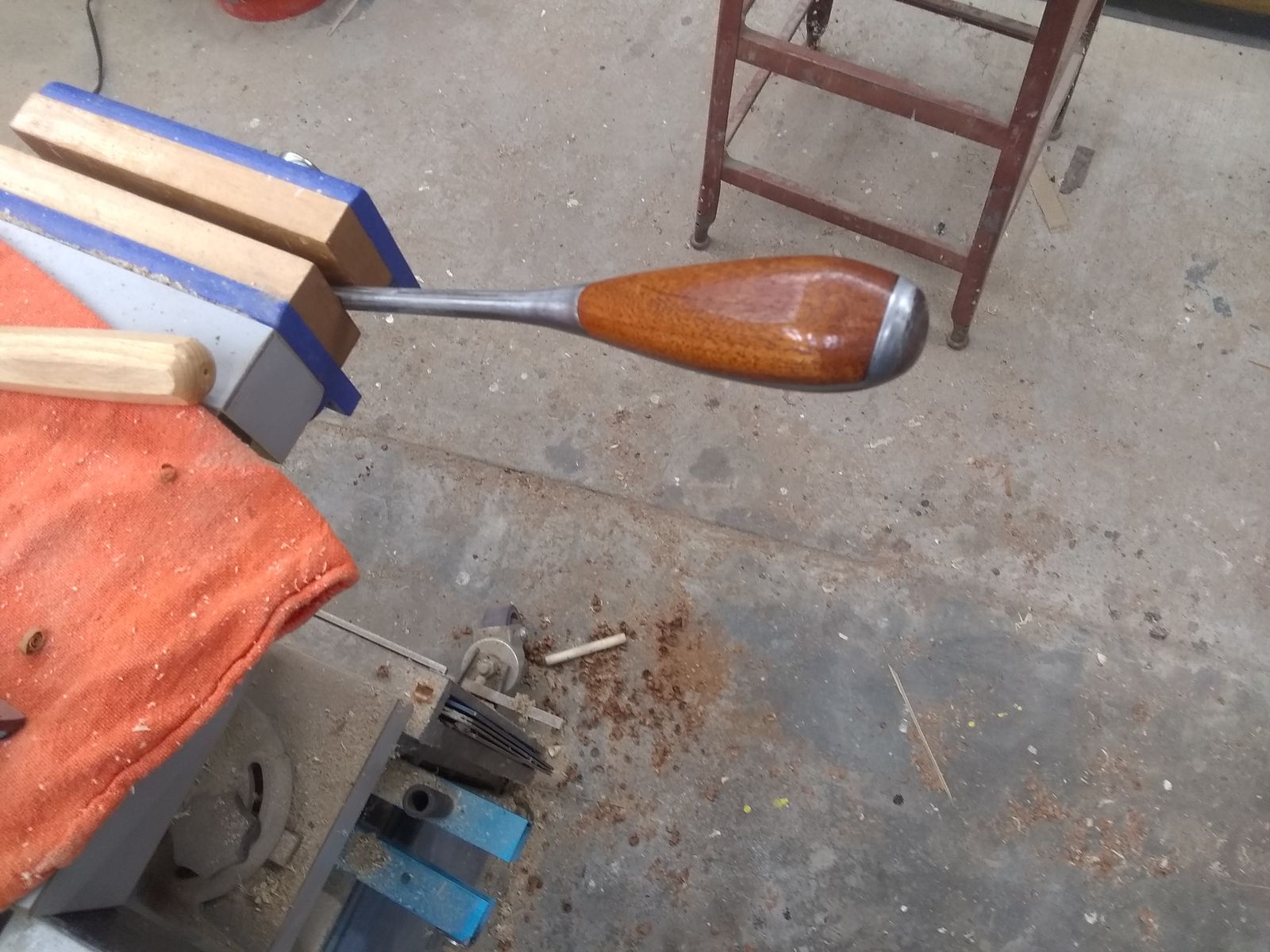

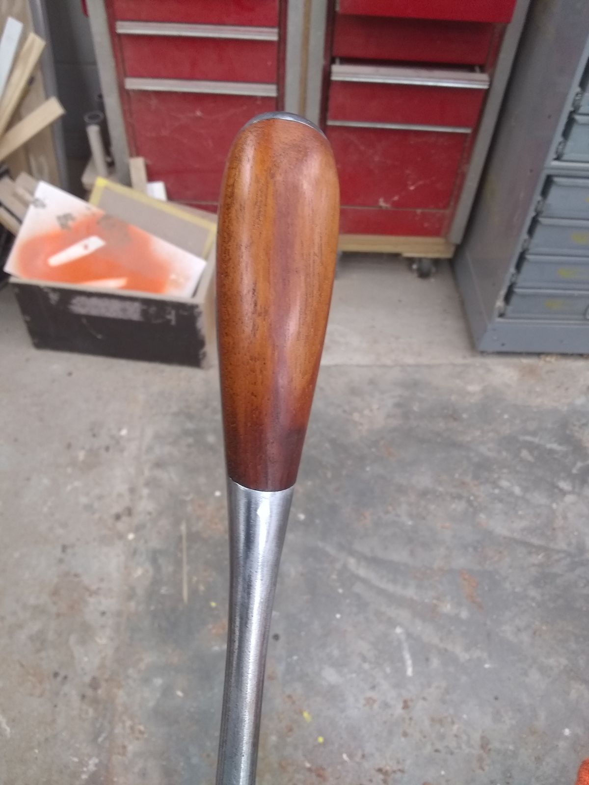

Well I went with using the tools I do have.  So I used my block plane to taper down the sides and give it some curve, then a carving chisel to finish the shape up and get close to the end and top.  Finally did detail work with a razor blade using it like a scraper for some touch up work.  Used lathe sanding grit and buffed that out then hit it with two coats of BLO.
Pretty satisfied with the results.  Really think this looks better having used chisels and a plane verses sanding it down.  Will give a couple more coats of BLO over next few days.
This is original scales:
Finished scales:
1239203809_Completed(1).jpg.6131ff7a2c73d675ce1ada20a839bfe4.jpg  1362088700_Completed(3).jpg.c6f08c292b4dc6cbb7fc13fd144bcb1a.jpg
Looks like a new one
I know, a little late, but......a piece of window pane glass can be used as a shaper/scraper.    I use one to fine tune the fit on hammer handles.   One can also cut a profile to the edge, to the shape you need.   If it does get "dull", easy enough to just cut a new one......
So sorry I couldn't get back as my Toshiba finally died.  I was also going to suggest some tool like a Dremel.  But, what you did looks perfect and as Gerald said, It looks new.
Pretty darn sweet Gunny.
Perfect! Looks fantastic.

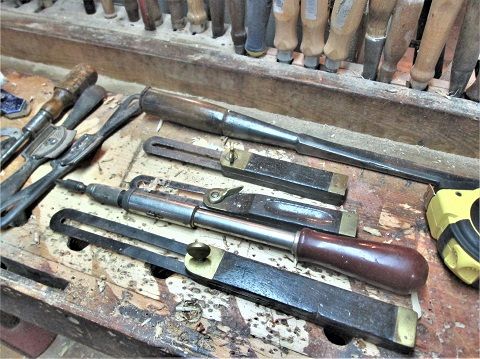

Lookee what I found today, while cleaning out the tool well on the bench..:JawDrop:
And...I know there is a 3rd one hiding somewhere in the shop...:WonderScratch:
There is an APEX tip holder, sitting in the end of a North Brothers #30 ( pre-Stanley) screwdriver..
And about a pound of very sharp screws...DAMHIKT:BangingHead:

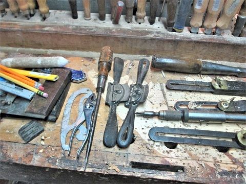

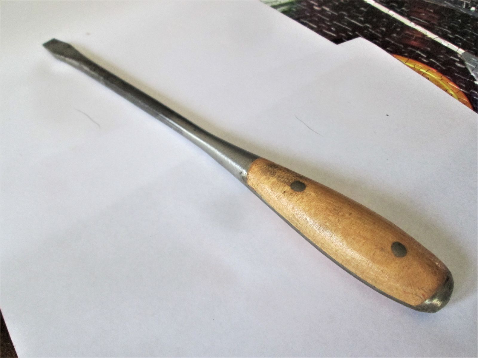

Just a photo or two...of what a "new" 11"  would look like..
Photos might be a hair big?   I have 2 almost new ones, and 2 very old, pre-Irwin ones....
