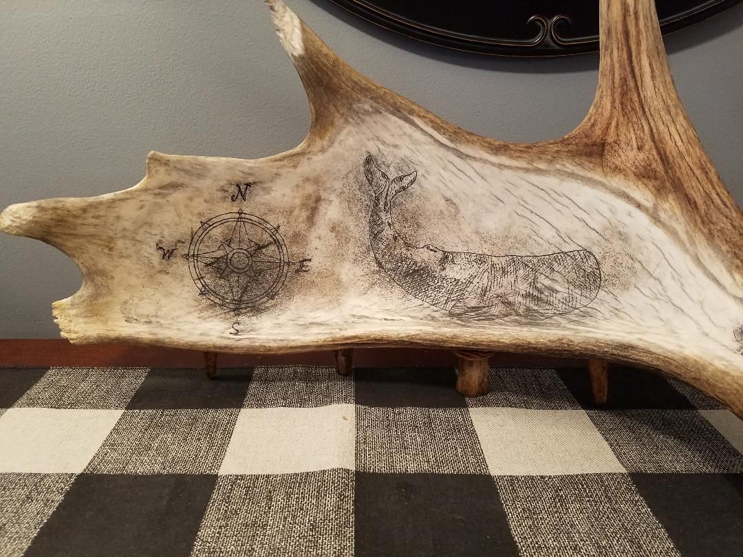

Did this several years ago. Scrimshaw compass rose and sperm whale on moose palm. Finally got around to getting some antler legs under it.
I like it.  How is that done?

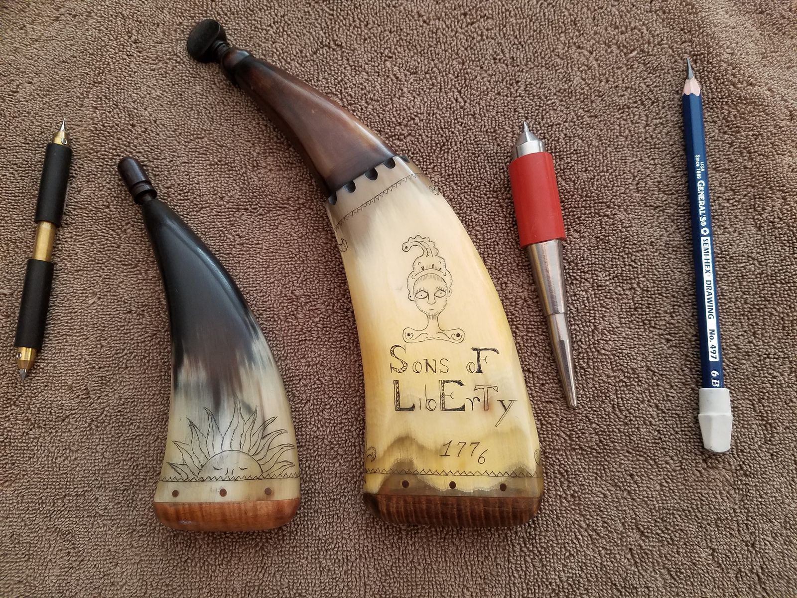

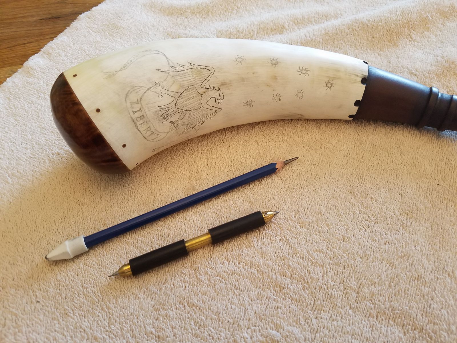

Sand down to a decent surface,...little steel wool doesn't hurt...a little waxing with johnson paste wax or other wax for seal( which I didn't do here,...that's why it looks a bit "muddy" but I was after an older vintage look) then sketch your image and use a scribe or bit of some kind to "scratch" your image,...then add india ink or whatever type of substance you want to darken your lines.
Moose antler is HARD. .I cheated a bit here and did some of the cutting with a micro motor foredom tool. All my powder horn or bone scrim is done all by hand with some scribes out of a tool and die shop in Illinois.

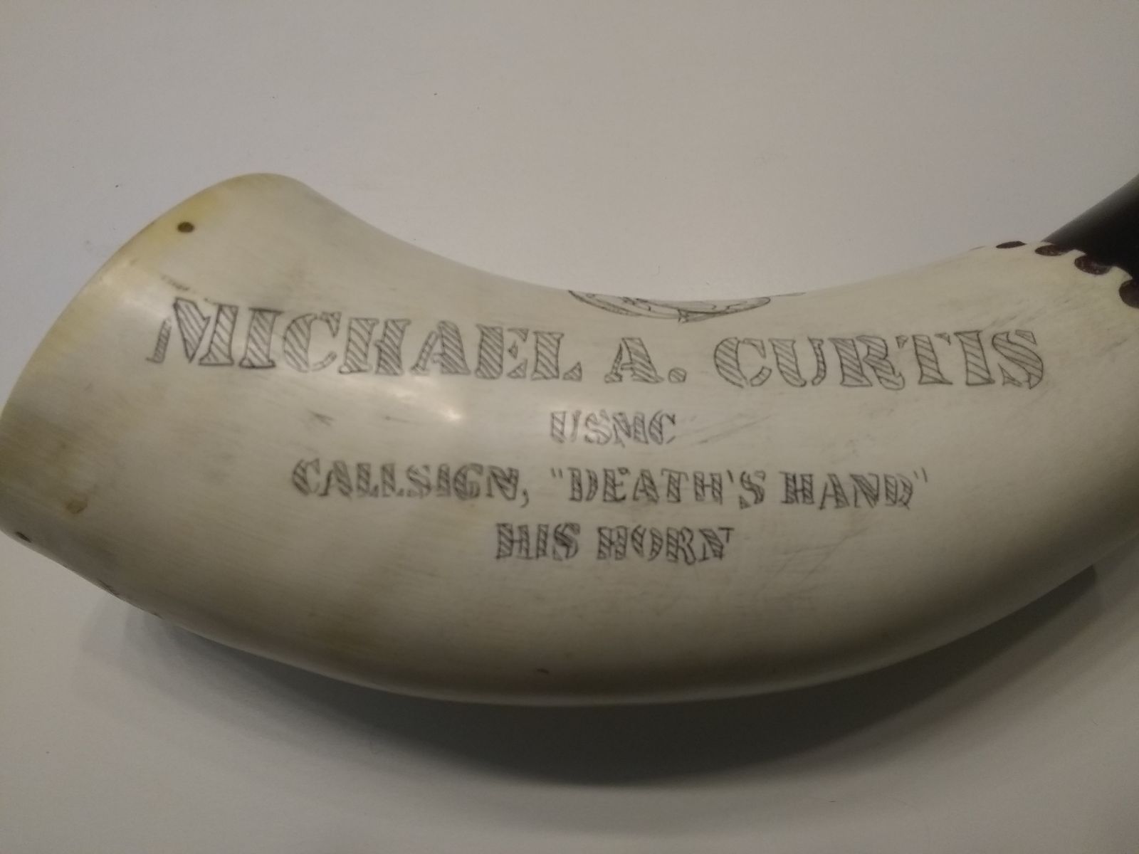

That is some great work.  When I 1st came home from Iraq a guy asked me to make him some handles for some chisels he used to do this kind of work.
This is what he made for me.
Nice! Thanks for posting.
