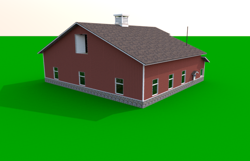

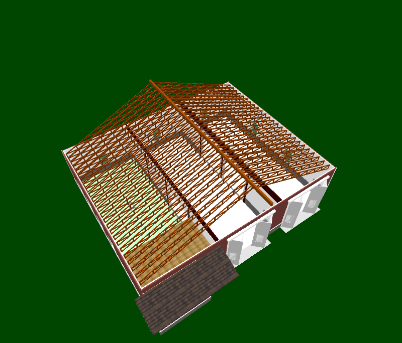

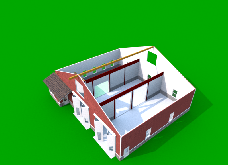

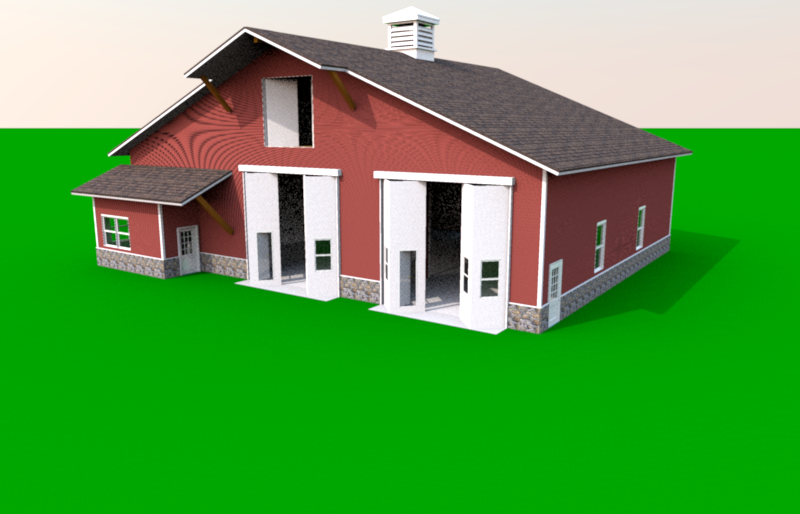

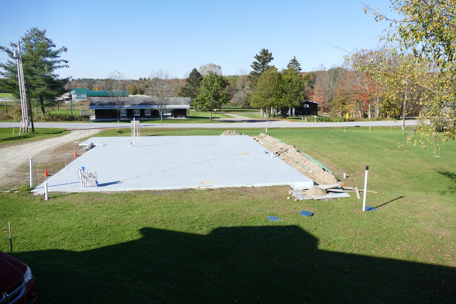

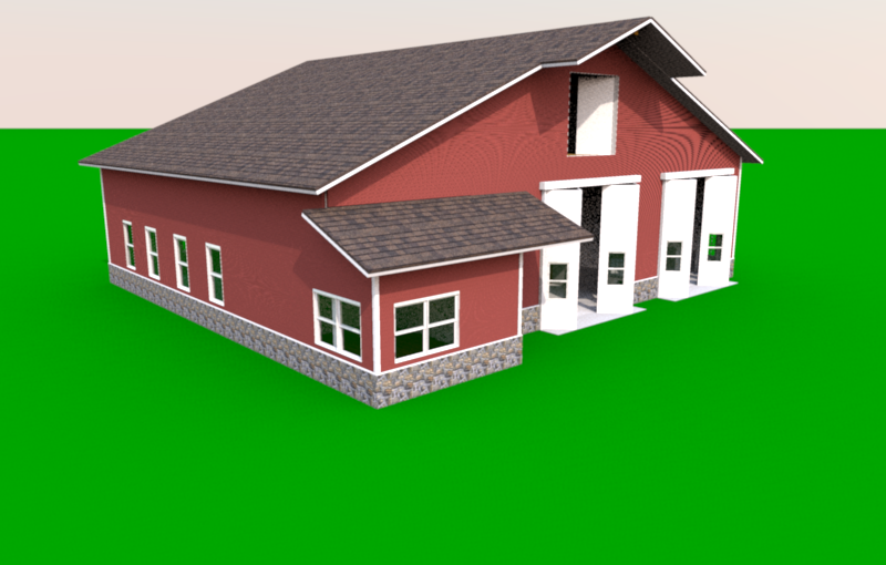

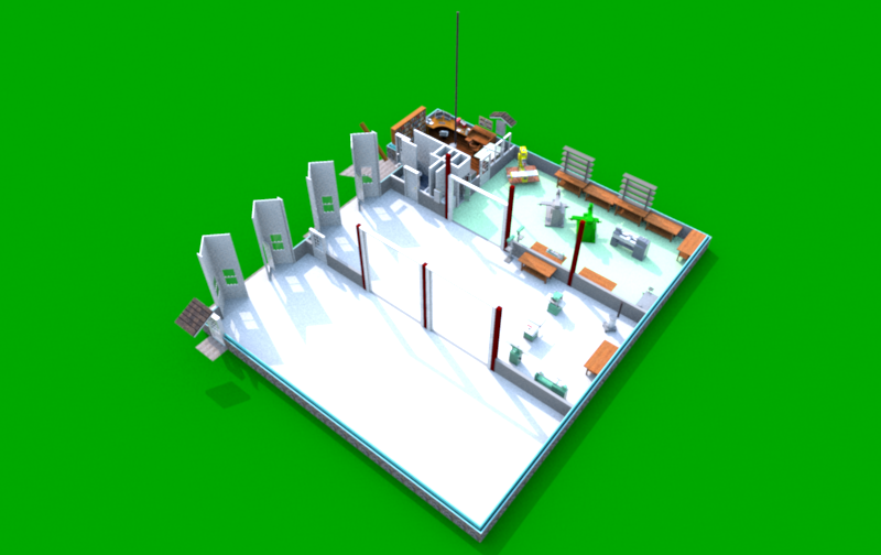

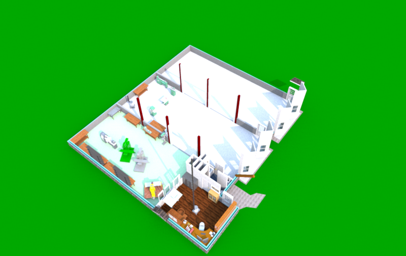

February 11, 20206 yr Author comment_218305 OK ... maybe I should start from scratch here. After building the house, I think I have made every mistake I could ... and the ones others made I had to repair (that is a long story ... even had to go back and double up the floor joists and replace two 12" LVL's with three 16" LVL's) So, that pad is floating (ok already a mistake ... I was talked into it by the concrete guy) ... it has a thickened edge (almost 16") ... it has a lot of rebar in it ... has cracks all over but has not moved. It is 64 x 52 plus the small just out ... door going into the office area. I am planning three bays .... each about 20 x 50. I need to be able to drive the RV into it .... so 16' walls ... 14 ft doors. One bay (the one at the end without the office) will not have garage style door. The office is in front (about ) and the area behind (about 36 x 20) is the metal working shop. The middle bay is for wood working ... or any other large project ... the end bay is storage for the RV and ??? The power panel is already it ... 400 amp service ... 200 went to the house .. 200 amp breaker already has conduit to it and comes up inside the slab. I already have a water line and a natural gas line run out to the slab. My thinking is with a typical roof, I will have about 1000 sq ft of usable storage above the center bay. I was planning typical 2 x 6 construction. Here is where I begin to "cheat" The budget is tight. Rather than sheet the house then put on siding, I was thinking of just the T1-11 right on the studs ( well over tyvek). I am looking at something like Roseburg DuraTemp. 7/16" ... $34 a sheet from HD. Comes preprimed. I can use standard fiberglass insulation in the walls .... Cover the inside with "real" ... upainted wood .. T1-11 .... very durable and give an old time workshop feel. Attached are some of my parliamentary drawings. I dropped the ideal of stamped stone on the bottom (again, cost) ... I will probably just buy doors rather than make my own. Maybe drop the large overhang in the front. Also no posts or LVL's inside. I will be putting up a 2 x 6 wall separating the bays so don't need them. I figure I have two months to get my butt in gear. I need to be ready to go when the snow clears. For the past two summers I got distracted (twice by work .. once I ended up in the hospital) ... I got to get this up. I have a complete machine shop sitting in a tractor trailer beside the house. I am completely open at this point in time ... any and all ideas welcome .... just remember, money is tight Report

February 12, 20206 yr comment_218327 I will also vote for white on walls. It really enhances the shop experience. You have probably considered this but in putting electrical in for the shop areas outlets every 6 to 8 feet with banked outlets . Use conduit and also put in outlets or empty boxes at bench height. You will need air so go ahead and plumb that in too and will save lots of headaches getting it where you need it. I might have missed it but what is the ceiling choice? Report
February 12, 20206 yr Author comment_218329 I am not sure of the ceiling ... it is high .. 16 ft ... I will put about 24" of insulation in it. Maybe thin plywood or even hardboard ... just something to seal it up and hold up the insulation. Yes, I did that in my last shop .... conduit on the walls and plugs everywhere. Definitely air. I worked for a compressor shop once and picked up a good cast iron pressure lubricated two stage. Report
