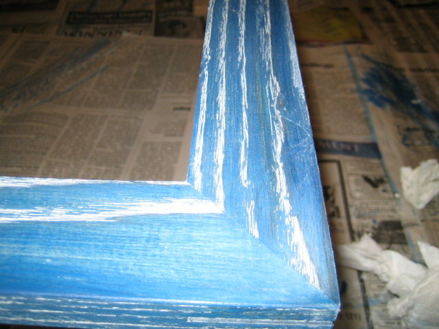

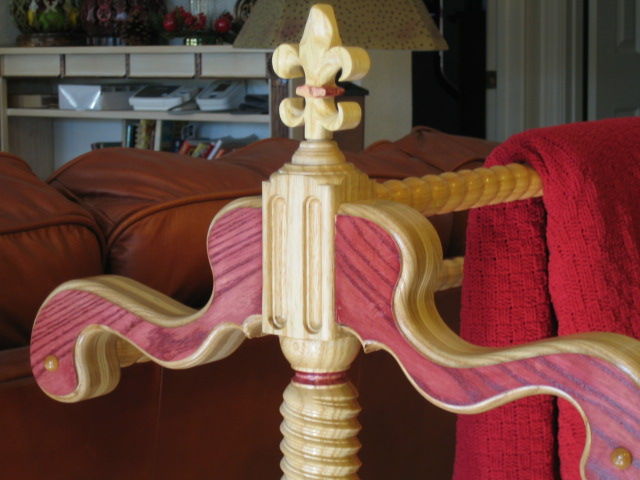

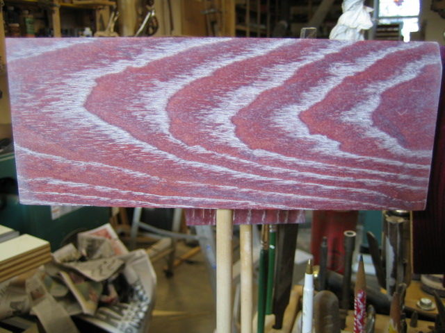

January 30, 20206 yr Popular Post comment_217067 Gerald if you color the grain a different color different than the base coat like this or this or this then yes after your base coat dries I spray the base coat with a clear coat, let dry then rub on what will be a different color in the grain and before the grain coat sets up I use my hands first and rub off most of the grain color drying my hands often and keep rubbing till all the grain coat if off of the base coat, let dry then clear coat it all with a few clear coats... Since I use lacquer mostly the first coat base coat is lacquer and let dry the I switch to a water base color for what will the in the grain...If you are using a good open grain wood like oak, walnut, or ash then you can leave lots of actual wood color showing if your base coat is not solid paint like on this last sample... Its tricky when using lacquer with water base colors in between coats of lacquer so make sure the water base stuff if dry dry before the final coats of clear lacquer goes on … Now, if you were asking a different question just ignore what I typed and pretend it didn't happen... On the coat rack the grain under the wine colored end pieces I wanted the effect of veneer having been added to the ends was the reason I filled the grain with a dark color before I sprayed every thing with clear lacquer. Report
