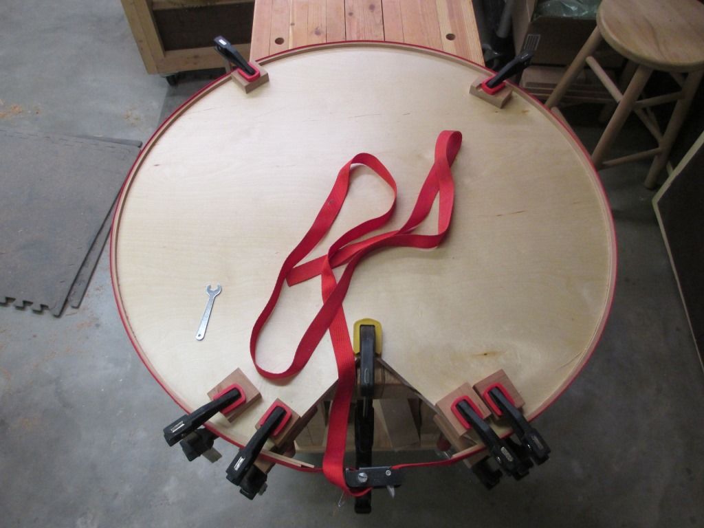

So far I managed to get the base top drawer frames and top started. I tried three times with a strap clamp and it slipped off every time, the clamp method sucks too but at least I got layer on. Two more to go.

You are correct, using strap clamps can be difficult.  I elevated my work piece off of my workbench so that I could use F-clamps.  The f-clamps held the wood band and the strap in place prior to tightening the strap.  It always helps to have a 2nd set of hands for this operation.   Danl

I do not have a picture but try this . Put a F style clamp on the good sides with just a little space between the bar and the strip. Use wedges to drive in between the bar and strip to get good bond. You can do these as close together as you want to.
Here is a pic of my approach.   Danl1651721404_lazysusan-4.jpg.46c682bcc3505f86133e89c70d2decd2.jpg
Guys, thanks for the advice and encouragement. Dan, I rebuild my strap clamp and got rid of all the hooks and it worked way better this time. Not much time in the shop this week so just one more layer added to the banding. Am planning to use a router jig to trim all three bands to the same level. I see some people using a dovetail bit for this does this ease into the cut more gently to help with blowout?spacer.png

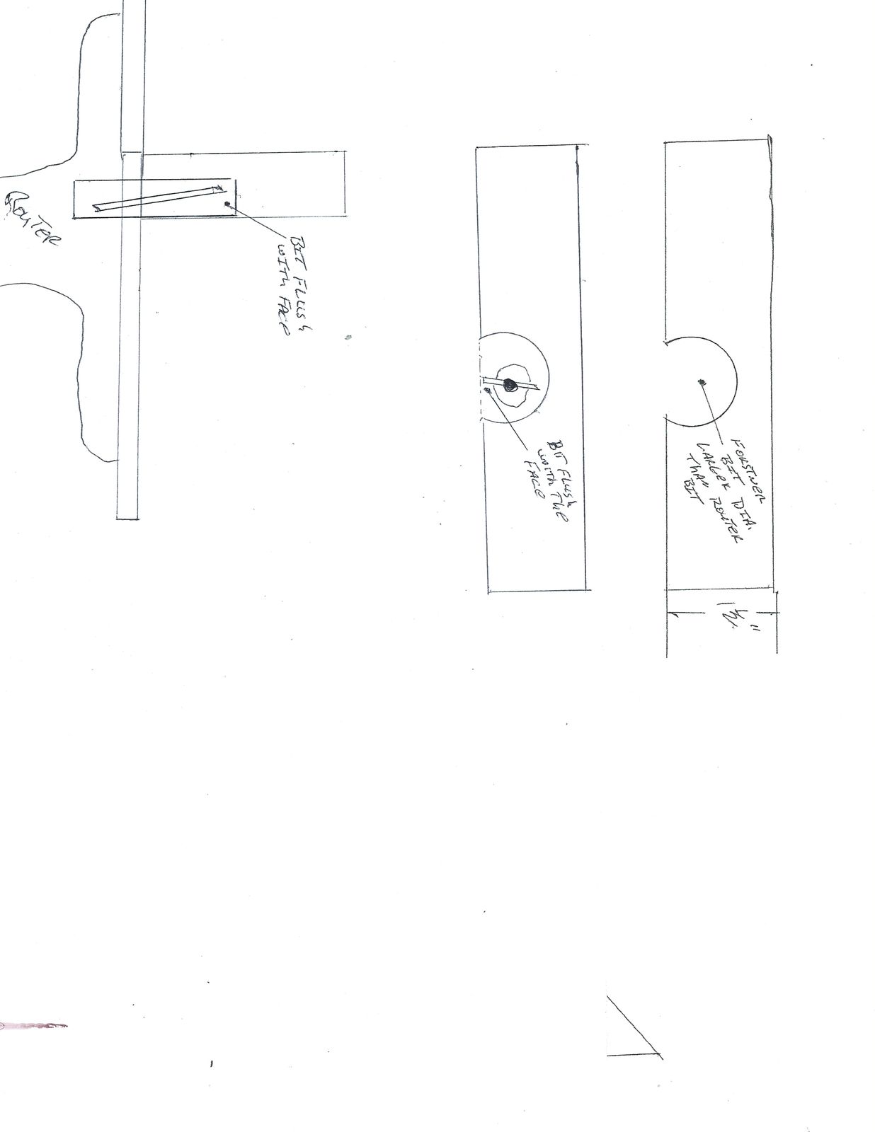

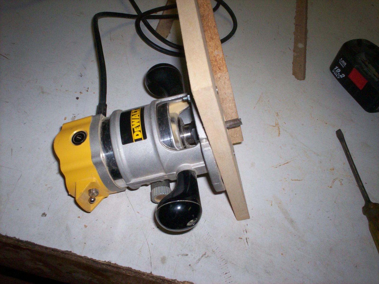

 I would add a board 90 digress to a straight or flush trim bit and attach it to your router base. Drill a hole near the edge of the board slightly larger than the bit, basically a flush trim fence.
With the router in the horizontal position ease the bit into the wood till the fence sets flat to the table top then hold down the fence and follow the top with the router.

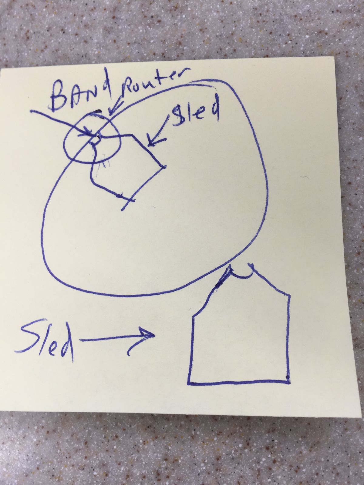

 I see were using a dovetail bit could reduce blow out. I would worry that moving too fast could cause the bit to act like a chisel. Maybe keeping the bit slightly off center to the outside edge would solve this.
Here is an idea. Excuse my lousy drawing . Make. A sled like Duck showed (think of it as a router table upside down) but it comes to a point. This point will ride against the edge and and with the router bit set correctly ( that is less height than the sled) you can then make the cut.C872E56D-718F-4B1E-A056-3A2410BDBB12.jpeg.5433ae2b4bb8bbaffa1b8f9d1911a687.jpeg
Thanks guys, Gerald what type of bit would "you" use? I have a good collection just don't want to tear this thing up after spending so much time on it.
with Gerald's jig,  I'd use a mortise clean out bit like this.

Any straight bit should work as Gene showed it should be wider than the strips so that it is all cut across in one pass. If the cut is deeper than 1/8 I would so this in several passes. Note if you enter this cut too fast you could blow out the outside.
Another thought on this cut is to take it easy as cutting the edge of a thin surface is tricky. Try to practice by setting up a trial blank with straight trim to get the feel of what this cut will do and how much you can take at one pass.
And, enter from the outside. Less chance of a blow out.

This definitely what I was planning, and very fine cuts, if I go around 5 times to cut an 1/8 I'm ok with that.

Thanks, while gluing on the last layer I will make up a sample and do some practicing.
