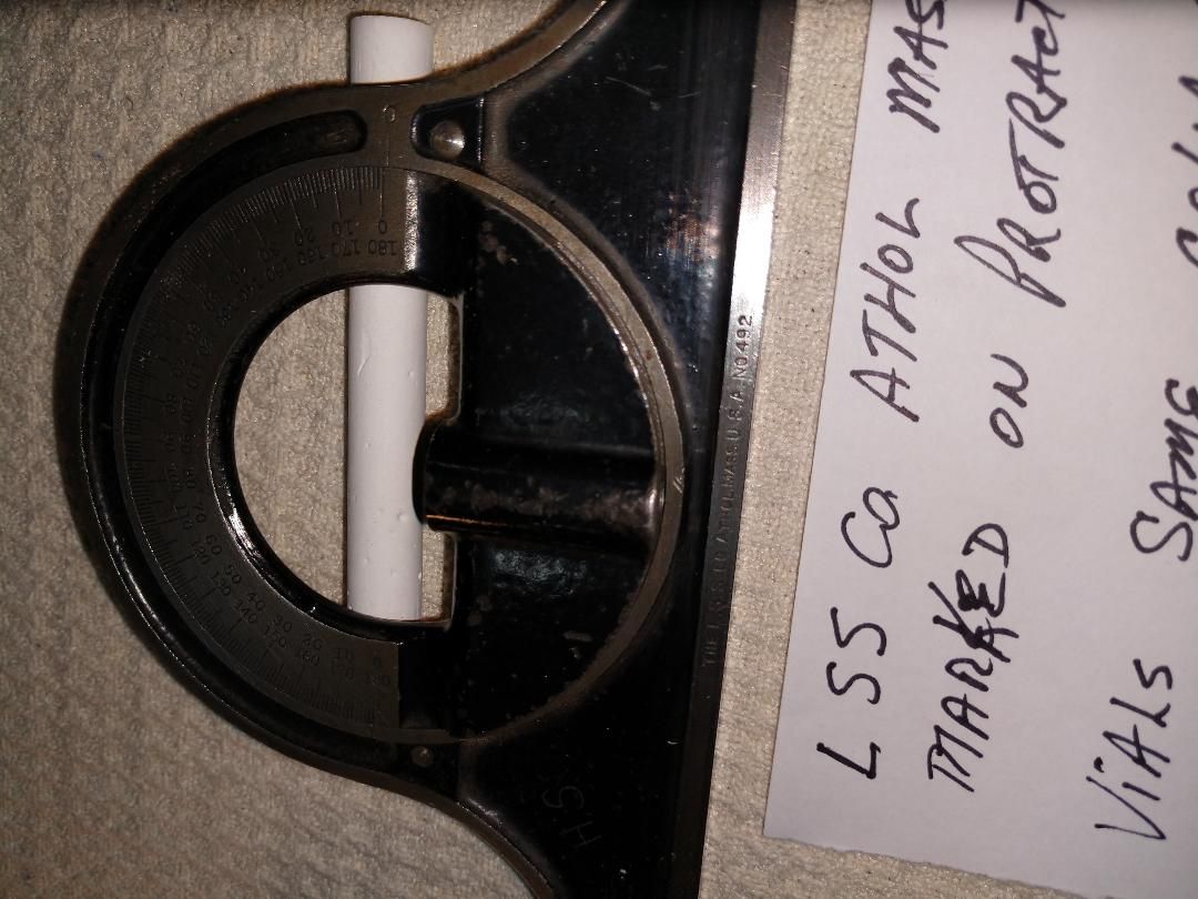

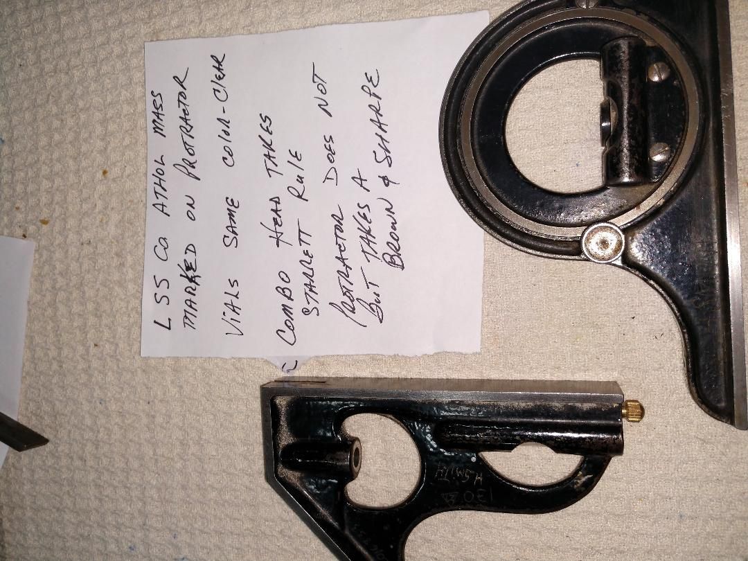

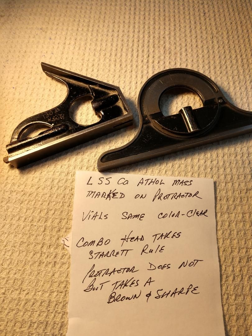

Ok lets see if I can get the pics in.

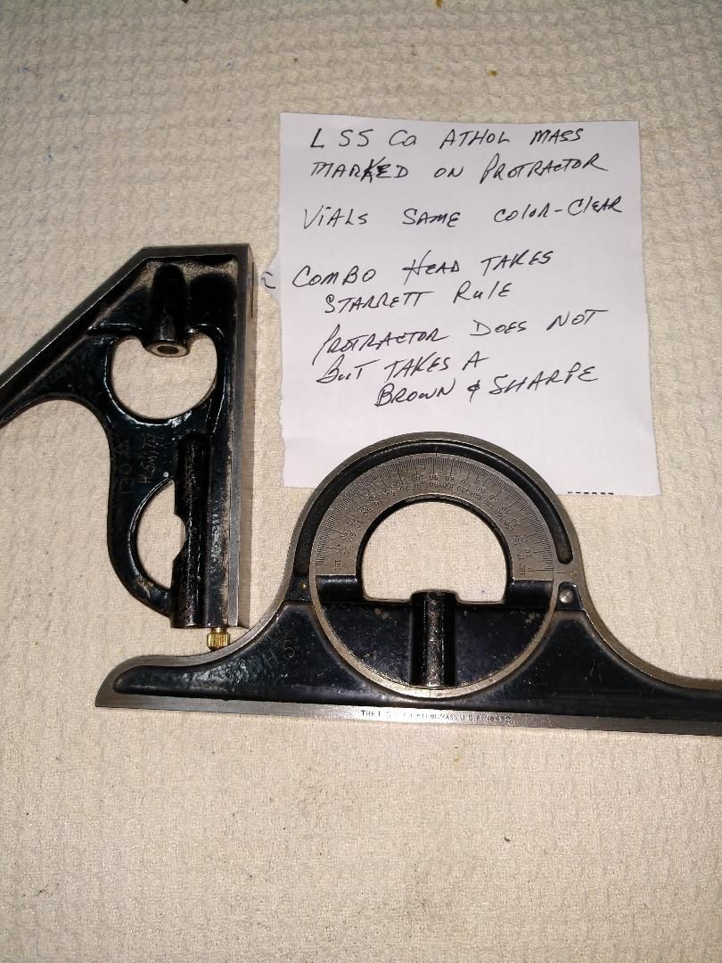

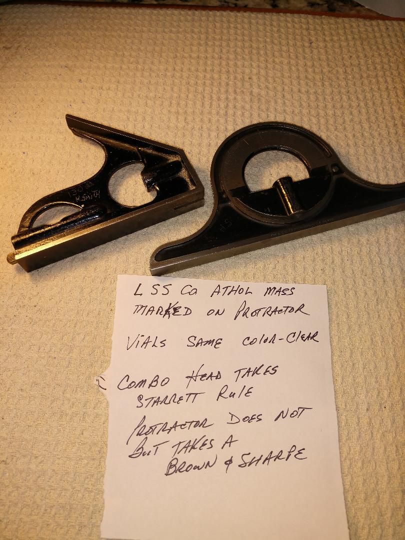

These heads appear to be Starrett. The protractor has LSS Co on the edge. The finish appears to be the same Japanning (sp) finish.
Interesting though the protractor head does not accept a Starrett rule but will take a Brown & Sharpe rule. The Starrett rule is too thick.
More to follow

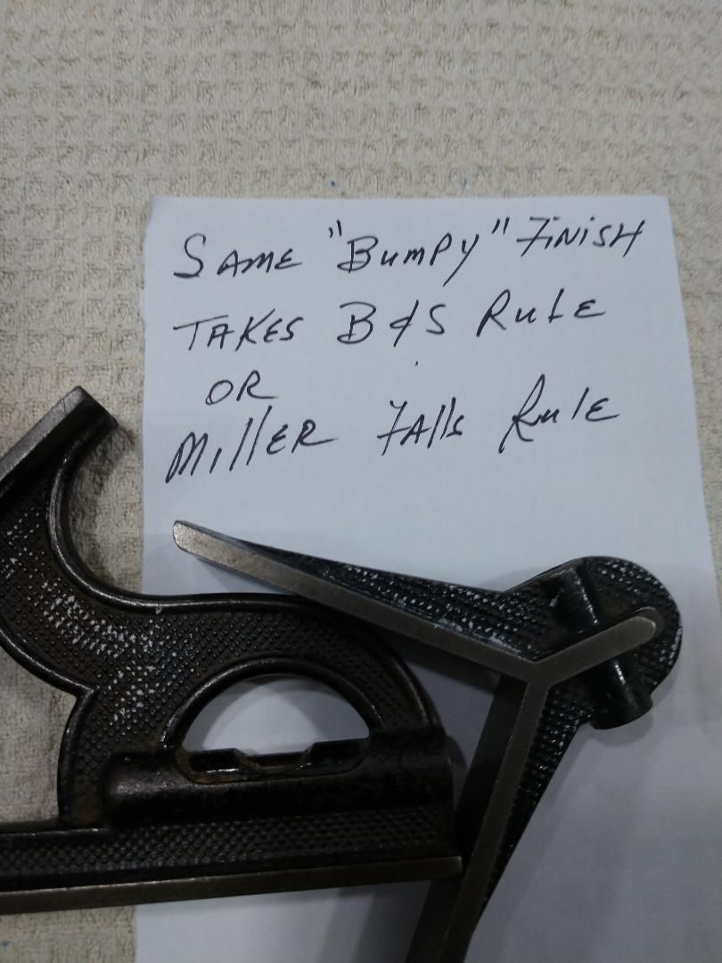

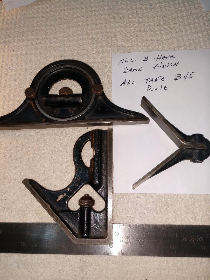

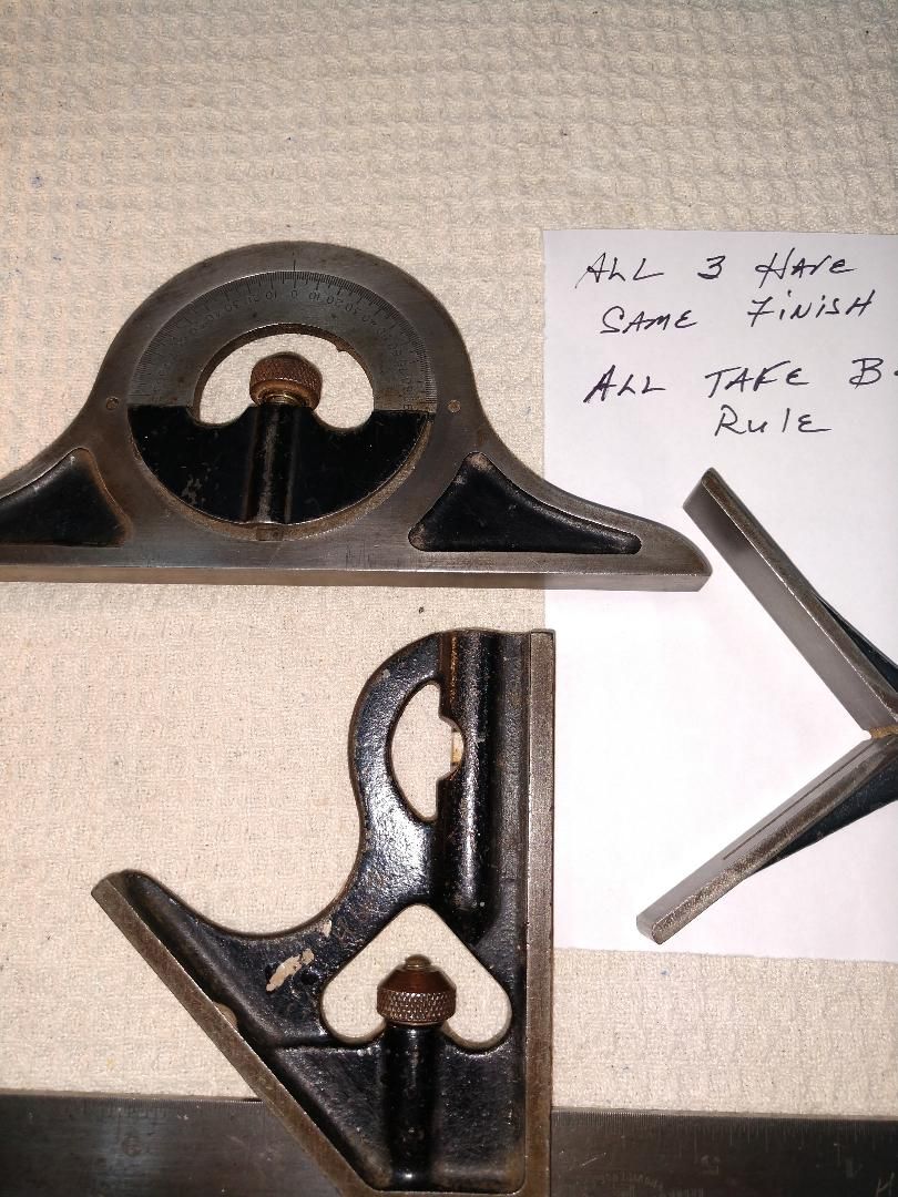

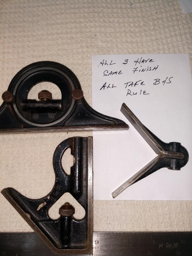

Part 2
these 3 heads take a Brown & Sharpe rule. All have the same finish. Possible B&S??

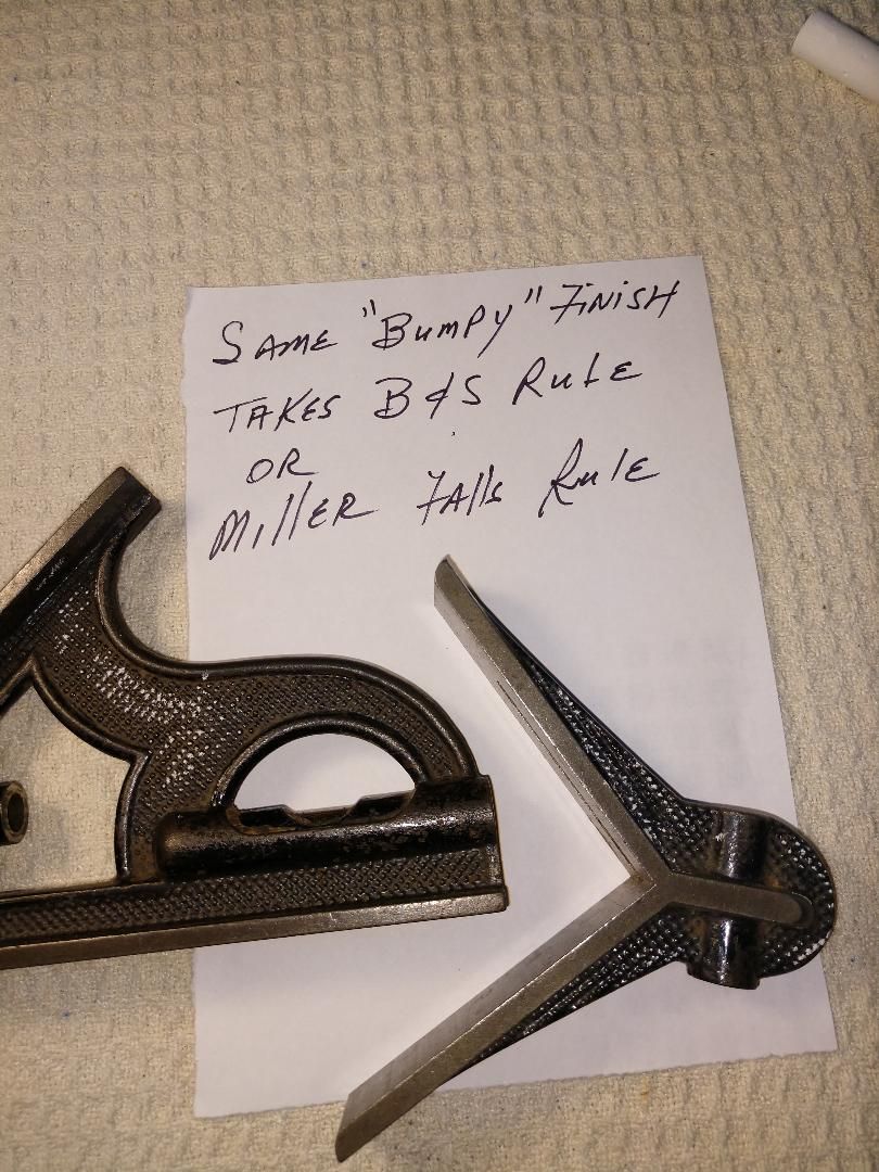

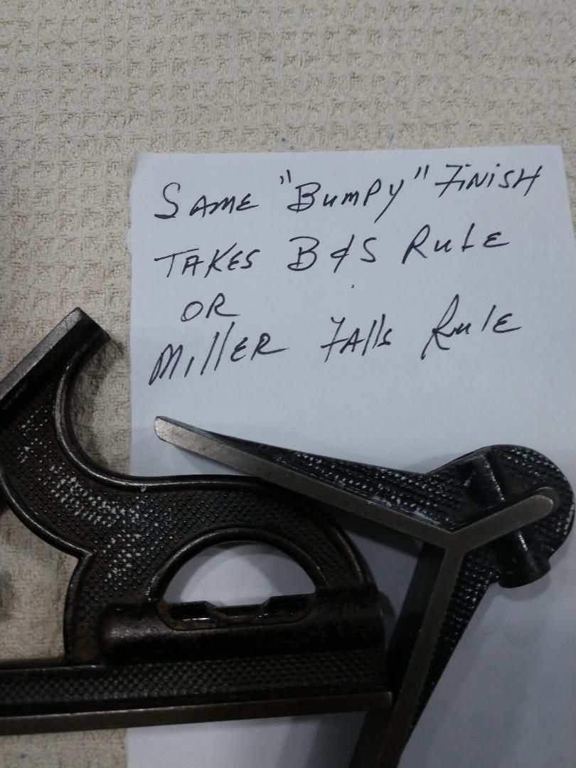

Part 3
All have a "bumpy" finish.   The white is chalk to try to bring out the bumps. All take Brown & Sharpe rule.

The "bumpy" finish " is Starrett. I have one just like it. Starrett makes many types of rules and squares and the fit is not universal . some of the rules I have seem to be thinner although I have not tried to measure that.
