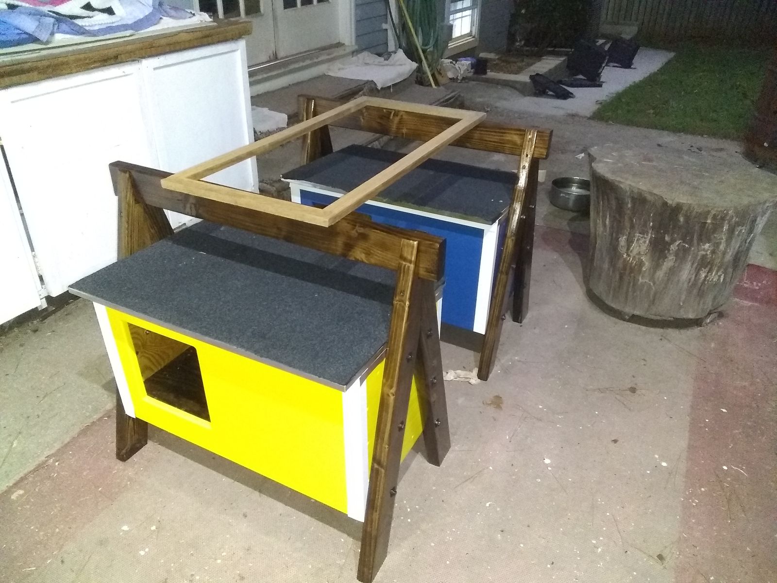

Mostly I work around the issue.  Built 3 Cat house / sawhorses that stay outside shop ready for use all the time.  Cut the larger plywood pieces down to a manageable size in the shop.  Just have to work with what I have.  :D  The bench I built on that side is the same height and I do use it for the occasional long board.
