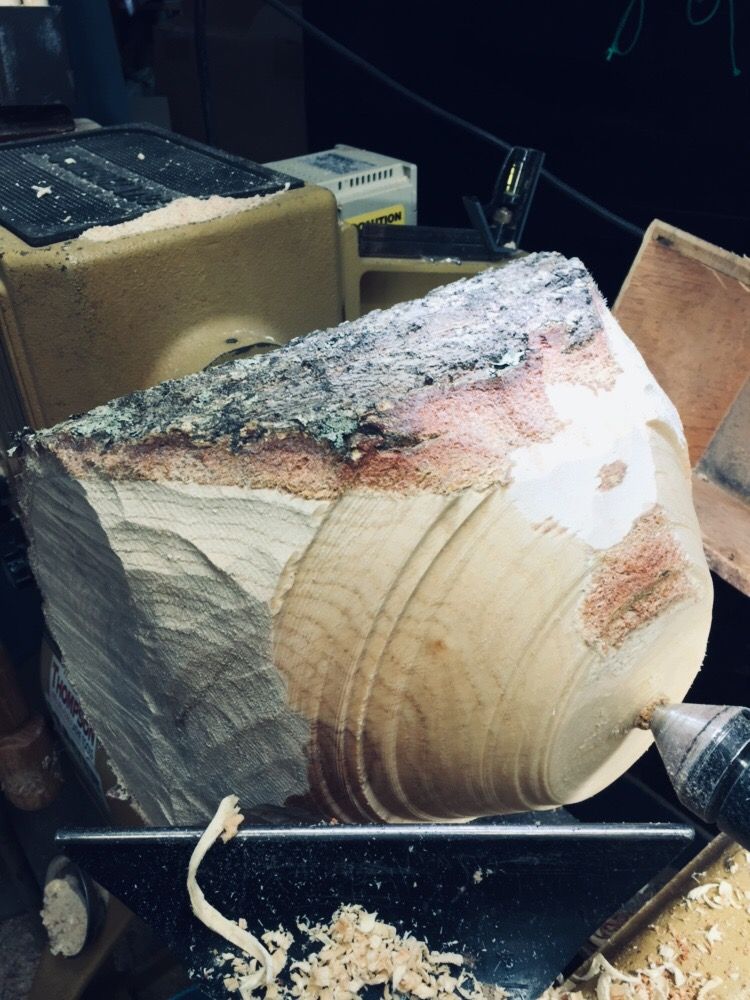

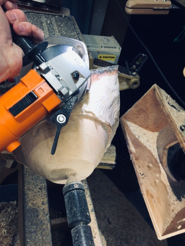

Gerald Posted January 10, 2020 Report Posted January 10, 2020 (edited) Ok this is the story. My log is 10 plus inches diameter. So I cut the log and used Arbortech to make flats on both sides. Used my Elio Drive , which is kinda like a faceplate on a MT2 . After mounting I used the Arbortech to round the corners somewhat and get a better balance. Turning the outside shape when well but was a long process. Now to the tragedy. Starting the hollowing was normal, use parting tool to cut bark and make grove for thickness of bowl. On hollowing got a catch and bowl jumped off lathe but only knocked off a small piece which I found and saved. Put back in chuck and continued but that happens again and this time knocked off both wings. That was it and I turned it into a hollowform. Pics in this spot in 5 minutes sorry I was hacked did not get the finial mess nor new bowl Edited January 10, 2020 by Gerald Gunny, FlGatorwood, p_toad and 1 other 1 3 Quote
Gunny Posted January 10, 2020 Report Posted January 10, 2020 1 hour ago, Gerald said: Put back in chuck and continued but that happens again and this time knocked off both wings. Well maybe a mission failure but anything you don't have to go to the hospital for is good. p_toad, Cal and Gerald 1 2 Quote
