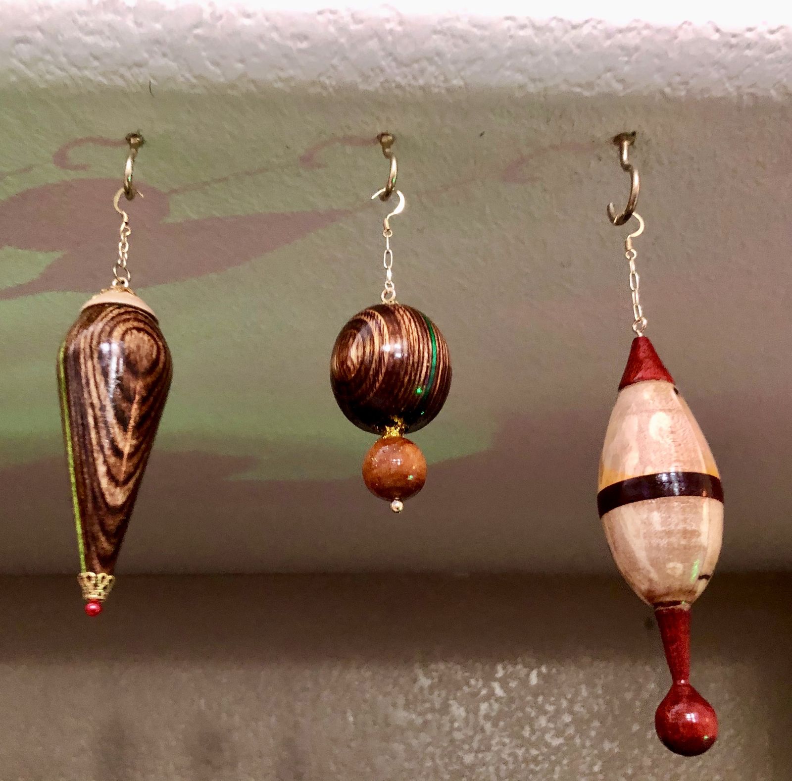

3 more ornaments
 3 more ornaments. 2 are made of colored ply that I cut and reglued. Also used the new finish with UV light drying. I like that finish a lot. I use a small brush to apply and then after 3 minutes of UV light on all surfaces, I then use 400 sandpaper until it is as I want it and apply clear spray. I'm sure you can see some areas where I am still learning(still playing)  The one on the right has multi colors because it is a spalted maple piece.

A question of curiosity.  Does the plywood chip or is it made from really good wood?
 That was my first thought too. I use carbide tools and was surprised at how well the wood held together. I do resort to conventional sharp tools when I see an area that may chip out. None has done it so far, at least done it where I can't recut and fix. Two things that can cause a problem, the dye is water soluble and sanding bleed can discolor. I try workarounds to hide it.
