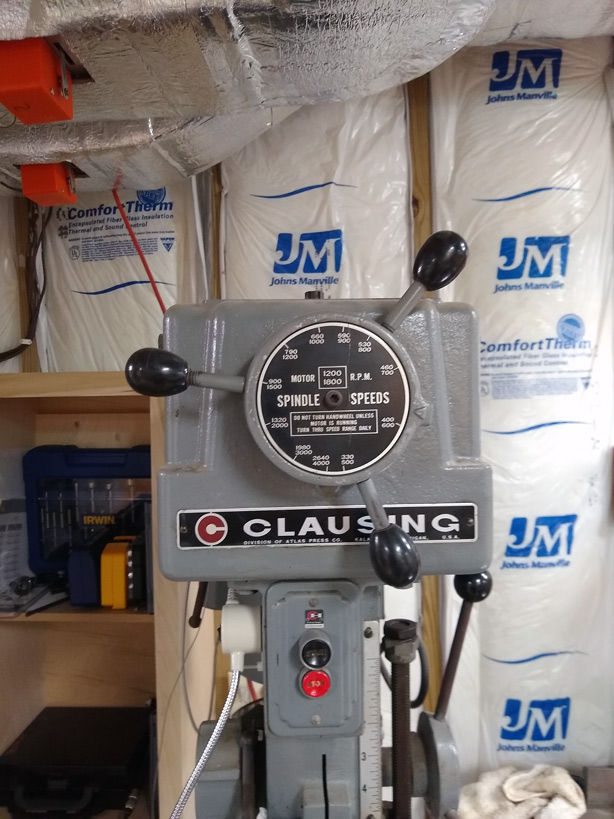

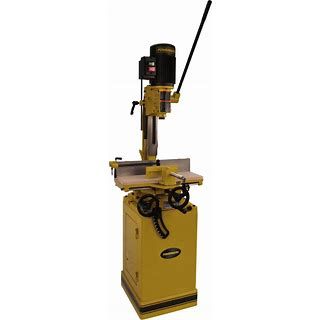

sreilly24590 Posted December 1, 2019 Author Report Posted December 1, 2019 Thanks John. My thoughts are that for larger projects the chisels would be the way to go as they would be seldom needed and no need to invest to cover for that. I have the better half as a bookkeeper and getting approval isn't approached lightly although she's easy to work with. So far from what I've seen online I really like the Powermatic 719T freestanding model. It allows upto a 1" hollow chisel bit and centers at 4" from fence so that will take me up to 8" width if I'm looking at this right. I also like the ability to securely hold the work versus the benchtop models and the extra HP doesn't hurt. Larry I've looked at those and again securing the work piece is a major concern. My old Clausan DP is 3/4 HP but lacks the geared raiser for the table which makes it a real pia to make the adjustments. I've also considered the attachment for my Shopsmith Mark 7 but prefer to keep it setup as a dedicated lathe if possible. The attachment for the Mark 7 is $183 but only goes up to 1/2" and again securing the wood is an issue as I see it. I might feel differently if I had seen one of these used in person but that hasn't been possible yet. At 65 I'm focused a good deal more on the safety aspect not that it's ever been a major concern but these days the grip isn't what it was 30 years ago and I seem to bleed a lot easier....... HARO50, p_toad and John Morris 3 Quote
BillyJack Posted December 1, 2019 Report Posted December 1, 2019 The company I worked for bought the powermatic floor model mortiser a few years ago to put a 1"square in a bar stool. Bought several expensive chisels after an hour of trying we finally broke the handle. Sent the unit back to Woodcraft fir full refund... Be careful when pushing tooling to its limits.. p_toad, Gunny and HARO50 3 Quote

Smallpatch Posted December 1, 2019 Report Posted December 1, 2019 The longer the handle the better you will like it. I have a Powermatic floor model which has a longer handle than the table model...….. And keep the bits sharp..... p_toad 1 Quote
BillyJack Posted December 1, 2019 Report Posted December 1, 2019 This was the floor model p_toad 1 Quote

sreilly24590 Posted December 1, 2019 Author Report Posted December 1, 2019 35 minutes ago, HARO50 said: My son recently got a bench-top mortiser for building railings for his new house, so I have SOME experience with them. This was a replacement for a smaller model, and has the ability to cut angled mortises. One thing in particular... get one with a sliding table! Nothing is more frustrating than having to loosen, move, and re-clamp seven or eight times to cut a 3" or so mortise! John Agree with you on that John and that's why I like the Powermatic 719T. It has the sliding table and able to do angled mortises along with the clamping ability. HARO50 1 Quote
Gunny Posted December 1, 2019 Report Posted December 1, 2019 6 minutes ago, sreilly24590 said: Powermatic 719T. If I did a lot of them yeah I am good with getting one. BUT, $1220 for occasional use......hmmm. NO. HARO50 1 Quote
