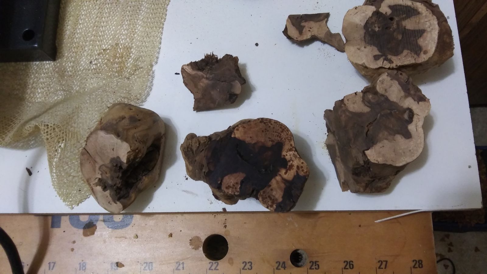

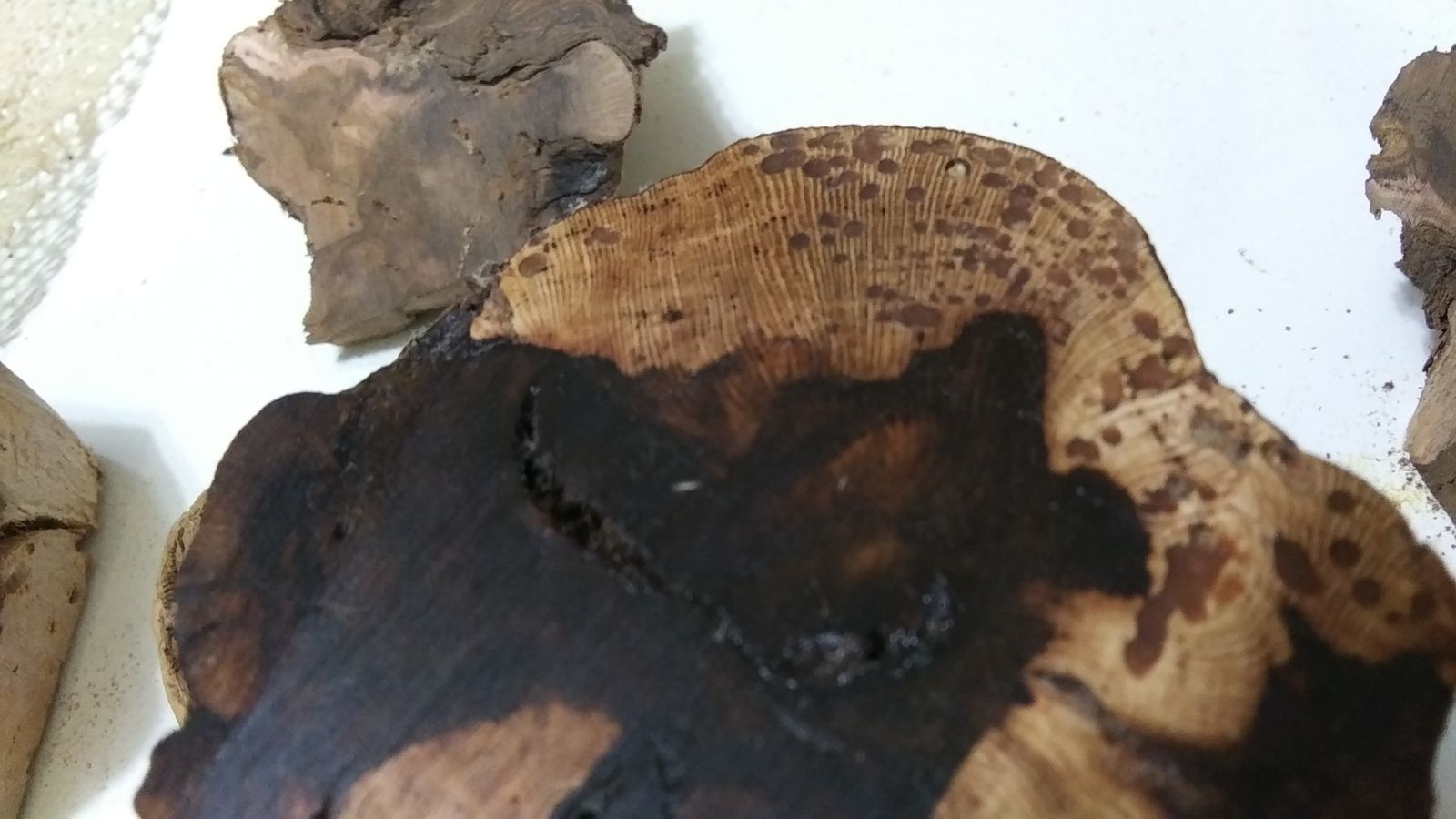

November 18, 20196 yr Author comment_209164 So I bought a bandsaw (first one) setup and working well. This is so much more controllable for what I want to do I'm using a 1/4 wide 14 tpi blade. Here are a couple of pics of the manzanita root. The closeup has been wiped with oil to show the grain. Report
