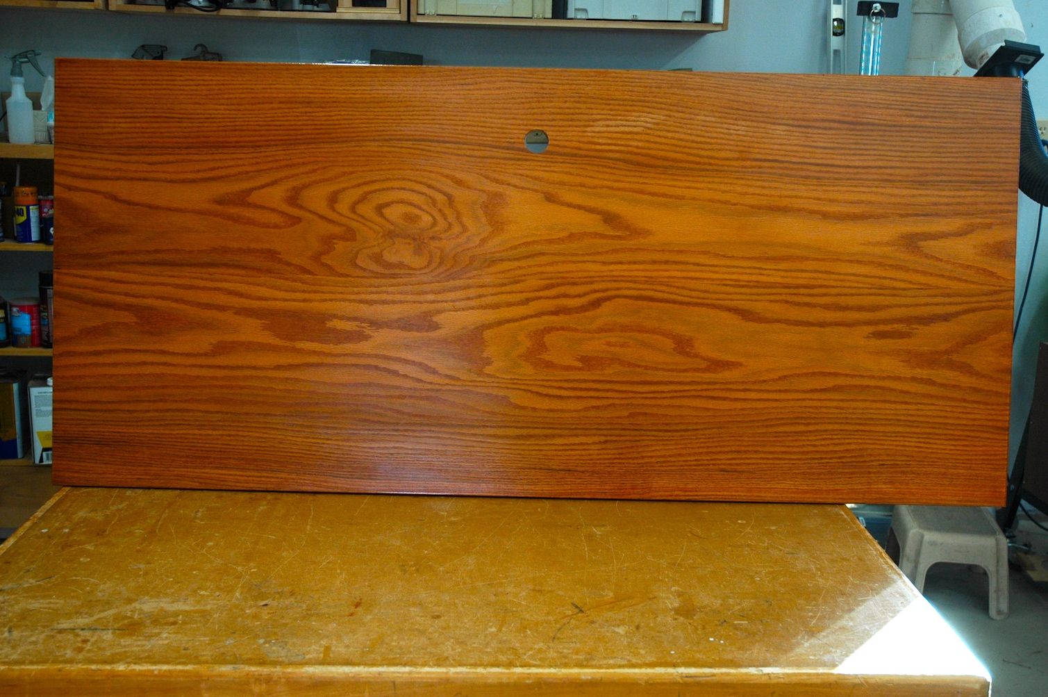

November 10, 20197 yr comment_208278 I'm still finishing an A&C style desk. I have several coats of gloss varnish on it, smoothed it out and then wiped on a coat of semi-gloss. Was looking good, then decided to apply one more wipe on coat to the top. I picked up the container with my semi-gloss wiping varnish and lathered on one more coat. Problem was I didn't think it being semi gloss, so I didn't stir it up. I also used all that was in the container. So what happened was that the flatters were all in the last few swipes I made, and once the varnish started drying I saw what I did. There are globs of white material at each end of the top, where the concentrated flatters piled up. You couldn't see this when the varnish was still wet, it had to be dried somewhat (apparently) for the globs to be visible. Uuuugh, now I have some cleaning up to do, and then recoat. Moral of the story...don't go asleep (mentally) when in the shop; or anywhere else besides the couch for that matter. Report

November 11, 20197 yr Popular Post comment_208299 Should clean up with some sanding with P400 sandpaper and Scotch-Brite pads and a lot of work. Sorry about your bad luck, but bet you won't forget to do this again. Report

November 11, 20197 yr Author Popular Post comment_208386 Well, after some work with some sandpaper and Scorch Brite pads, I managed to get things cleaned up. The magnitude of my screw up was worse than I though. I had not only piled the flatters into globs, but because I didn't stir the varnish, the first few swipes dried to a nice gloss. So after I got things worked out the entire top got one more (I hope final) coat of semi gloss. Report

November 16, 20197 yr Author Popular Post comment_208962 Tired of doing updates, really wished I hadn't screwed this up. But I able to get the surface cleaned up this morning. It's not perfect, I removed some of the stain (visible spot next to the cable hole, and other less visible) but I think I've got it as good as it will be. Man, the lessons of this episode will stay with me a long time ( I hope). The pic actually looks better than it does, but since this is my personal basement desk it's what I got. Report
