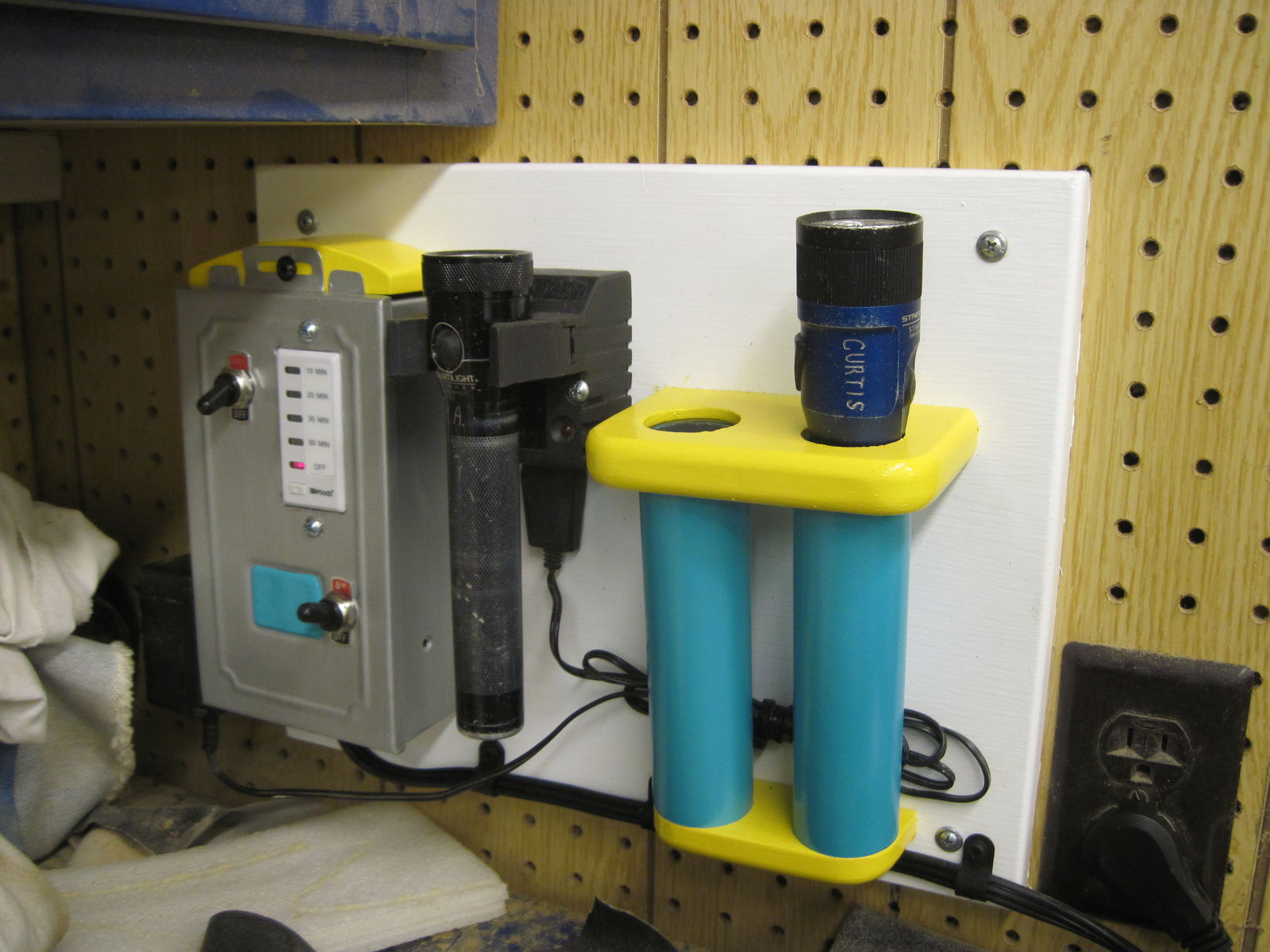

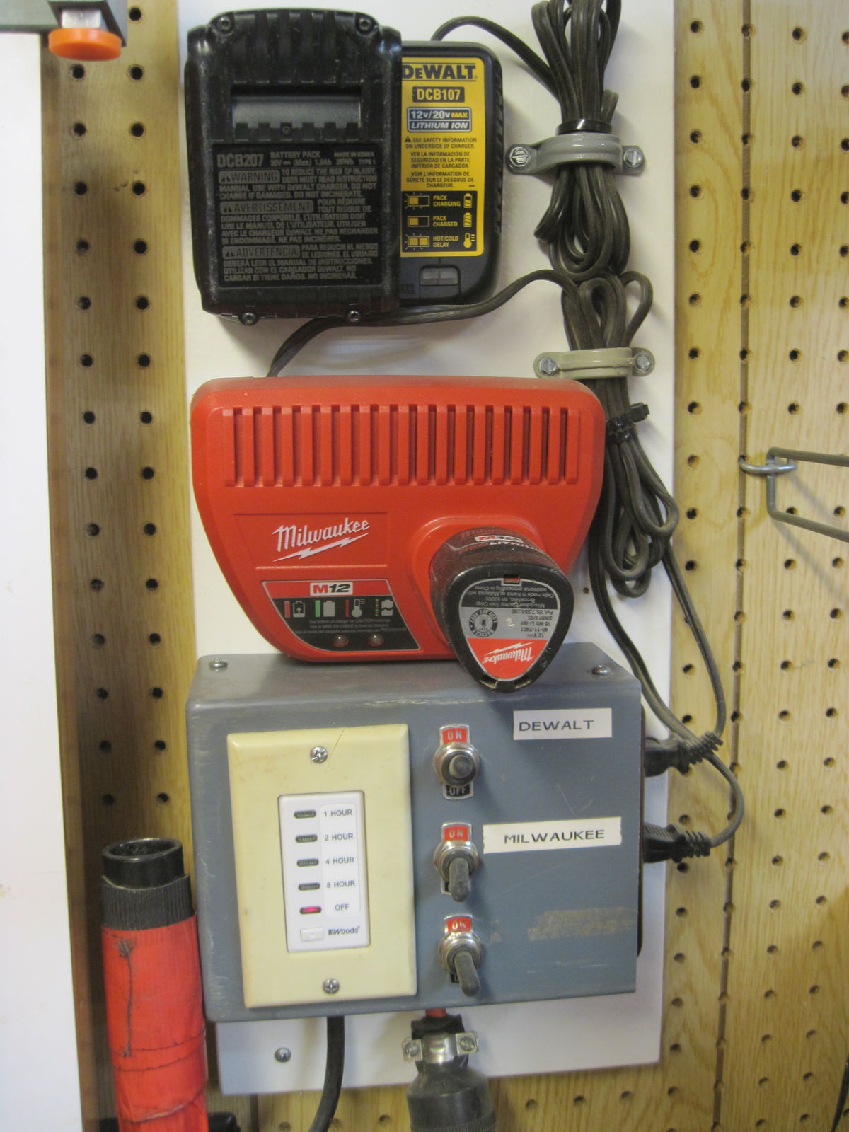

November 2, 20197 yr comment_207321 Something I picked up from a Streamlight Rep, they expect the rechargeable batteries to last at least 1,000 cycles. So get this revelation, everytime you put your flashlight in the charger, that is a cycle. So if it is not dead, and you just want it topped off you cost yourself a cycle. 365 days a year adds up quick to 1,000 cycles. Now they have gotten reasonable with the battery cost, now $20 but the flashlight ain't cheap. Off a tool truck, expect $200 min, online $130 ish. My solution to increase battery life was twofold. I made a charging station with a timer, you set the timer for say 2 hours and then the outlet cuts off, no topping off if the charger has no power. Second thing I did was take a old unit and get a fresh battery. Now I always have a spare full charged battery and still get he break on the number of cycles. Did the same at home. Limit the charger to topping off and just grab it and go. BUT no matter what a extra battery is still a must. Here is setup I use. I have been getting about 7 years on a Streamlight battery, have yet to have a Milwaukee M12 fail, or the DeWalt either. Report
November 2, 20197 yr comment_207341 Not nearly as sophisticated, or as effective as what you did; I have all my chargers on an electronic timer that comes on for about 2 hours once a week. All my OEM M12 batteries died after about 4 years...so that may be the cycle thing you explained. I like that your setup a lot....have to give that some thought. But my timer does make the batteries last longer than forgetting to unplug the chargers for a week or more....which was my old method. Report
