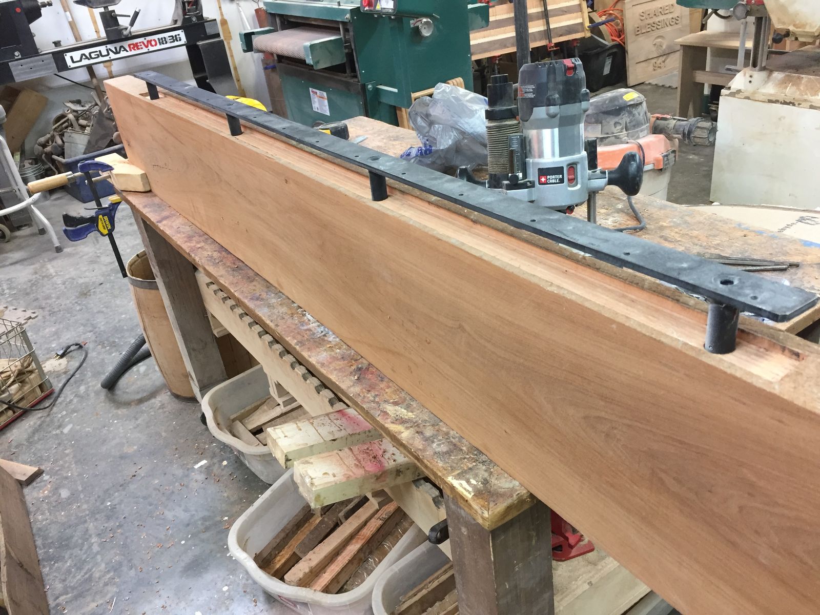

October 13, 20197 yr comment_205012 I have used these for floating shelves several times. I just finished a solid Cherry Mantle using this hardware to hang it.. Report

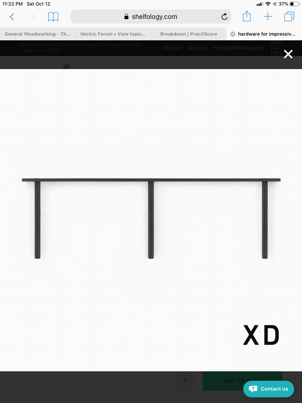

October 13, 20197 yr comment_205022 The four rods on the mantle go into the shelf just over 6”. My pictures didn’t show you the full length of the rods. Of course you can contact shelfology and they will design the shelf for your particular use. They will pre drill for mounting either match your studs or to screw into a header board. Here are some other examples we did using the shelfology system. https://shelfology.com/shelf-hardware/aksel-xd-3-rod-bracket/ this link show a bracket that will support 55lbs per Rod. Hope this helps. Of course using blocking from the backside is also an excellent option. Report

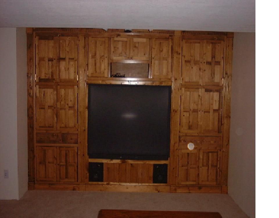

November 2, 20197 yr Author comment_207398 This kinda got my attention for my tv entertainment center... Interesting .... Report
