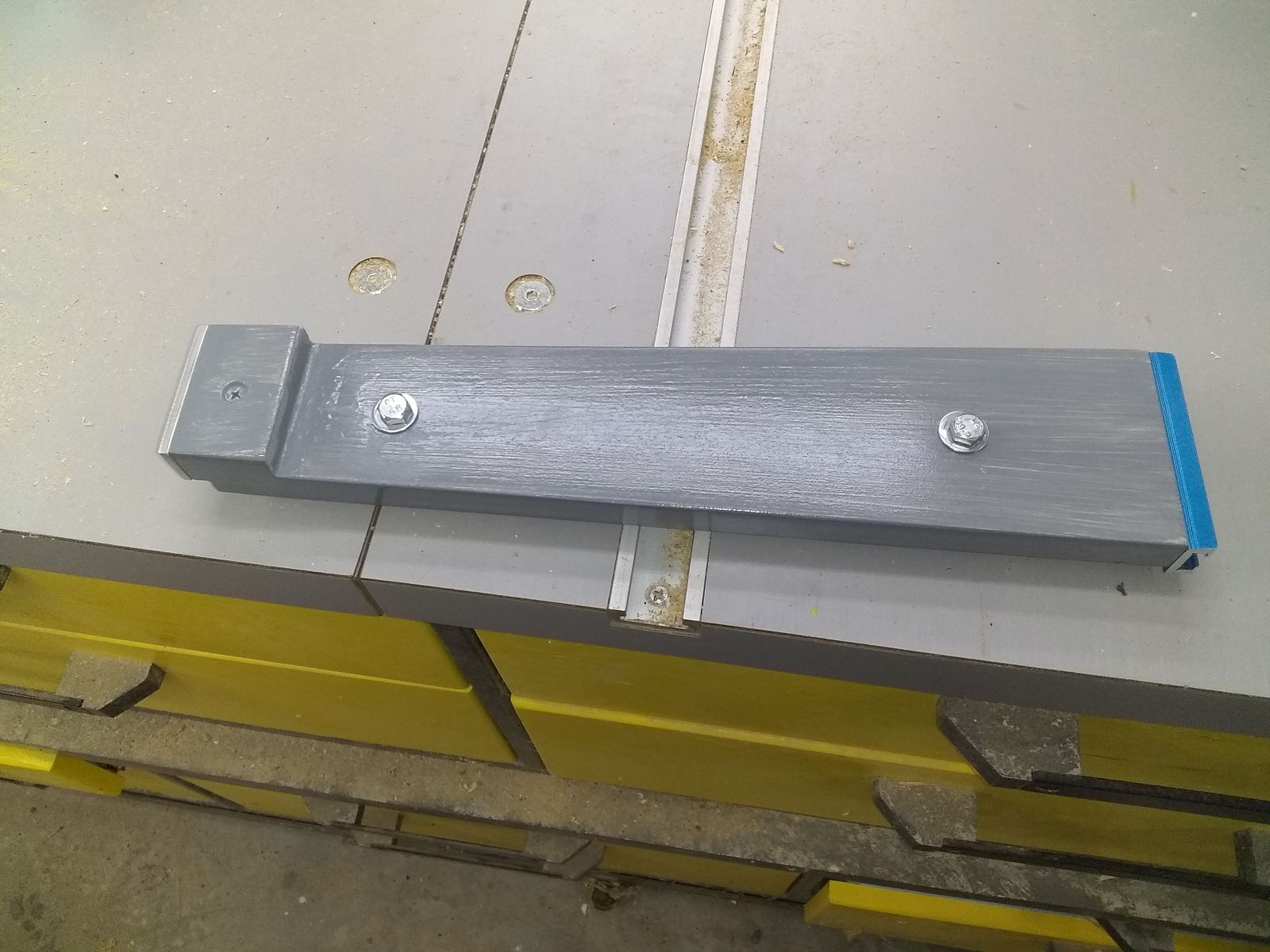

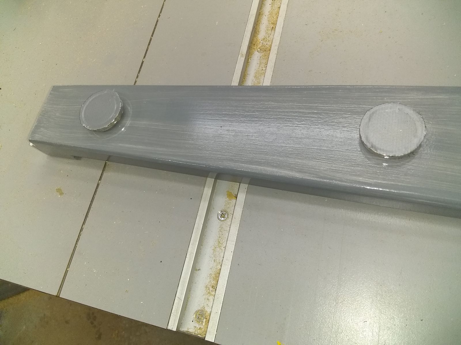

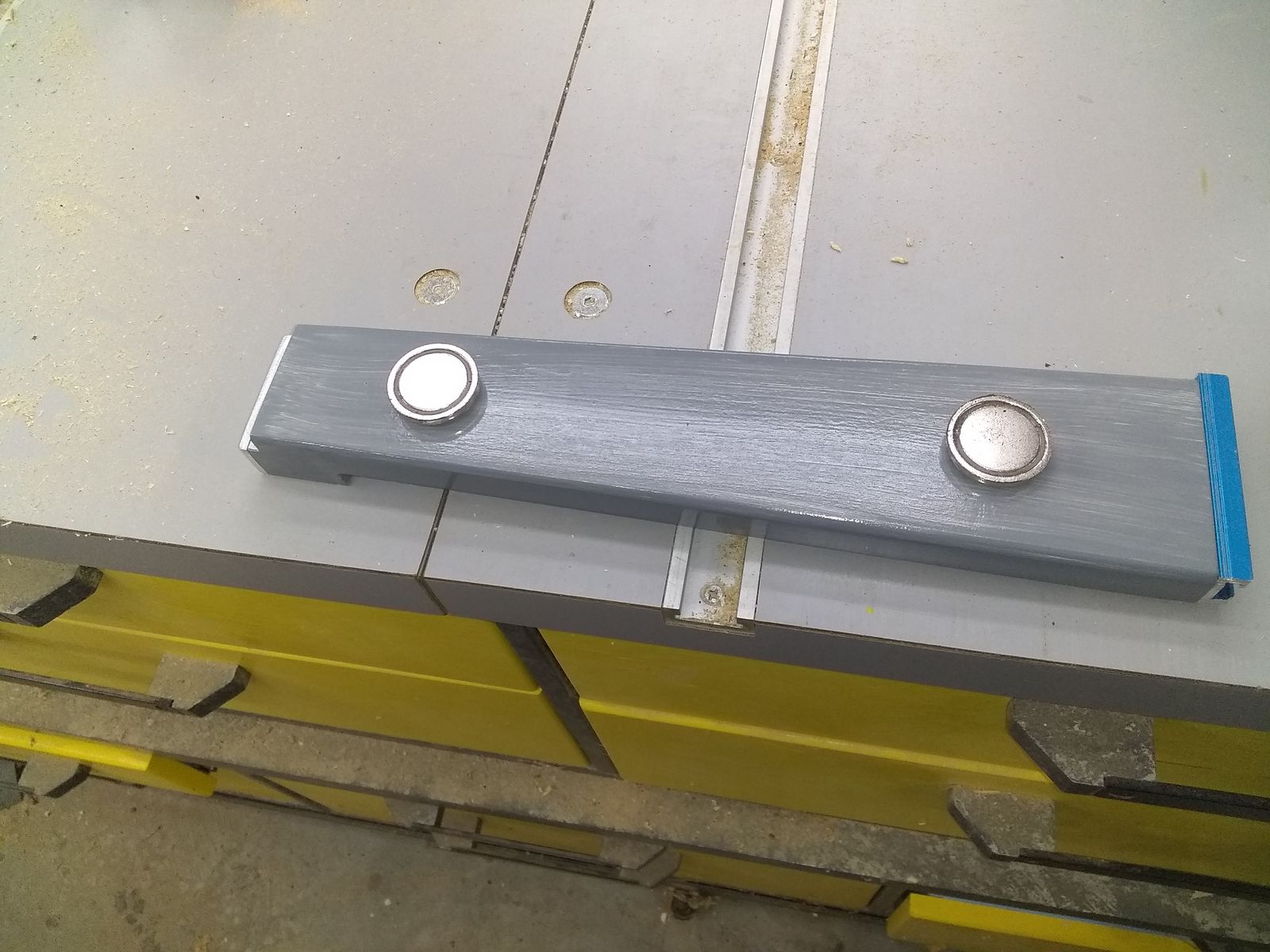

October 9, 20197 yr Popular Post comment_204411 In cleaning up my shop after 6 months of large projects I came across my Rikon 10 inch fence which had managed to get stuffed behind it. Sure I probably don't use it much, but is nice to have when needed. So I looked for a place to put this thing. As I am doing so I remind myself this only works if you can have it easy to get to. So in thinking about placement this was a primary concern. My friend gave me 30 or so of these magnets they use to install a diaper on the forklifts at his work. They don't like oil on the new concrete. Seems they just chunk the old ones. The new kit comes with new ones so why bother? Enter a good friend who remembers magnets are used for several things in my shop. Taking two of these I had a means to attach, but be about to easily remove, this fence holder. Perfect! Now I go to my bins and find a short piece of Kreg channel which fits the one end. Then raided the aluminum bar scrap bin and found a short piece for the opposite end. Now I have metal on both sides which the fence can squeeze and stay put. All that was left was a chunk of wood and some paint. To prevent the magnet from scratching the BS I cut to fit a piece of tape. Simple but effective. Now the fence holder itself is a fair tip. But the real tip is making good use of space, and making in this case a fence, useful because it is easy to get to and you can see it. Without being in the way. Report

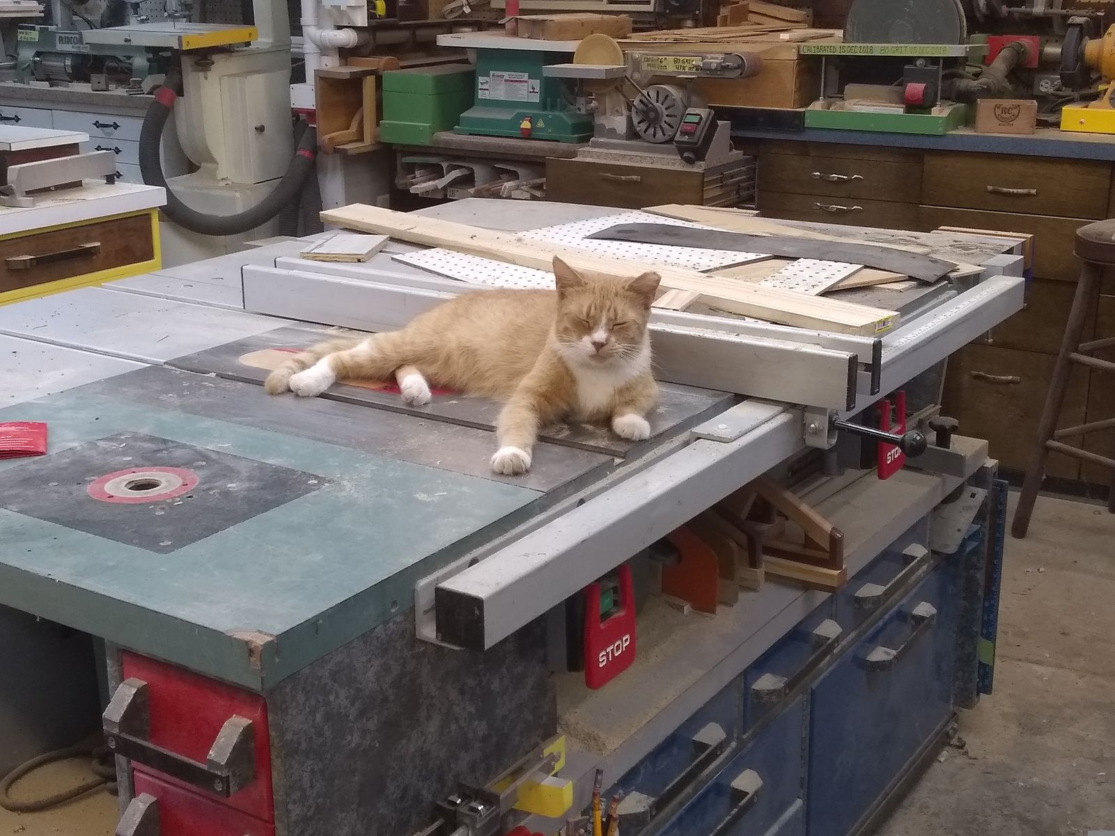

October 9, 20197 yr Author Popular Post comment_204425 32 minutes ago, Al B said: I just turn. to place the fence on the TS. This cat says, "uhmmm, NO you won't!" Report
