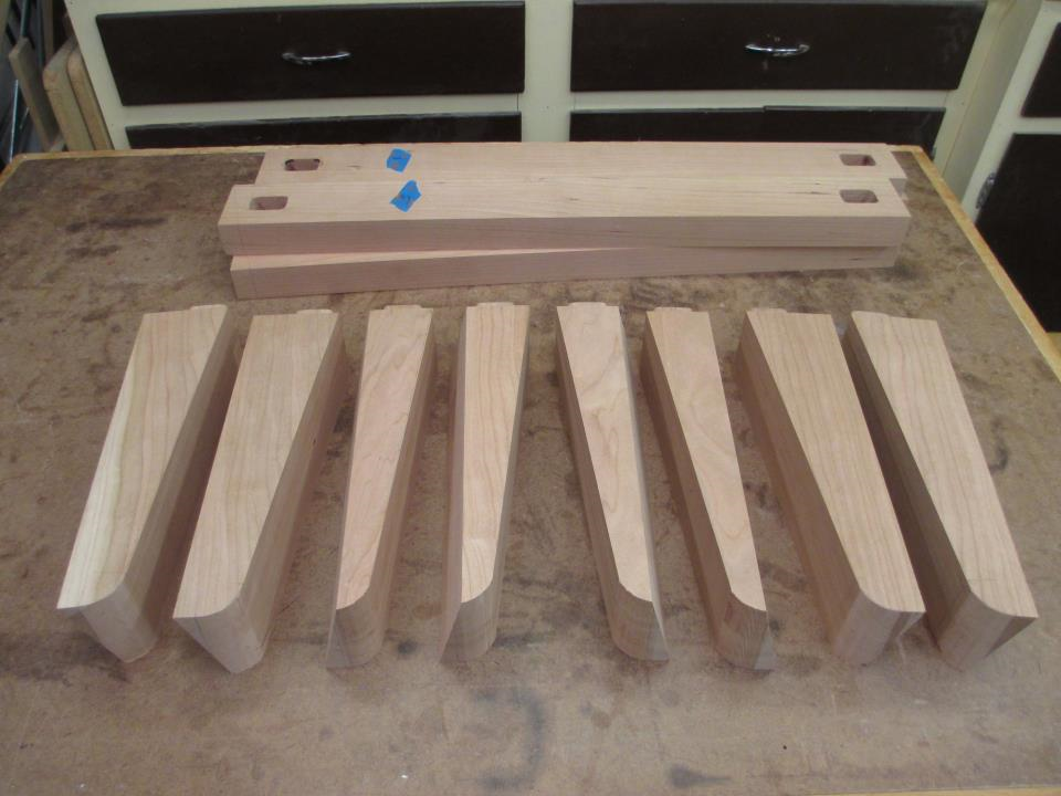

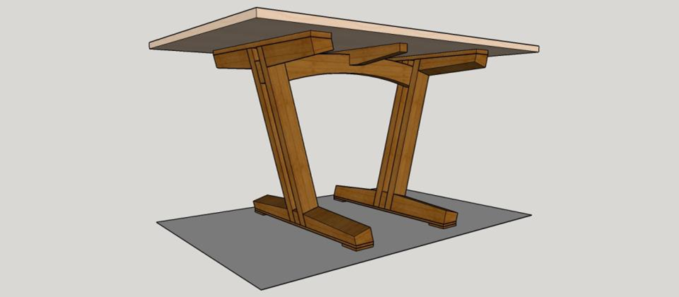

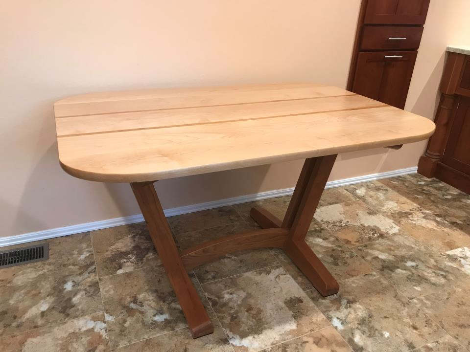

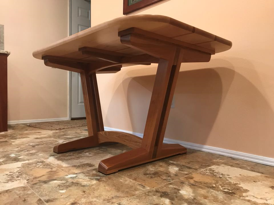

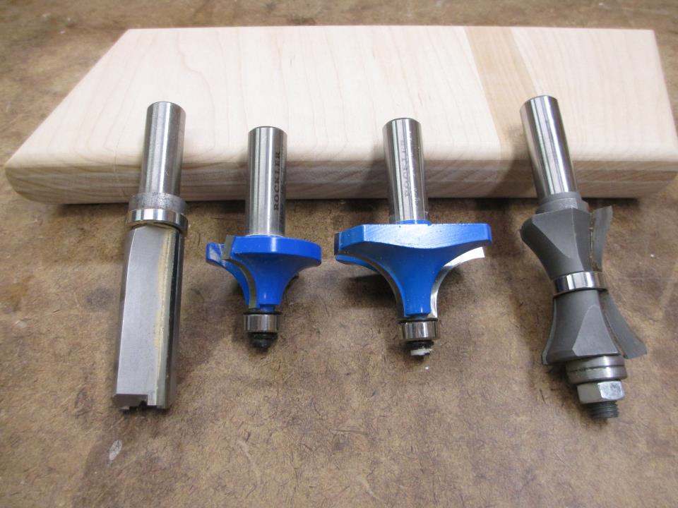

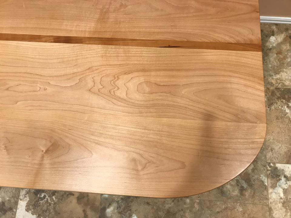

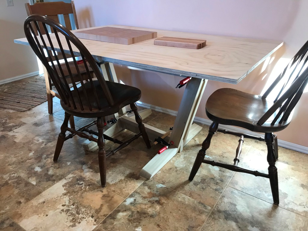

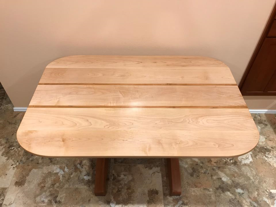

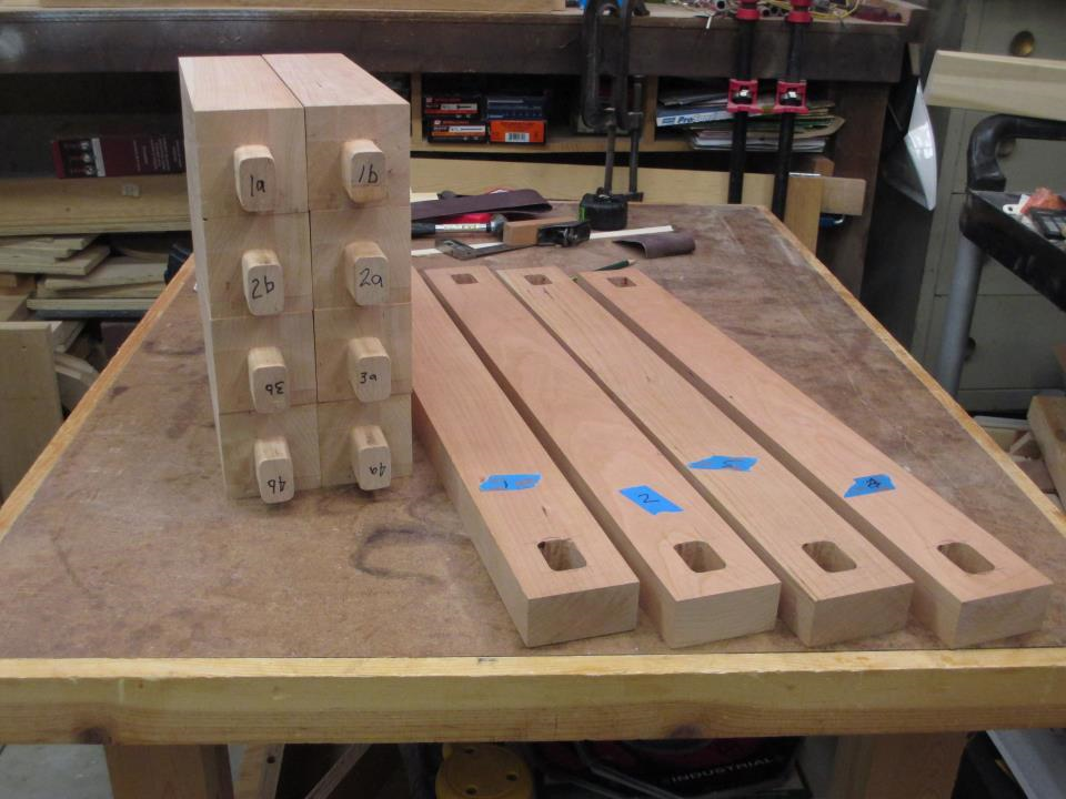

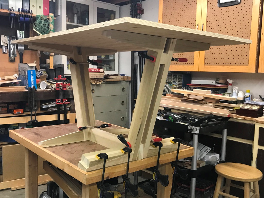

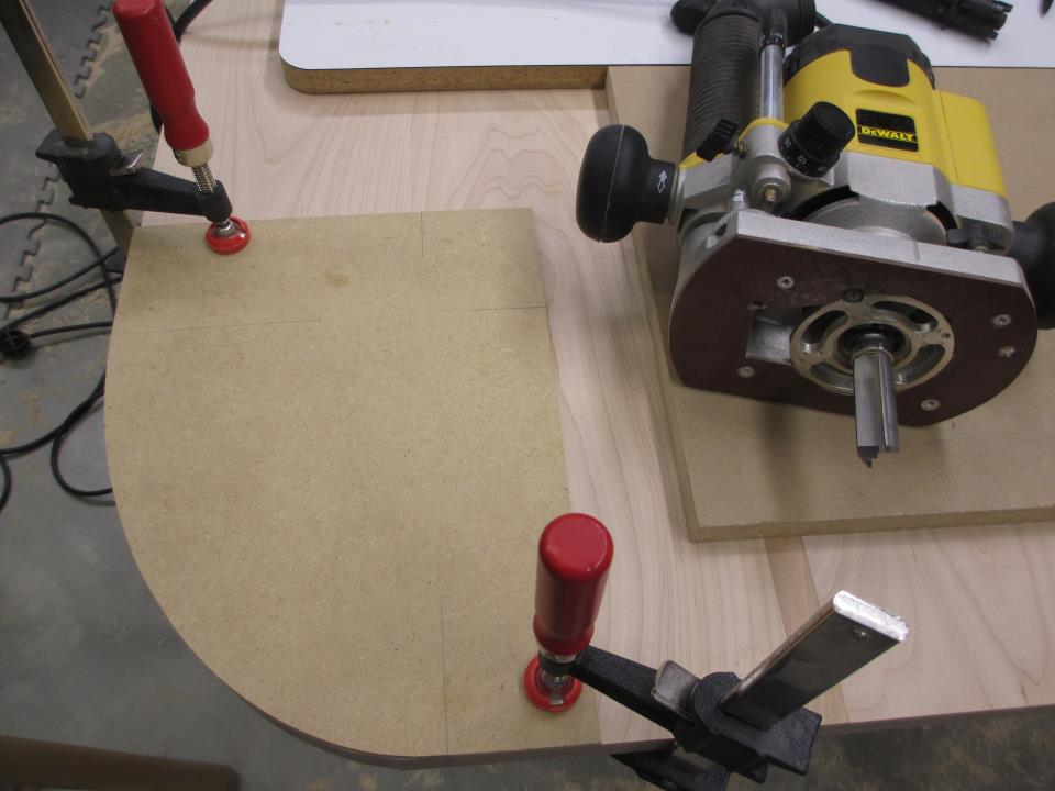

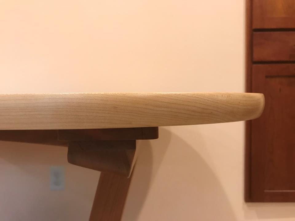

October 2, 20197 yr Popular Post comment_203657 I designed and fabricated a trestle table for our kitchen. The table design was inspired from WOOD magazine Dec/Jan 2014/2015 article. The top is 1-1/8 ” x 36” x 54” made from hard maple wood and having two cherry wood accent pieces. The top has elliptical corners and a thumb nail edge. The base is made from cheery wood and the joinery is primary 1” x 1 ½” x 1 ½” mortise and tenon. The finish applied was one coat of boiled linseed oil and four coats of Sherwin-Williams Sher-Wood Hi-Bold pre-cat lacquer medium rub. A prototype table was build earlier, using poplar wood, to confirm the table size and fabrication/assembly technics. Thanks for looking. Danl Report

October 3, 20197 yr comment_203815 Like others have said, superb drawings and final product. It's beyond my pay grade to know how you got all those angles. That is one complicated piece of craftsmanship. Report
