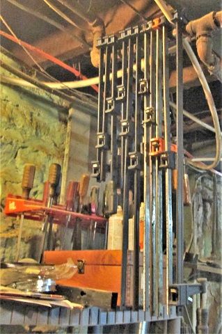

October 3, 20197 yr Author comment_203761 The cabinet in the picture I made at work to house many clamps. I can't have anything that size at my shop. They take some room I guess I'll have to engineer something. Looked many times I guess the kre clamps aren't hung in racks.... Edited October 3, 20197 yr by BillyJack Report
October 3, 20197 yr Author comment_203765 Because those clamps are so deep I may have to turn them on 45 so they don't stick out off the way so much Report

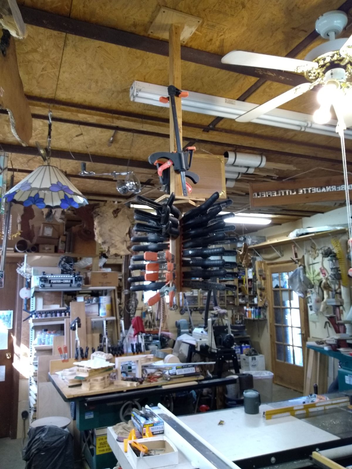

October 3, 20197 yr comment_203800 My shop is 30 x 62' so my stuff is strewn all over the place. I have no work tables so I use the 10 and 12" table saws as work tables. I hung a hand clamp swivel rack from the ceiling some time ago and use it as much as any other except the vise grips hooked over the edge of the table saw extension. I build as I see a need and don't really go by anyone who has what they need. For long clamps I use pipe clamps. Lumber yards has long lengths of 3/4" black pipe and its cheaper for me to buy the long stuff, cut it to size and thread it. I don't use galvanized for it will get slivers in my hands so the black pipe is what I use. I haul the long pipe under the pickup like my dad a carpenter did when I was a kid. It still easy to carry tied to each end of the , I started to say bumper but no they did make it harder to secure than it use to be... For a rack for the pipe clamps I weld pieces of 3/4" oil field sucker rod to a piece of flat steel plate. This rack will last a life time or two.. I find no one has the right size and shape racks for someone else's shop. Also I have no more area on the floor for anything so I have been making use of the ceiling and with age setting in I like it out where I can see things. Drawers are for things in the house and not in my shop. My shop is not for looks. Report

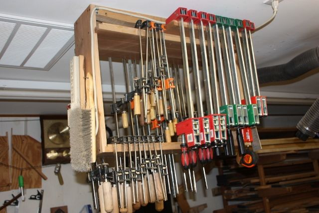

October 4, 20197 yr comment_203880 I have several rack I use for different but I think this may be in your baileywick. The F style and Kbar are placed in horizontally with the rack over my bench to make for easy reach for most used clamps in my shop. Report

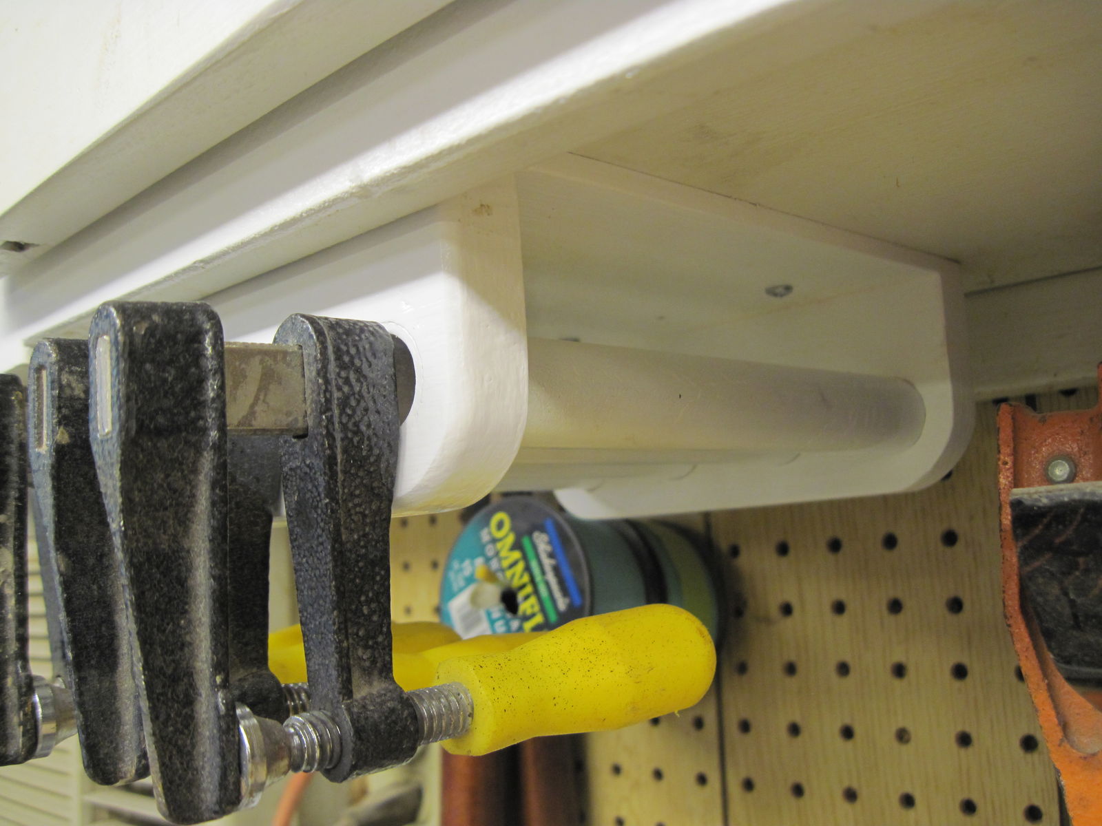

October 4, 20197 yr comment_203881 5 hours ago, BillyJack said: Cabinets take a lot space. I have this problem, and found a creative use of PVC pipe for F clamps made into overhead storage. Not perfect and has it's moments but they aren't on the floor. This is a small version two 4 and 6 inch clamps. Edited October 4, 20197 yr by Woodbutcherbynight Report
