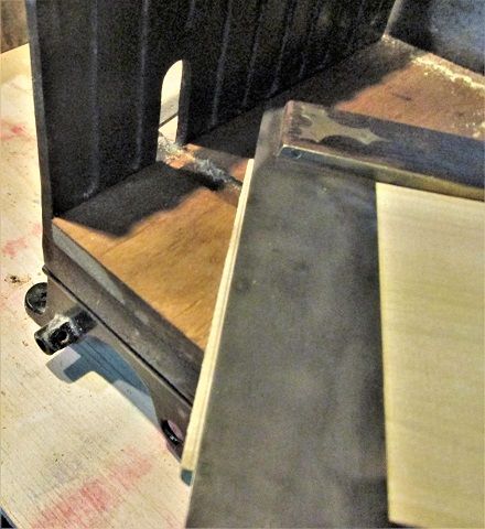

September 17, 20197 yr Popular Post comment_201902 What the title says. Wasn't without some troubles, but..made a start. had some "Project Boards" from Lowes...supposed to be Pine, seems closer to Poplar... Decided to pick out the best 2, and build a box....1/2" x 6" x 24" boards. Issues? Well, that Stanley #358 mitre box had a problem... test cut in the new location showed this to be a "Weeble Saw" Wobbled all over the place in the cut. Pull the saw out, turned the frame over...not only the King bolt was loose, so were the knurled bolts that hold the guides in place...torqued them down as tight as I could, and put the saw back in operation... Not even a slight wiggle. Board? I cut one of the 24" long boards in the middle...then checked the ends... A little off? Sent the ends through.. Then checked for square.. Square now. Used this to mark the other "half", and trim that. Then cut a couple "end" pieces... 2 sides, 2 ends. found some leftover plywood, from the Desk Project...seemed the right width, and was long enough to get 2 panels out of it.. Took the 2 sides, and matched them up in the vise... I also dug the shop stool out. Ends were close to matching each other..we have ways... End grain plane? That is the Stanley #3 I had just finished rehabbing...next, used a jig to lay out the finger joints.. That be the chisel I will use, to chop out the waste. Came towards the middle from each edge... "Dots" mark the waste. the wide finger is where the lid will get cut out... Layout tools. I had to carry the lines down to where they are to stop. marking gauge is set to the thickness of the end boards. And dug up the "Joinery saw".. Took me about an hour to get this far.....had to stop here, Boss needed errand run....might try later tonight? like I said, I had to dig the shop stool out of the place....we are a bit cramped down here.... Stay tuned.... Report

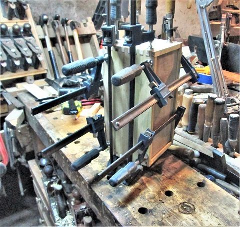

September 20, 20197 yr Author Popular Post comment_202106 3 hours in the shop, today....kind of tuckered out.. . All 4 corners are done... . I don't think this is how to open a box....unless it is from IKEA...not.. Time to get the groove thing going...means I have to stand up to work.. Did the grooves for the top panel and then the grooves for the box bottom panel... Needed a 3rd groove...had to exchange those short rods for some longer ones.. Reset the jig, too, and started making noodles.. A little wax in the groove helps.... I need this groove for when I "split" the lid off of the box.... Needed to get the plywood down to size...then a dry fit... Might be the top...might be the bottom of the box...and... Maybe this one? Did a dry run of the clamps... Going to need a few cauls for this one...new bottle of glue is upstairs...may try a glue up later...a little tired right now... Got a little bit done today....may try tomorrow to get something done Stay tuned Report

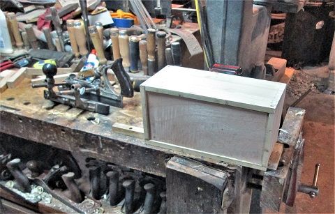

September 21, 20197 yr Author Popular Post comment_202315 Clamps came off today....23 hours after they went on.... Some of the cauls were stuck in the glue....clamped the box in the vise, planed and sanded things smooth and clean Then jigged up a way to hold the box still...and tight to the bench.. So I could run the Stanley 45 along the top edge.. Along the long sides...back into the vise, to do the short ends... Then a marking gauge, and my pocket knife...to split the lid from the box... That inner lip needed adjusted a bit..was a bit too fat...reset the Stanley 45 There is a depth stop on this side of the plane. Almost had enough length in the rods...needed the "cam rest" to balance the plane....liable to tip, otherwise...ran all four edges like this.. NOW, the lid fits down like it is supposed to...needed to figure out what hardware to install...hinges & latche....and maybe add some corner trim? idea is to make a few of these boxes...fill them up will a few tools, then stash the boxes on a shelf, with a label as to what is in each box...may need handles, too...some may get a bit heavy? Stay tuned... Report

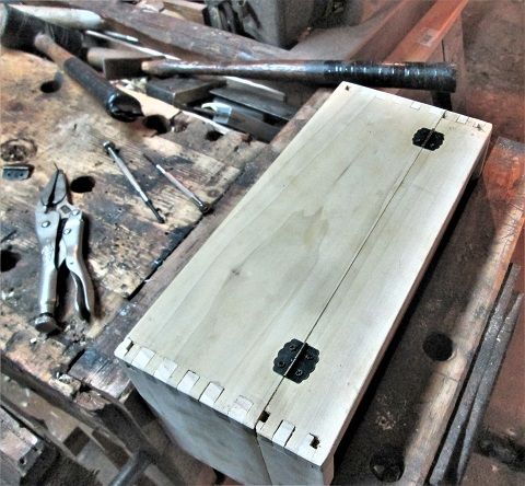

September 24, 20197 yr Author Popular Post comment_202571 Roh-Kay,Raggy....picked up the brass corner brackets yesterday.... Comes 4 to a package....I just don't like the heads on those screws.... This evening? Tools laid out...Visegrips to hold a small nail, to act as a pilot hole "drill" Hammer to drive that. Small screwdrivers..visegrips also helped spin those, to drive the waxed screws home.. Box is held in the vise, so the lid will stay put....don't want things bouncing around on the bench...next.. Better close the latch, I guess... Next..a handle on each end... Then added a brass corner to the bottom corners...a light sanding here and there, as needed. then a coat of stain... Note the brass "feet" ? PIP #2... And #3 Waiting to see how this stain dries,,,may need a second coat....and then a coat or 3 of Amber Shellac... Stay tuned...need to get me eyeballs un-crossed, now.. Report

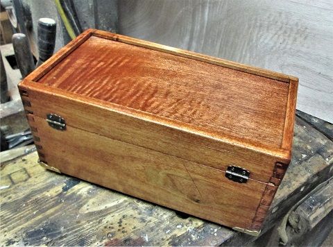

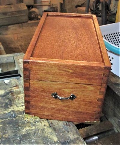

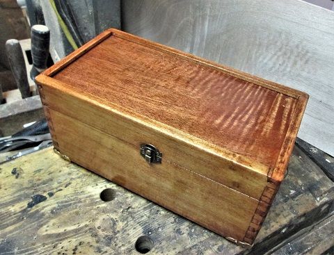

September 25, 20197 yr Author Popular Post comment_202667 Got two coats of Clear Gloss Poly, waiting on #2 to dry, then a rub down.... Front view...strange grain..for being Luann plywood... Hinge side. Handle end. Poplar does have a bit of figure to it. Coffee can of holes saws.. May cobble up a board, to store these on, in the box? Box #2 is already starting up... 2 sides + 2 ends....waiting on the varnish to finish drying, before I make more saw dust... Stay tuned... Report
