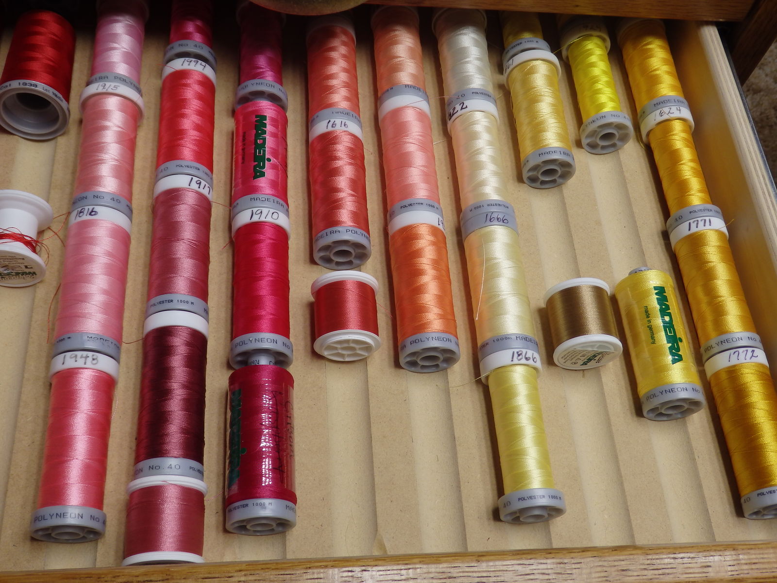

September 15, 20197 yr Popular Post comment_201712 Here is where the table saw with the molding head worked perfectly. I had four thread drawers to do with the thumbnails full depth of the drawer. Very easy and quick on the table saw, not as easy with a router. Roly Report
