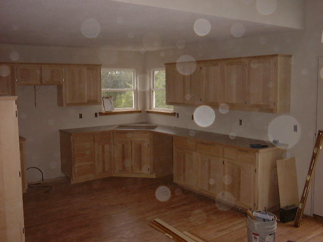

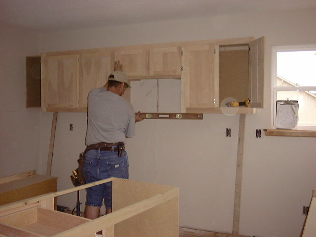

We don't use washers for counter top gapping but you  can use shims as they have different thicknesses to adjust the the line where needed to be cut.You could use several washers but we always had shims around...
To go one step further on counter top installation its fairly easy to trim down a straight top as long as the lip isn't hitting the the front edge of your cabinet but on corners.etc it gets a bit more complicated as the counter tops may just barely fit and removal of even an 1/8 could be costly around the corner.
So always verify there is enough to cut without creating problems elsewhere...
