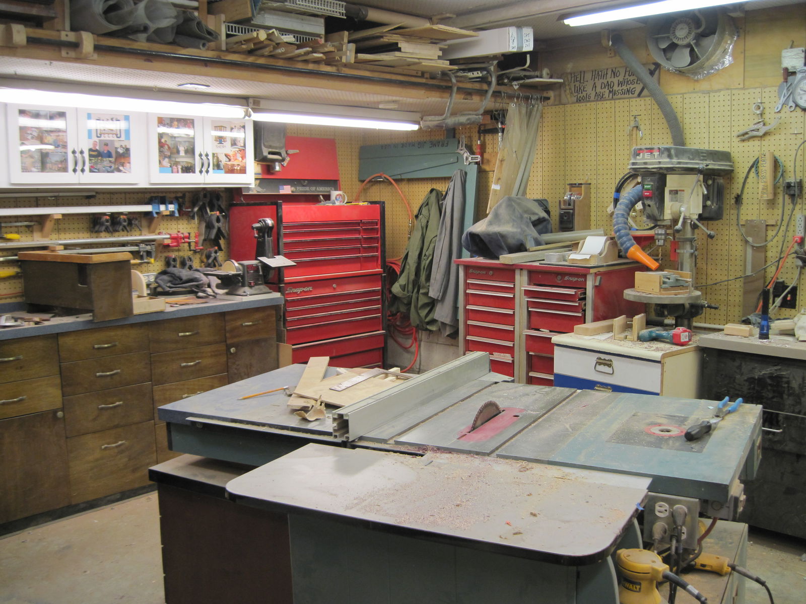

July 19, 20197 yr comment_196348 Take advantage of the tables saw space that is normally wasted. While this is an extreme example of using that space the idea is sound. My twin tablesaw set up is 72 wide and 44 inches deep. Report

July 19, 20197 yr Author Popular Post comment_196370 Ohhhh.... I think, no I’m positive I just pissed myself. That thing is tits!!! Where’s the 8 track go in there? I really like the folding idea and it keeps me from buying anything. Thanks Butcher! Report
July 19, 20197 yr comment_196371 6 minutes ago, Woodpeckah said: I think, no I’m positive I just pissed myself. Took about 5 months of evening work to build. Report

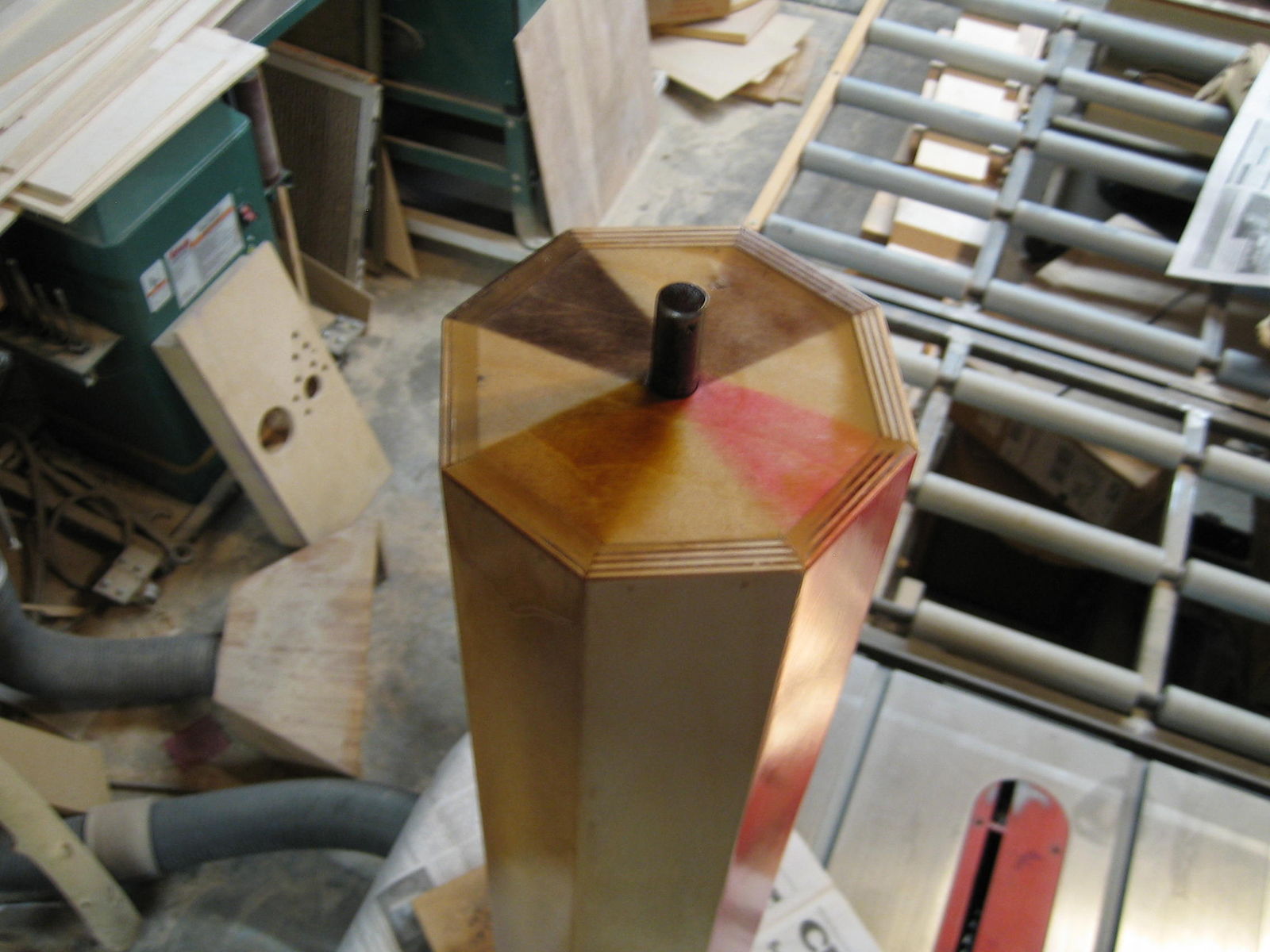

July 19, 20197 yr Popular Post comment_196391 Not a good picture of my outfeed table but is easy to build.... The main reason I finally went to a roller out feed table is every time I went to use it there was 500 things sitting on the solid table that had to be moved somewhere.....If you have a welder then all the rest is just square tubing, 1 1/2" electrical pvc and regular cheap go-cart bearings....It will fold down when I need the extra room it takes up... oh yes for the rods I used used 5/8" oil field sucker rods... being it the oil country it is cheap and easy to get. I use lots of oil field sucker rod...That is it also in the middle of that thing standing up on the table saw as a bearing for that eight sided box I am building also know as my BB 88 GA PC. If you use your table saw to cut up a 4x8 sheet of plywood then this roller table will hold it so I can handle the pllllllllllllllllywood without the help from the kitchen area. Every thing I build has a good lesson history behind it.... Report

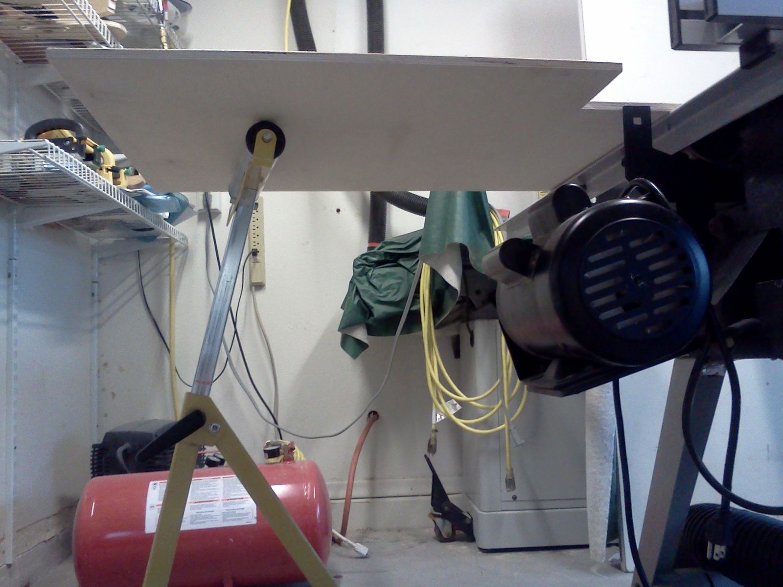

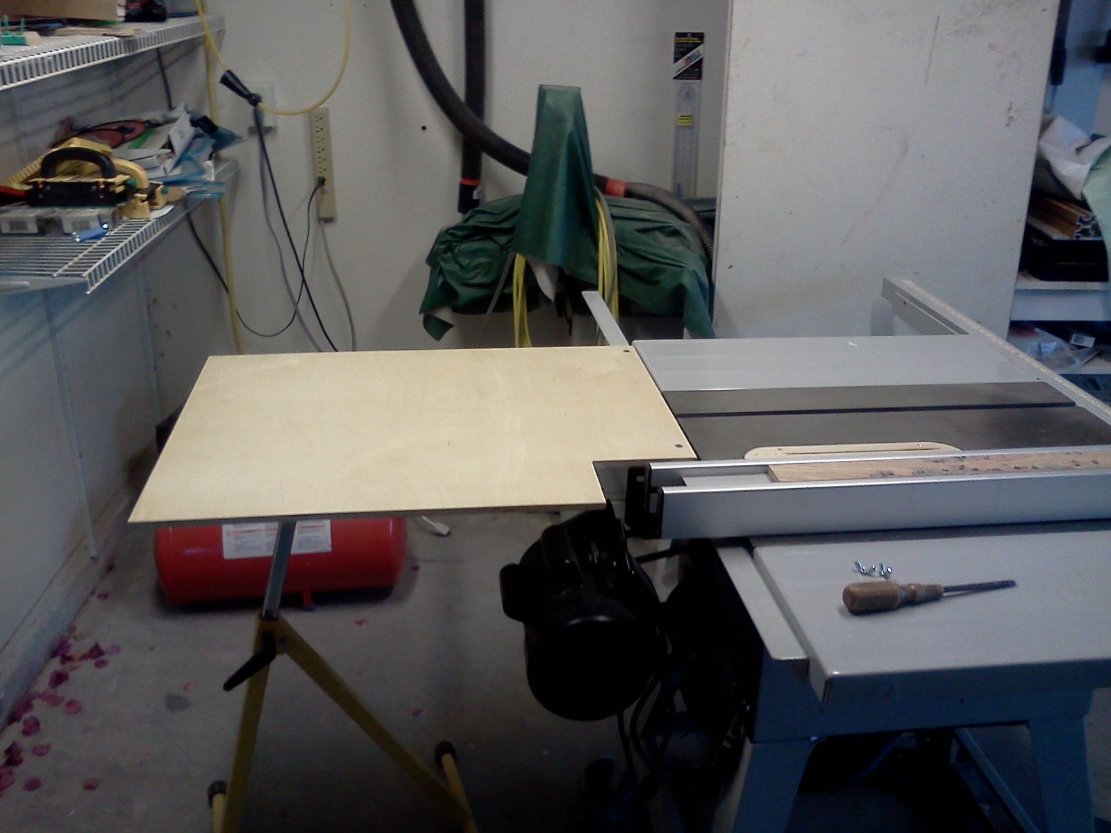

July 19, 20197 yr comment_196438 I think it depends on what you're cutting. I found I do a lot of ripping, max 48"L, up to 24" W, and I want it to disappear at times. I tried rollers, but I had a lot of trouble finding the "sweet spot" where the work just kissed onto the roller without tipping it over. So, I made a platform that's held by two machine screws + wingnuts, on top of the roller. I found that I didn't need to exactly match the TS table height, so I used 3/8" ply, and that's enough that the workpiece doesn't fall onto the floor or try to tip up while still being cut. Report

July 20, 20197 yr comment_196456 4 hours ago, PeteM said: I found that I didn't need to exactly match the TS table height, so I used 3/8" ply, and that's enough that the workpiece doesn't fall onto the floor or try to tip up while still being cut. Used a similar set up with a removable piece of Lexan so I could use the back bar on the fence. Worked well for a long time until I got the 2nd saw and build the single cabinet for both saws. Report

July 20, 20197 yr comment_196494 6 hours ago, Gerald said: If you want a drop down one can be attached to the back rail with hinges so it can be put away when not in use. Problem is that contractor style saw's motor is in the way, can't hinge. Report
July 20, 20197 yr comment_196544 16 hours ago, PeteM said: Problem is that contractor style saw's motor is in the way, can't hinge. You could build a shelf out over motor to hinge to. Report
July 21, 20197 yr comment_196551 3 hours ago, Gerald said: You could build a shelf out over motor to hinge to. I did this on my old set up, was very convenient. Report
July 21, 20197 yr comment_196565 13 hours ago, Gerald said: You could build a shelf out over motor to hinge to. KIS: I already had the roller stand, and two machine screws fix wood to flange. Not shown in these pics, but I eventually put a hole in the end and hang it on the wall. Easy peasy, out of the way. Report
