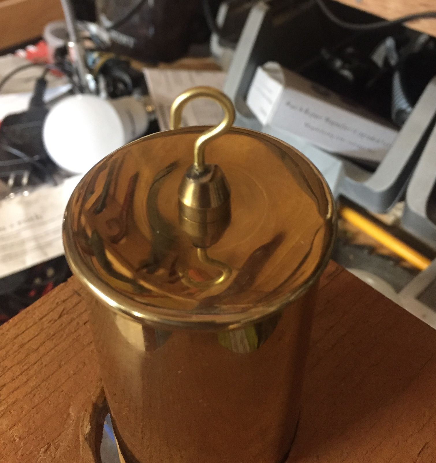

July 27, 20197 yr Author comment_197104 While removing the weights for transport...........I dropped one on the brass hook and broke it. Yes, I am that clumsy. I have to buy a complete set of hooks with metric thread to replace one. $25 & shipping. I am trying something. I cut off the remaining hook, filed it off, drilled a small hole and threaded in a brass hook from HD. It had a wood thread and I cleaned it off until it screwed in very tightly. I removed it and put JB weld in the hole and on the thread. I think it will hold. I considered soldering it, but I do not have a heat source for such a tiny piece and I didn't want to have a solder mess, especially one that would turn the brass to silver. Do you think it will hold? Report
July 27, 20197 yr comment_197110 Ron , That should do the job as long as the new hook did not get cracked in the process of tightening. After all brass is so easy to break. Report
