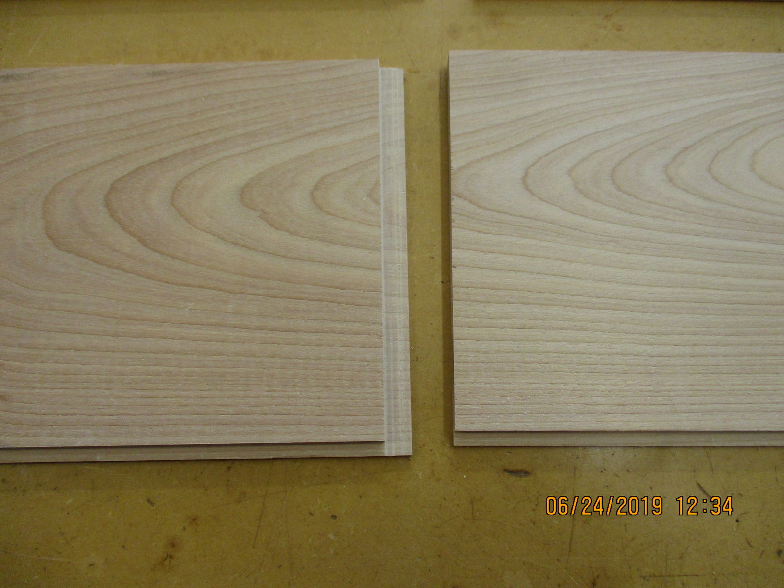

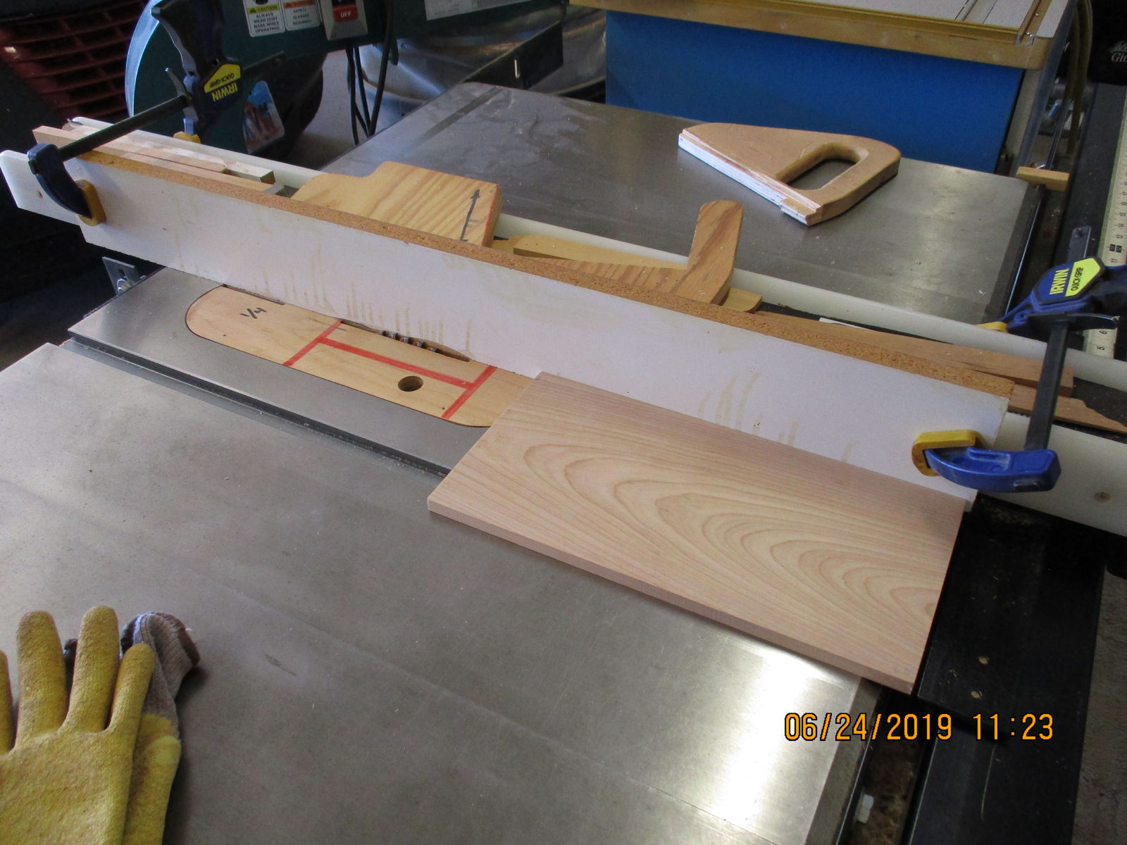

Cut the rabbets for the bottom and sides.

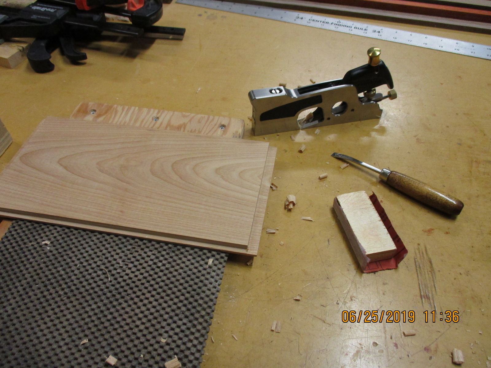

Clean the rabbets up and do a test fit

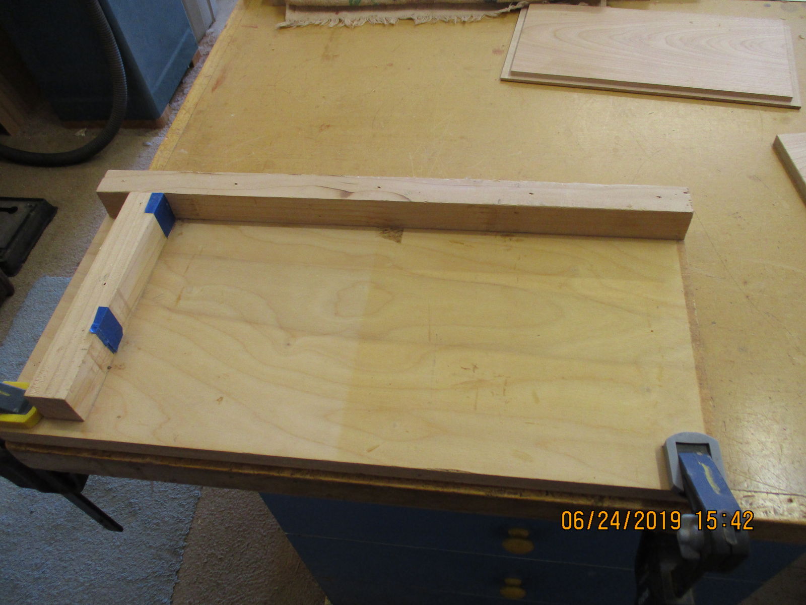

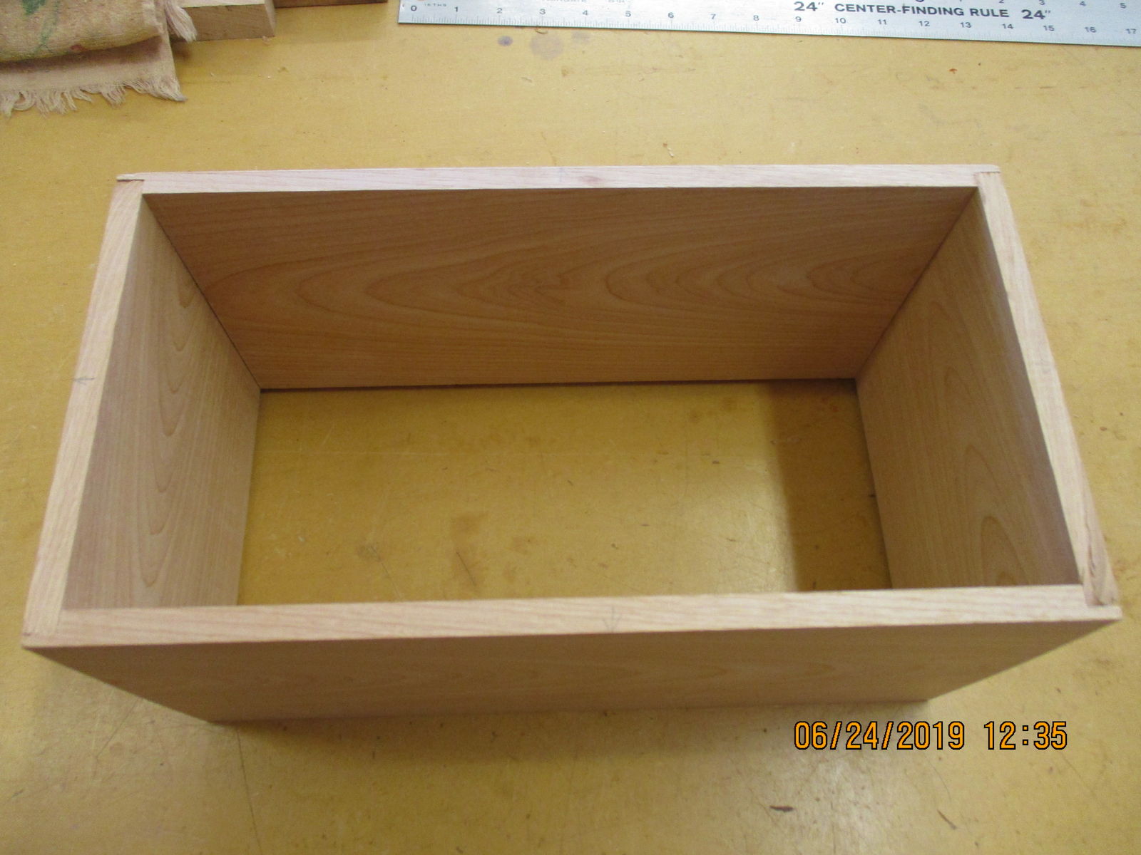

Set the assembly jig and do a dry fit

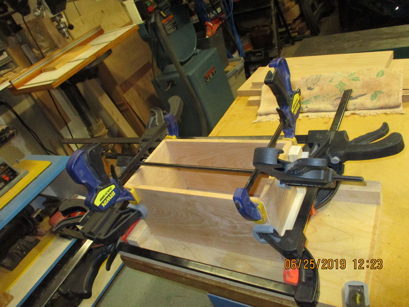

Glue the joints and clamp it all together.
Let the glue set for 24 hours. Part 3 will be making the bottom and trim pieces.

8 hours ago, lew said:
Really like that assembly jig!
+1
7 hours ago, FlGatorwood said:
+1
+2, I may do a version of this for picture frames...
hat, is this assembled with glue only - no pins or anything?

Hi Cal
The assembly jig makes square glue-ups much easier.
Glue joints only, no metal fasteners of any kind.
