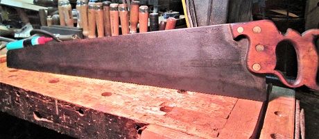

Washbourne Patent...DEC 31  1867.    Plan now is to scrounge up a punch to gently drive each bolt back through the handle, take the handle of the saw off.   Clean and sharpen the saw's blade, and maybe refinish the handle.    Will even shine up the brass....:ChinScratch:
Not too bad, for a $1 saw?  :JawDrop:

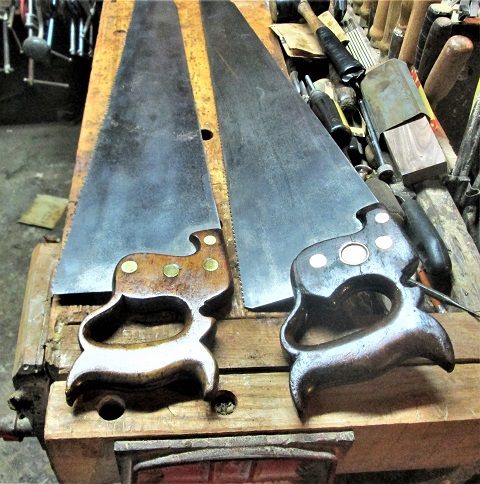

Bottom saw is a bit newer Panel saw...by Simonds.  :OldManSmiley:
Sorry, no medallion on the rip saw.....:ChinScratch:.

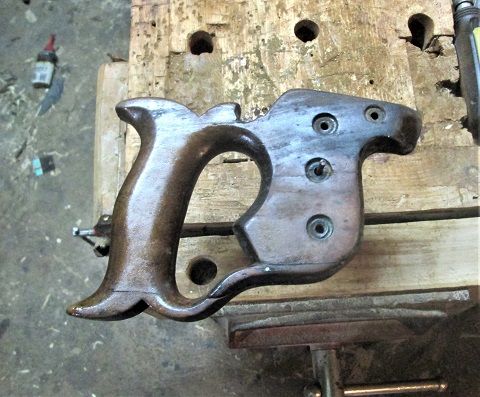

Saw has been taken apart, worst of the mess is cleaned up...still no etch....:WonderScratch:

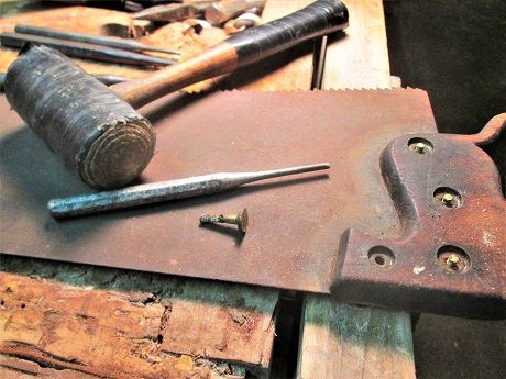

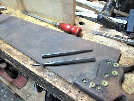

First 2 punches were too big...:BangingHead:
Dug around to find the correct size.   Place the bolt over an empty dog hole on the vise, to catch the bolt when it came out..rawhide mallet was a bit gentler than a steel hammer.   each bolt was placed back on it's nut, and stacked aside in the order they were in the handle.   One size does not fit all, with these..:BitingNails:

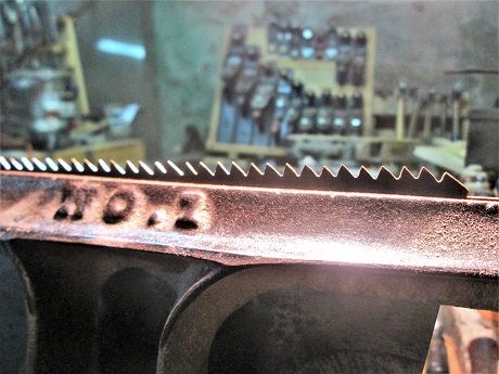

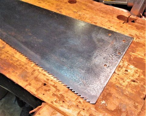

Plate was sanded cleaned...tried to find an etch..nada...did find a "6" stamp (6ppi) down by the teeth..and, just above the bottom hole, there is a large "C" stamp.

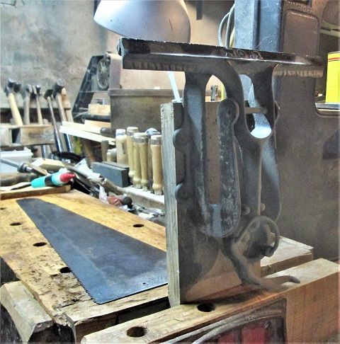

That red handled file in the first photo, is the saw file holder....we have work to do...:Tapping:

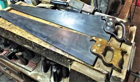

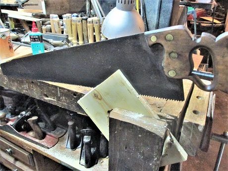

may take more than one sharpening, to fix these.:OldManSmiley:..handle was  sanded smooth, brass polished up...put things back together..
Not sure I like the "hang" of this handle...seems a bit low.  B)  Set up a test track..
may get a few more coats of amber shellac...that "step down" along the top of the saw plate...is for an intact "Nib".....aka "Hood Ornament"  most saws had  back then. B)  I rubbed a coat of 3in1 on the plate, for now, to keep the rust bunnies away..:MachineGun:
Wonder how many homes and barns this saw helped build......:ChinScratch:

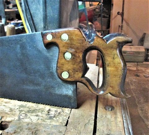

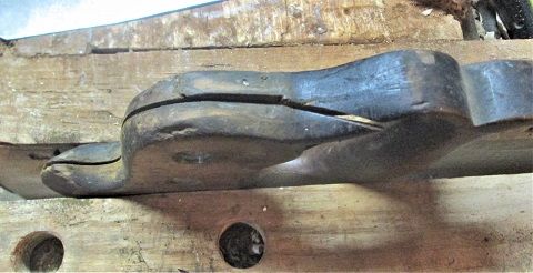

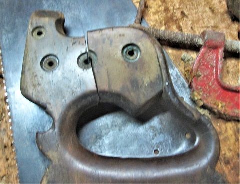

Also reworked the Disston No. 7...about the same age...handle had ...issues:CoveringEyes:
And..:JawDrop:
Was basically in 5 pieces...and had a couple small nails, too....cleaned things up, got one of the nails pulled....Locktite 2-part epoxy to glue things back together...
Looks a little better...:ChinScratch:.couldn't get that nail out, left well enough alone....Shined the brass up..

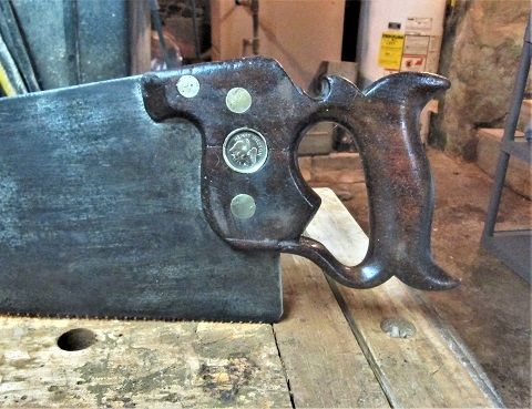

Dremel with a polishing tip, and some green compound...above the Eagle is "HENRY  DISSTON".   Since the 1st "son" didn't join the firm until 1871....means this saw is from before that date....10 point, crosscut....so, now I have a "Rip" and a Crosscut saw, about the same era..:OldManSmiley:
Varnished both handles, brass shined up...ready for inspection..:SaluteandRun::SaluteandRun:
I think that will just have to do...:TwoThumbsUp:
