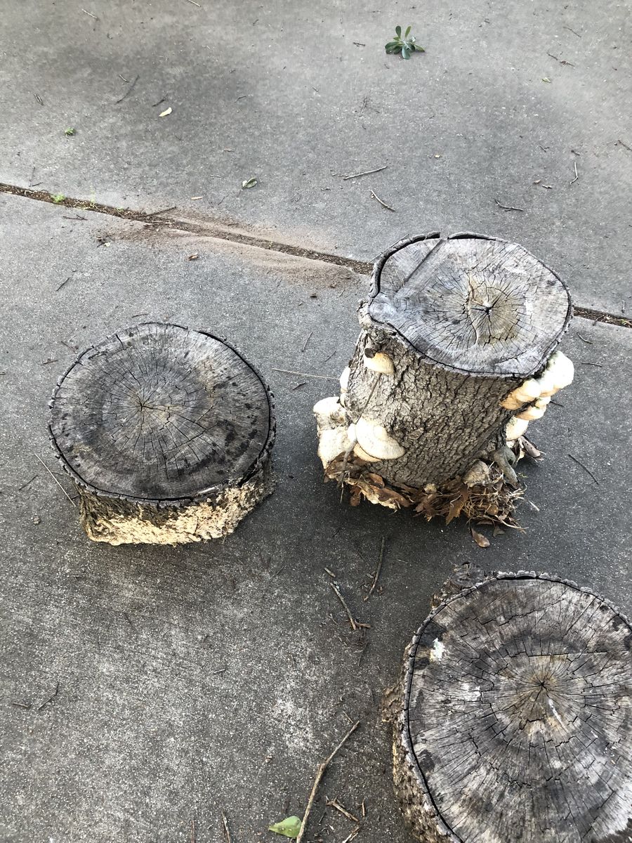

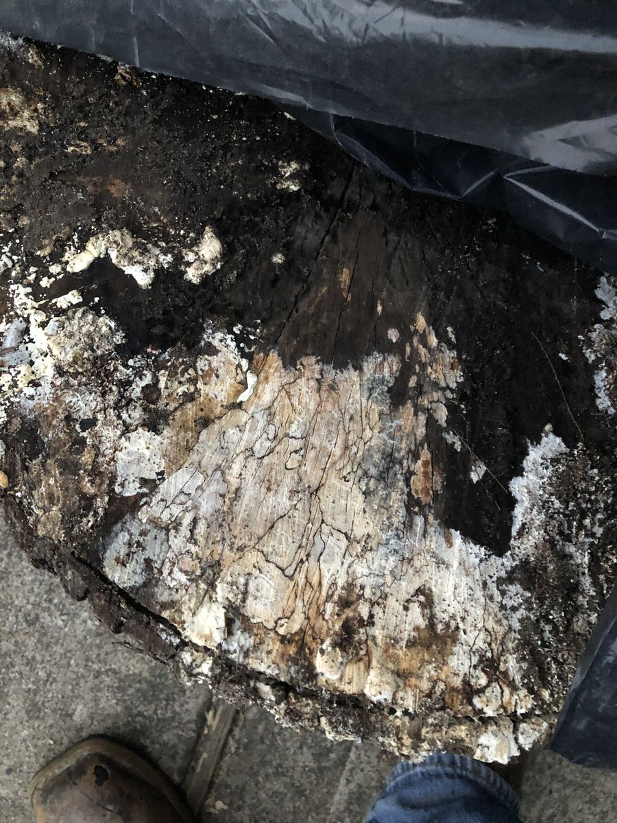

April 17, 20197 yr comment_187840 So I picked up these logs the other day and they have great signs of being spalted but I can’t work them just yet. Shop is buried in bee hive parts right now. Any advice on storage? They sat outside for a year and at the moment they are sitting in my driveway wrapped in trashbags. I guessing introducing fungus into the garage could be bad for the hives. I actually have four logs of it, came from a sweet gum tree. Report
April 17, 20197 yr comment_187846 You might strip the bark and let them sit outside in the sun to stop further growth. Otherwise, bag 'em up again until you are ready to work them. Looks like they'll have some nice spalting. Report
April 17, 20197 yr Popular Post comment_187858 Moisture causes fungal growth and when it is removed the growth stops. As to the danger of turning it the fungus is in the air we all breath and sometimes like bacteria growth conditions cause an overgrowth so there is no additional danger to turning it. Storage of this wood should be in a dry place. However from my experience with SG and looking at the wood it may be too far gone. When you have mushrooms the decay has gone too far. As a famous turner (John Jordan) says "Life is too short to turn crappy wood". Now that does not mean that do not waste some time in that area too. Report

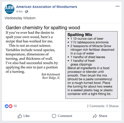

April 18, 20197 yr Popular Post comment_187878 Here's something I saw today on a Facebook post from the AAW. Not so much storage but how to make spalted wood- Report
April 18, 20197 yr Author comment_187880 I’ll keep them bagged for now once I get the hives out of here I’ll bring it in and see how deep it goes I have two stumps that haven’t developed any mushrooms and they still have some good weight to them. But the two longer pieces with the mass fungus growth are lighter then you think. Light enough my nine year was carrying it easily. Edited April 18, 20197 yr by Mijohnson1984 Report
April 18, 20197 yr comment_187881 1 minute ago, Mijohnson1984 said: I have two stumps that haven’t developed any mushrooms and they still have some good weight to them I have one and it is currently being slow cooked. Been at it two days, expect two weeks of slow cooking using used motor oil. So far I have a nice ring about 4 inches deep with another 7 to go to being flush with ground. I did notice when splitting some of the branches to get fire going that the wood had spalted. Report
