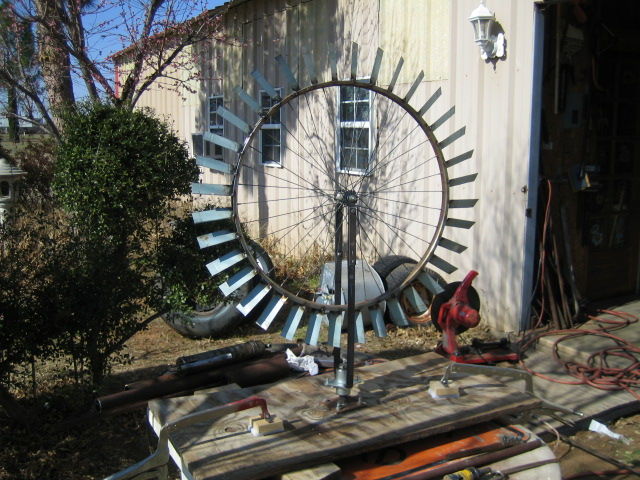

Hey Ron can you find any used bicycle wheels in your area?1843241457_windmill003.JPG.7a9ab02e0045075e32c2be76cb10d24e.JPG473263150_26inchbicyclewidnmill002.JPG.39d6c9a469f0d5b8dc98d85e4d7344e1.JPG

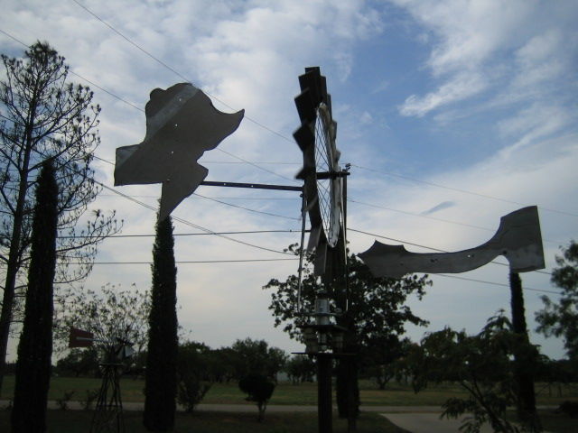

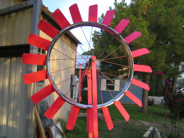

These wheels work real good and run a long time with out messing with them. I pack the bearing with regular car wheel bearing grease and these pictured I build in  08-2014 and haven't touch them since I put them up... The fins that are blue are light weight steel and came from some metal window blinds. The red ones are thicker about 1/16" and easier to weld. The fluorescent paint only stays that color about two weeks and fades real bad.874847036_laidbackTexas001.JPG.f5567d88fe6584957c3d441771886def.JPG
 The laid back Texan is made of aluminum as is the arrow.
 I built a little jig to hold the fins in place while welding them and they will run with a very light breeze. Used bicycles at garage sales are real cheap. I use a part of a go-cart wheel for the swivel which takes two good sealed bearing so they will last a long time also... So far they have all been balanced real good with out having to mess with weights after I weld them up...I've use spoons on one which looked okay..
  I buy the metal at a metal building supply and they will slice ten foot pieces the size you want like shown which are 2" wide then I use the metal cut off saw like in the picture to cut the length I want to use.. HD or Lowes has metal racks but buying the short pieces from them are way more than what you can get at a metal supply
