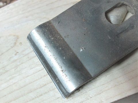

March 8, 20197 yr comment_181514 1 hour ago, Michael Thuman said: Do you mean put the chip breaker away from the taper of the 25 degree angle to the iron full thickness and back further by 1/32 - 1/1/6"? Maybe a picture would help? Red arrows (best I could draw them) indicate the distance from the edge of the iron to the edge of the chip-breaker. Blue arrow shows where the chip breaker should lay flat across the back of the iron. Assuming so, but just to verify, you do have the bevel down as shown? As for resharpening from 30o to 25o, I would just resharpen the leading edge and leave as a micro bevel. Eventually you will have it fully back to the 25o. Saves time if you're doing it by hand. If you have a Worksharp or some other powered grinder, I guess you could fully regrind the angle but I would go with the micro-bevel. My $.02 Report
March 8, 20197 yr Author comment_181523 38 minutes ago, Grandpadave52 said: Red arrows (best I could draw them) indicate the distance from the edge of the iron to the edge of the chip-breaker. Blue arrow shows where the chip breaker should lay flat across the back of the iron. Assuming so, but just to verify, you do have the bevel down as shown? As for resharpening from 30o to 25o, I would just resharpen the leading edge and leave as a micro bevel. Eventually you will have it fully back to the 25o. Saves time if you're doing it by hand. If you have a Worksharp or some other powered grinder, I guess you could fully regrind the angle but I would go with the micro-bevel. My $.02 Thanks for the information. Now I see the micro edge is a great idea! Thanks and I had the chip breaker up to high. Thanks again. Also I had the bevel up not down because how else would it find wood to lift up. But I see (lightbulb) this is a smoothing plan to when it finds a ridge it will shear it off. Thanks a million. Report

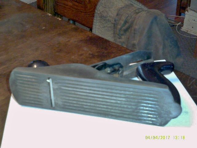

March 8, 20197 yr comment_181525 Does it look like this? Except mine was made in England... Sharpened to 25 degrees...chipbreaker is set back 1mm from the edge. Report

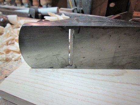

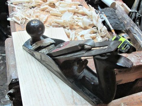

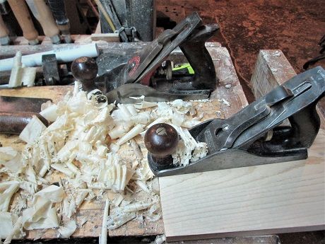

March 15, 20197 yr Popular Post comment_182573 Let's try something here...I got out a #4 sized plane about the same as the OP's, just is was made by Millers Falls.... Frog is a little different, but, where I set it is the same....there is a small "ramp" right at the back of the mouth opening.. You want the ramp and the face of the frog to line up...I usually use a finger tip to check... I set the chipbreaker/capiron back from the edge about 1 mm. bevel is underneath this ....there should be no gaps between the cap iron and the flat back of the iron... Carefully set this into the plane.. So that it just barely pokes through. The Lateral Lever can be used to tilt the iron so the edge is straight across the opening...set the depth to where it barely cuts. Some eyeball it, I just use a fingertip.. I usually push the plane along at an angle, it is going at a skew. But, I push it straight down the board ... So when I reach the other end, I am still at that angle. i can go straight down the grain, but that sometime gives a bit of tearout. By "slicing" along, less chance of the grain catching and tearing... Stanley No. 3c....set up the same way as the larger plane.....and, for Mr. Morris.. Finicky, but it do work.... Any other questions? Report
