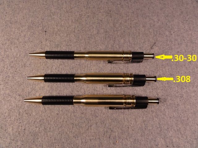

March 2, 20197 yr Popular Post Friend of mine likes his .308 rifle and gave me some shells to see if a pen could be made using them. Well yes I can. I found the .308 shell was a bit short so I figured a spacer to make it longer was needed. Looked at various ways and materials for making the spacer and ended up with cutting the top off a second shell the necessary amount would be best. I like how they turned out and since I had a few .30-30 shells I made a couple from them too. The .30-30 shell was a tad longer than the .308 and on both I had to press a piece of 5/16" brass rod through the boss for the bullet to enlarge it for the pen guts to fit.

March 4, 20197 yr 2 minutes ago, lew said: Cool!! How is the top of the second shell fastened to the pen shell? compression???
March 4, 20197 yr Author 35 minutes ago, lew said: Cool!! How is the top of the second shell fastened to the pen shell? 32 minutes ago, Stick486 said: compression??? Stick got it right. They were both drilled with the Letter "O" Drill and are a snug fit. Once the pen is threaded together everything is nice and tight. The top of the shell is solid brass until the powder chamber starts which is close to 3/8" from the end so it doesn't wobble around.
March 5, 20197 yr Author 7 hours ago, Charles Nicholls said: I soo want to know how to make these. 🤣🤣🖊 Here you go Charles. Use the letter "O" drill bit to drill the hole in the end after removing the primer. I would love to see you make these so any questions ask freely.
