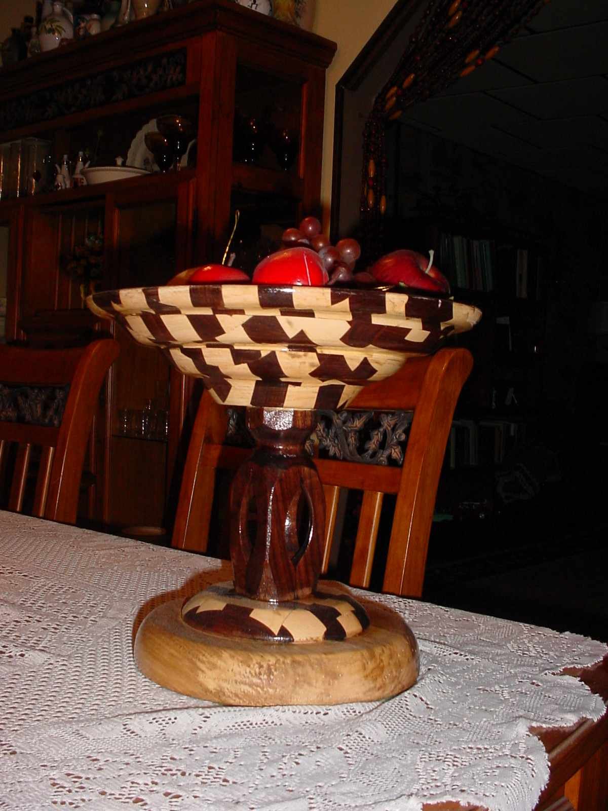

2 minutes ago, Kevin Beitz said:
All the inside out items I made starts out whole.
After I turn my part the first then cut it
into 4 parts and flip them. Different ways to do
the same job....
I have seen them done that way but have never tried it.  Either way it is done, accuracy is key.  The 90° blade setting is a must from start to finish.  The blank must be perfectly square to start.  The four quarters method allows for smaller stock to be used which is a real plus.
