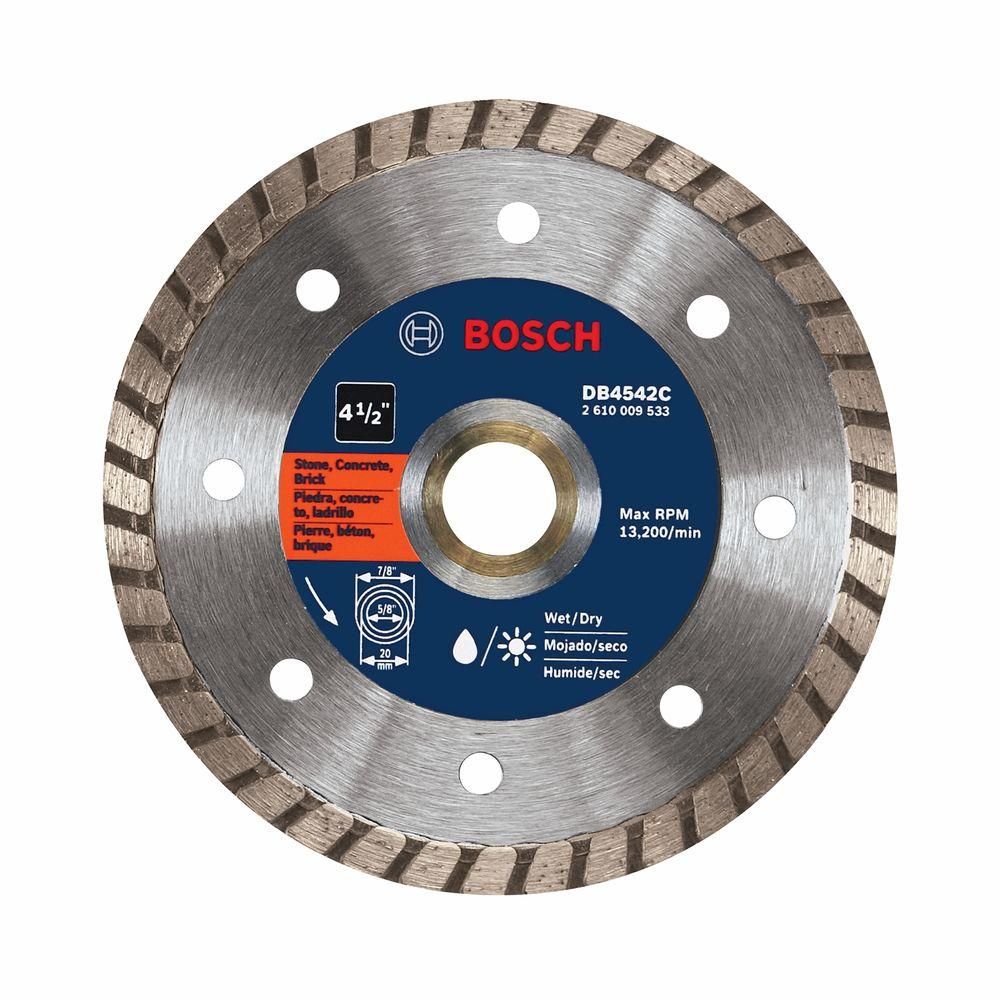

Angle grinder.  A masonry supply company will have the correct blades (thick to clean the joint).  This will be real dusty....there are shrouds for angle grinders that will direct the dust and a special shop vac will also help.  If you have an assistant they could hold a homemade (plastic bottle) dust shroud on the end of a shop vac hose.  Get the right shop vac filters.
diamond...
