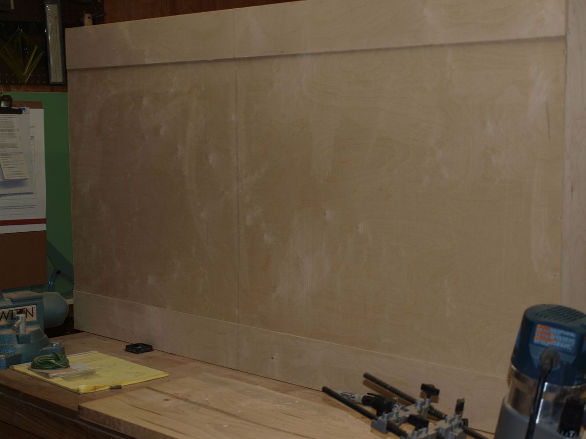

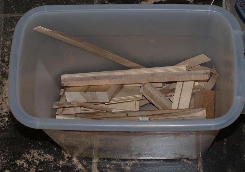

February 24, 20197 yr comment_179769 no composites.. utilize the base as storage... cabinet and base separate... rebate rabbeted and mortise joints... build as wide a cab as you can in one piece... engineer your cuts so there isn't any waste... see the pic.. (21LF of cabinets) rethink the back of your cab... see the picture.. pull out shelves... dust lip the doors and drawers... face frame... full extension glides... avoid imported plywood... don't set the base directly to the floor... hold it off the floor w low profile nylon chair glides... in the advent of water issues the cabinets won't suffer any damage and the the floor will dry quickly under the cab... better insect and vermin control too... full continuous flooring under the cabinets... make the flooring under the cabs waterproof... create a water dam behind the cabinets on/at the base of the wall... Report

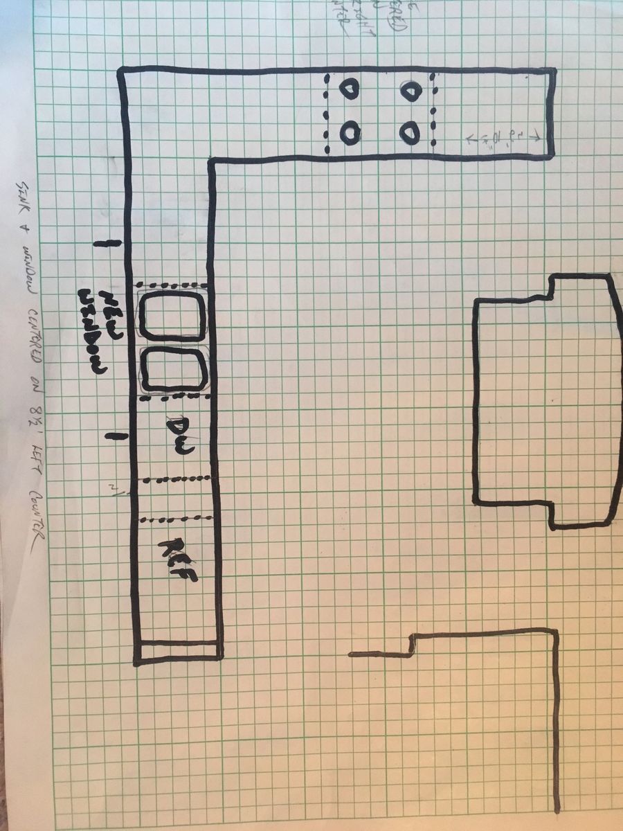

February 24, 20197 yr Author comment_179804 Great ideas Danl & Stick. Over the next few weeks I will be preparing the space - gutting the existing kitchen, leveling the floor and getting the layout plan done. I have the rough idea in my mind, but I will have to draw it out to scale so that I can install new lights and renovate the ceiling, move wiring and plumbing around as needed and it will then be on to cabinets. Oh yeah, one other "side project" will be a half bath which is just off the kitchen space. This past week while working on leveling the living room floor I did get under the stairway and modified the floor joist to accommodate a relocation of the toilet. Further info, if it will help: the kitchen will be an "L" shape, 14' x 10'3". The 14' is an outside wall. I will post up a rough sketch of my thoughts later this morning regarding layout. Report

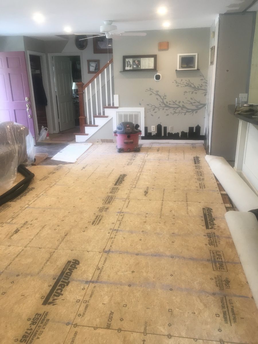

February 28, 20197 yr comment_180330 On 2/24/2019 at 7:02 AM, Cal said: Over the next few weeks I will be preparing the space - gutting the existing kitchen, leveling the floor and getting the layout plan done. I have the rough idea in my mind, but I will have to draw it out to scale so that I can install new lights and renovate the ceiling, move wiring and plumbing around as needed and it will then be on to cabinets. Oh yeah, one other "side project" will be a half bath which is just off the kitchen space. Cal, are you planning to gut the kitchen, before the cabinets are fab'd? Danl Report

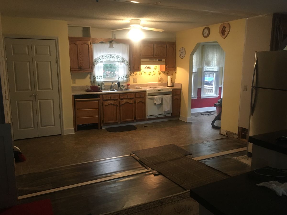

February 28, 20197 yr Author comment_180378 10 hours ago, Danl said: Cal, are you planning to gut the kitchen, before the cabinets are fab'd? Danl Yes, I have to gut the kitchen. The floor has a big dip in it that I have to address first. It is nearly a 1" sag in that area in front of the stove. I plan to remove the pantry closet to the left of the existing counter today. Then tackle the floor in the room off to the right of the kitchen in the pic and then pull the lower cabinets out and do the kitchen and 1/2 bath floor. I expect to place the existing cabinets back into place after the floor is completed while I work on the cabinets and change/upgrade the space. From the starting pic above, my initial plans call for removal of the pantry on the left, wall off the room to the right of the kitchen, relocate range to the new wall with a microwave/vent fan combo above it. New upper cabinetry along the right hand wall only. Relocate the fridge to the space where the pantry is and recenter the sink with a new and larger window on the existing exterior wall. A whole host of side/accompanying projects to complete while all this is going on. I will call in reinforcements as necessary, but most all of this project will be me - working alone. I have braced the wife for six months, minimum to have things tore up. Luckily (?), she works out of town and is usually gone 4-5 days out of the week. So that week that I tackle the kitchen floor, I can deal with no sink and no range/oven since I will be here alone. If I get it back in place by Friday evening it's all good! Report

March 1, 20197 yr Author comment_180481 22 hours ago, JIMMIEM said: @Cal, What material for the counter tops? Jim, subject to change - but right now we are thinking quartz. 22 hours ago, Stick486 said: do you know why??? Stick & @schnewj - there have been two major water disasters since we have lived here. The first was a water filter under the sink that put about 2-3 inches of water over the kitchen-dining area (that room off the kitchen). The second was a hot water pipe that burst under the house. I think it was some few days before discovered. Then there was the water heater that leaked for a time with no pan under it, just soaked into the osb subfloor until it was discovered under the house by the bug man... 9 hours ago, Woodbutcherbynight said: Had a friend had same issue they found the floor joist had sagged. In this regard, I did have two piers added under the main beam that divides the kitchen space from the living room. Prior to taking out a load bearing wall here, I had the piers placed where new support posts where installed to hold the 2nd floor beam that replaced the wall. As I came across the living room space, sistering joists and leveling the floor, the main beam we are referring to would be at the right edge of the new OSB underlayment in the above picture. This main beam does sag about 5/8" in the center, right in the area of the right hand "Advantech" stamp is on that sheet of OSB. That beam is two 2x10's nailed together and spans about 10' (best I recall) between piers. What it "used to" hold up, was flooring on each side - 10' kitchen side & 8' LR side, load bearing wall and upstairs floor, 10' and 16'. With the new layout this span will only have the 10' & 8' kitchen-living room flooring and whatever load (the kitchen island) that is placed on it. The floor joists and the main beams in the living room have all been in good, sound condition. The particle board underlayment was pretty "wavey". The 7/16" OSB subfloor was "ok" in the front half and pretty weak and not good at all the closer to the kitchen and that corner where the water heater was located. Appreciate all your thoughts. Report
