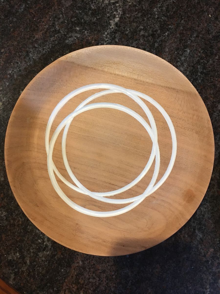

February 22, 20197 yr Popular Post comment_179462 These are what I have come up with as a new project for the off center chuck. The colored rim platter is about 8 inches of pecan. Originally I tried to cut with point tool and burn the circles——not good. Tried several tools and found that my new Hunter Viceroy with a #1cutter works superbly with no tear out on cherry nor on pecan. Had to do something to highlight the cuts as they just did not stand out plain. Painted with acrylics then sanded the over painted area. Pecan one may get liming wax later, but for now has lacquer on rim and Watco on center. The painted areas were sealed with shellac. The cherry will get Watco over shellac. Report
February 22, 20197 yr comment_179468 Never thought this type of design could be done with that chuck. I like it. Report
February 22, 20197 yr comment_179525 Super Design and execution!! Thanks for posting this, Gerald!!! Report
February 22, 20197 yr comment_179550 very nice Gerald. Like Dan, I guess I didn't realize that chuck was so versatile, never imagined a person could do work that large with it. Steve Report
