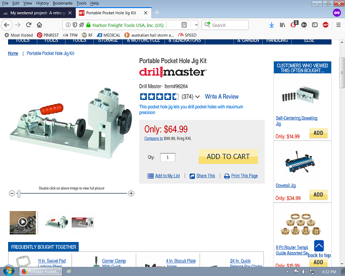

5 minutes ago, Stick486 said:
a jig from the 50's...
I'll have to dig my relic out. Probably from the late 50's or early 60's. Many years ago, a retired woodworker gave it to me at his selling out garage sale because I knew what it was and how it was used. It's fixed vs adjustable. Solid chunk of steel.
I have the HF pocket hole jig, and it is one of thode gems that HF has I got mine for around $39. with coupons they have periodically. It is all metal and well built.
Herb
Go H-F

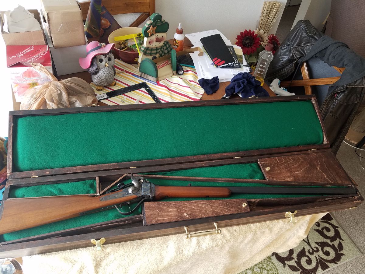

On 2/7/2019 at 7:23 PM, Monkey Paws said:
homemade alkanet root stain
I would be interested in seeing the recipe for this stain if you feel like sharing.  As to the rifle, did you acquire it in good shape, or was it a restore job.  The case is impressive.
22 hours ago, Grandpadave52 said:
Go H-F
I will have to check it out.  Thanks
I got the recipe for the stain from one of my antique firearm forums. It is a stain from the 1700s that some English gunsmith's used.
Alkanet Root Stain
1 part     Alkanet root powder.
1 part.    Turpentine
2 parts.  BLO
Mix ingredients together and place container in a dark place. If stain is not put in a dark place it will darken too much. Wait 6-9 months and the stain is ready to use.
The Sharps is a Italian copy that I purchased used from Gunbroker.
One sweet gun...and the case looks like it was just made for it.:P
They compliment one other exceedingly well. Thanks for sharing the story and build.

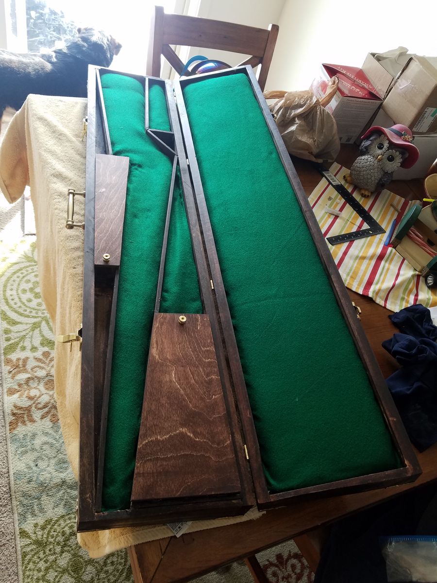

Right nice case. Great English fit for the rifle. The grain on the lid is just awesome.
Great job on that rifle case.  Simple yet elegant, just like the rifle.  +1 to the comments about the lid grain orientation.
