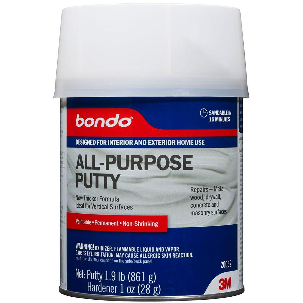

The box stores carry a repair putty.  It gets hard and sticks to the wood.  Can be carved and sanded.

Work with it on a few test pieces first.  It has a learning curve.  Trust me I have seen some bodyshop work that has been sent our way for alignments.  Can always tell when they have someone new to the trade.
The Bondo has limited working time so you need to work in small batches. I found that the lid of a coffee can (or similar) made a good mixing surface as the dried material can be popped of by just flexing the lid. VOE use multiple lids and mixing sticks (I buy bags of "popsicle sticks" at a craft store which can be cleaned and reused) but, VOE here, don't use the same lid/mixer for consecutive batches as the residual catalyst on either will start the set-up process early and the open time will be greatly reduced.
Can Bondo be turned safely?
Have not tried but should be able to as it is sanded to get a smooth surface.
if you get the stuff with fiberglass fibers, it'll hold together better than the plain bondo
Yes.  Produces a lot of dust.
When I use Bondo, I let it set up for a few minutes, then rough shape with chisel or razor blade.     Then let it dry some more and sand it with 120 sandpaper.   The carving saves a lot of time.
Forgot to mention, another option, and more durable one, is stick epoxy.  Quikwood is one brand you can find at hardware stores.   Mohawk makes a similar one, must faster curing (~ 5 minutes) and comes in about 12 colors that you can intermix.   Cut some off the end of the stick, knead it until the color is uniform, then apply.  Press into rough shape with fingers or an AARP card wet with soapy water,   When it's semi-cured, refine shape with a chisel, knife, or razor blade and when fully cured final shape with rasp or sandpaper.
