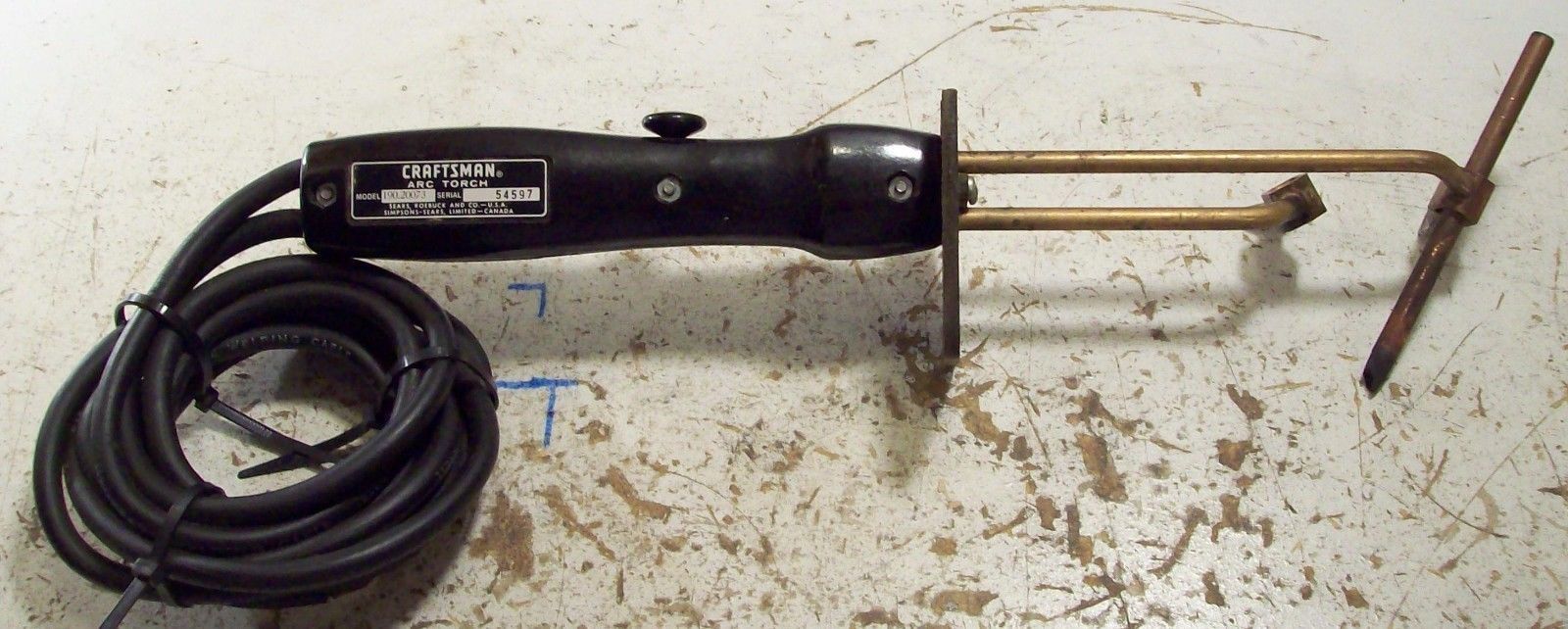

January 31, 20197 yr Author comment_176503 39 minutes ago, Marv Rall said: This may be a bit off topic but------- If one ever needs to cut cast iron, or steel, try this-----with stick welder turn amperage to 225 or higher if your welder has that option-----use some 6011 rod and prepare for some excitement. Be sure to have your pant leg cover your shoe tops---those little hot buggers do burn. Back in the days when I didn't have a cutting torch that was how all my metal was cut. I've done that too Marv and you're right, those buggers really burn. I also had a carbon arc torch attachment I used to use for heating + brazing also...that was a challenge learning to use. If I had more money than sense, well in fact I do so not a good analogy, so I'll rephrase; If I had plenty of extra disposable cash, I'd own a plasma cutter not that I really could justify one. Report

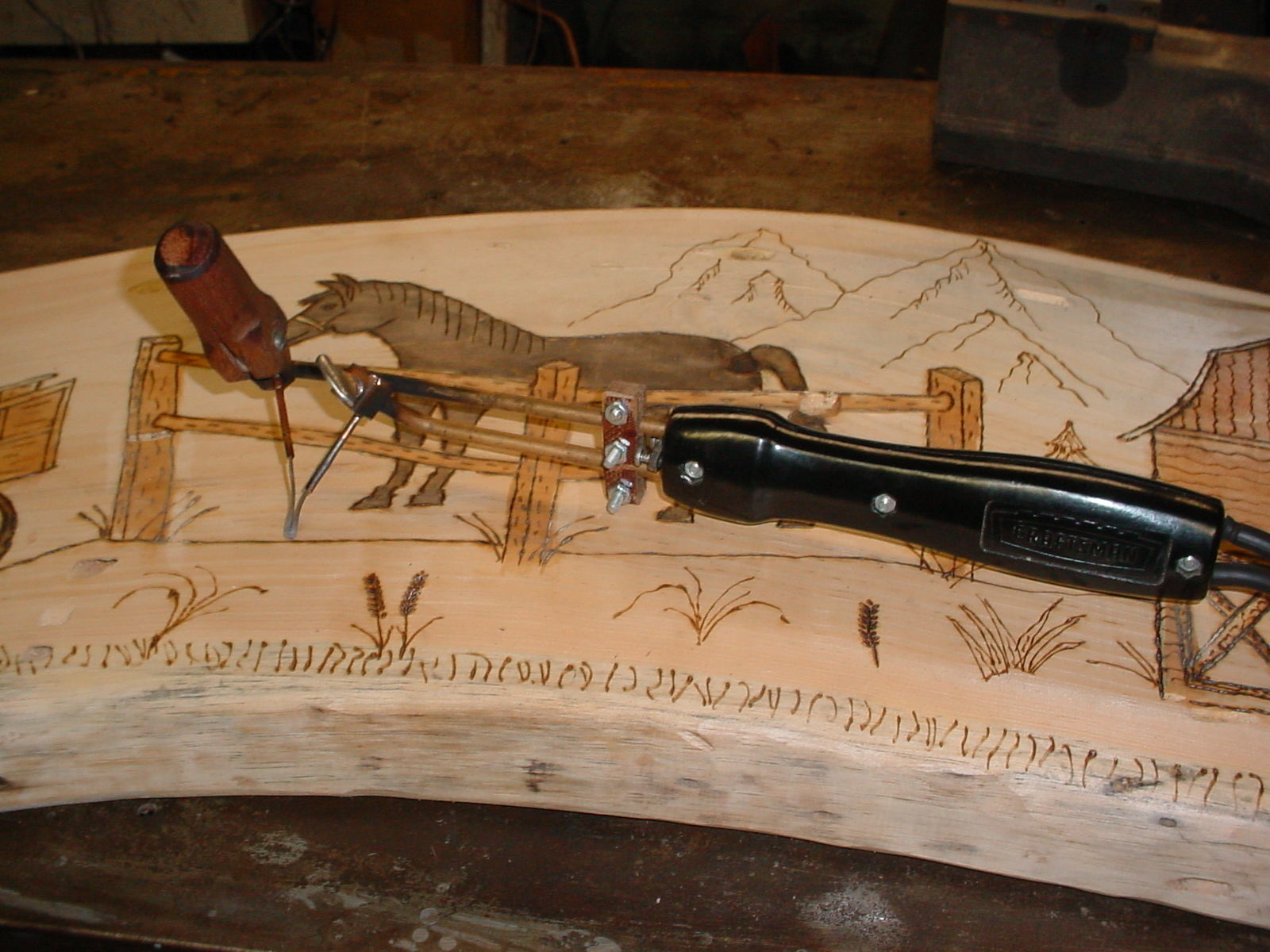

March 5, 20206 yr comment_220547 The carbon arc torch makes a good wood burner... Edited March 5, 20206 yr by Kevin Beitz Report
March 5, 20206 yr comment_220593 I've used carbon arc for cutting and gouging steel. Never seen what you have pictured here. Report
