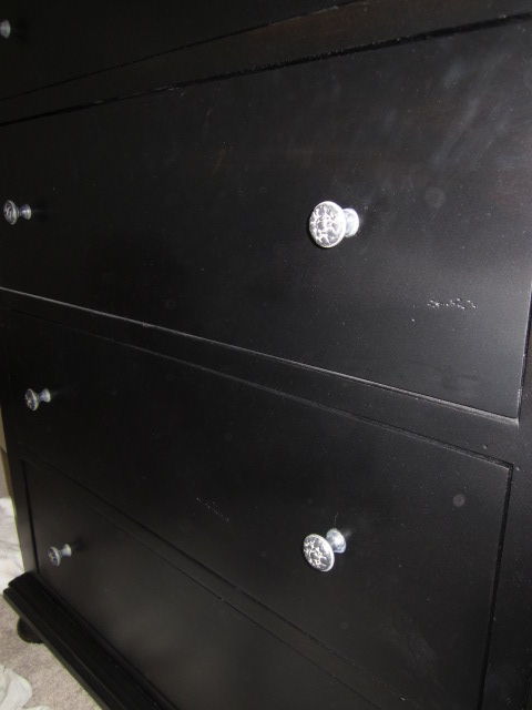

January 5, 20197 yr comment_172702 As mentioned above, shellac is another option. Both it and lacquer are easily repairable because new and old coats melt into each other. (This is one of the reasons why 99% of commercial furniture is lacquered) All you need to do is a cleaning, a bit of sanding if there is some damage, and brush or spray on another coat. If you can find it, pre-cat lacquer is a bit more durable. Personally, I'd avoid poly because it's durable but not very repairable. I think epoxy is even less so. You can't strip it off and if, say a plate gets dropped, it may crack as the wood dents. I see the major dangers are body oils, change getting dropped in, and rough handling between collections. One of today's jobs -- lacquer. Besides the paint transfer, depressions all along the line Report
