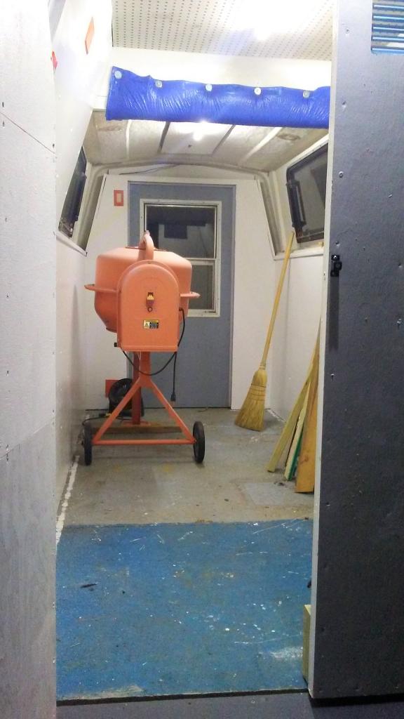

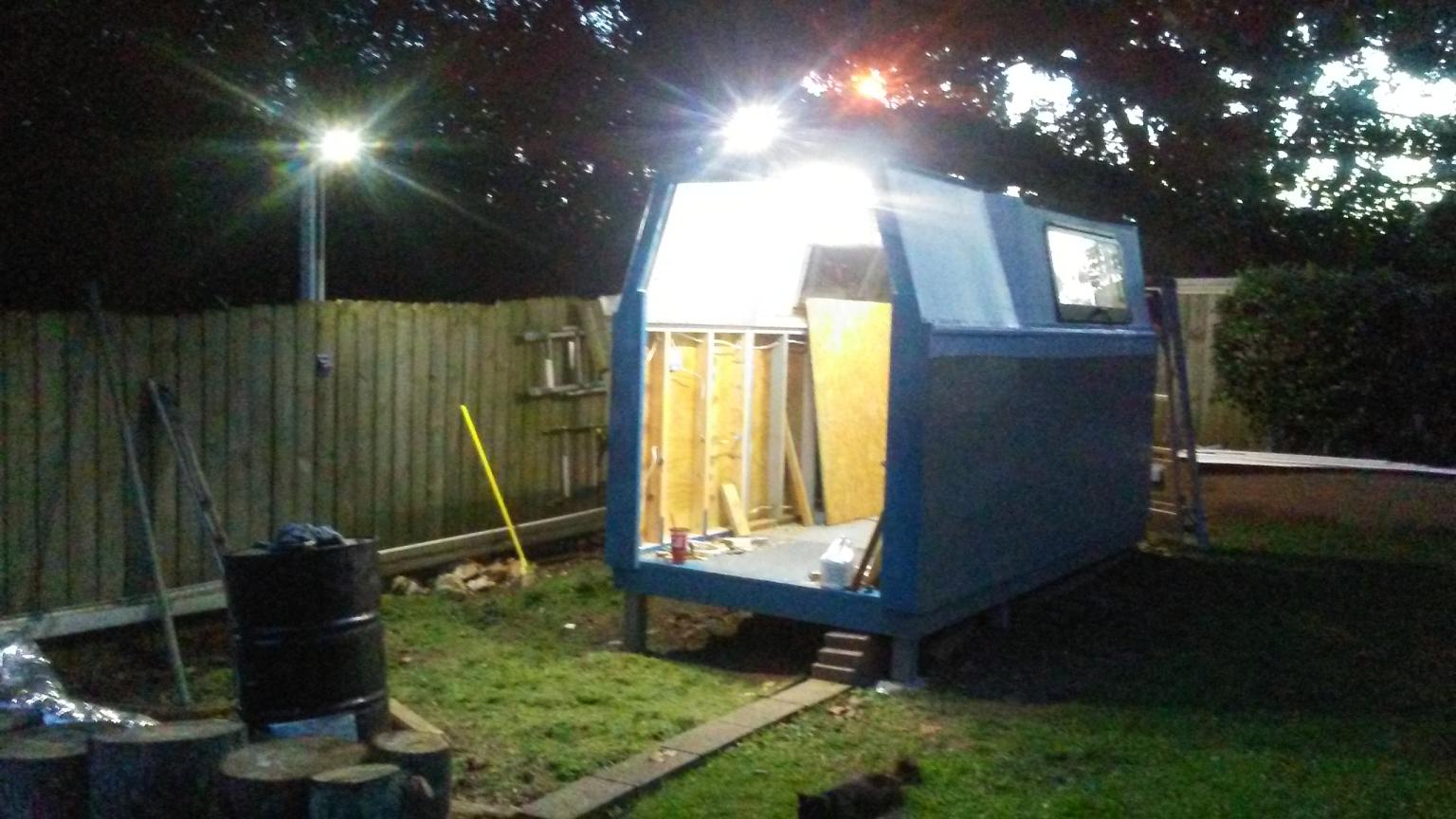

December 27, 20187 yr Popular Post comment_171395 47 minutes ago, Gerald said: Led bulbs (at least the 4 foot type) are not omnidirectional Very true. I bought 4 tp replace 2 of my 4 foot fixtures in add on shop. Brighter directly, yes. But they point straight down and no deflection as you pointed out. They are okay, but Home Depot had 3ft LED fixtures on sale for $10 while supplies lasted. Got 4 and put them up in various places. Much better even though they are shorter. Put one up on each end of this small shed and wow lots of light. In the shop a quick test of turning it on and off to see if it outshined the 4 ft Florescent tubes showed promise. No too bad and it did improve the lighting just above and in front of the Drill Press. But they also do cast more shadows. Same was true but worse with the 4 ft drop ins. It's a give and take to some extent. Lots of choices to be had. My progress toward changing out all the florescent fixtures has been slow as I get one of a certain type and see how it goes. Have a few more coming in next few weeks hopefully an improvement I can see real progress with, and not have a Chernobyl meltdown occur in my wallet. Report
