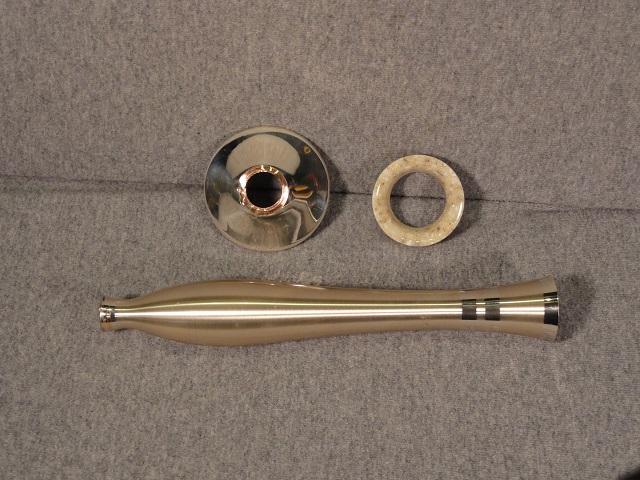

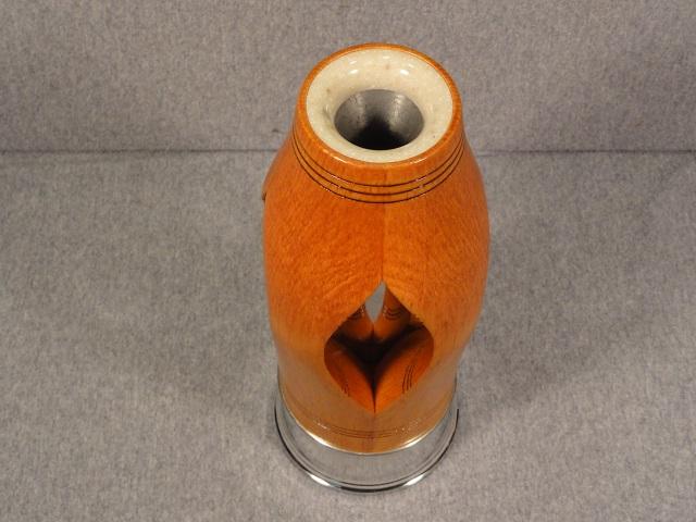

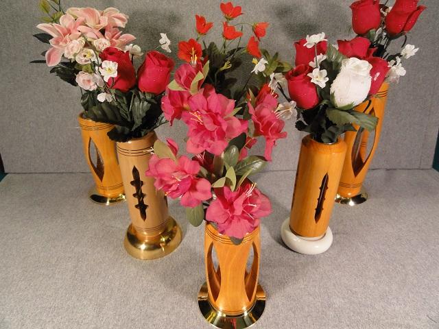

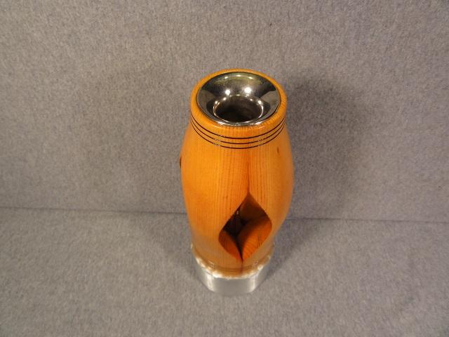

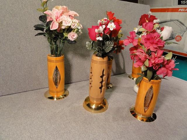

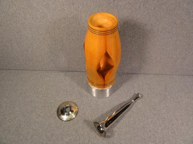

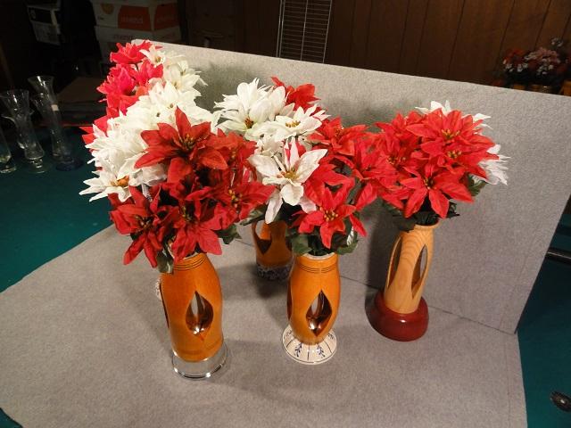

December 16, 20187 yr Popular Post comment_170138 Been working on some inside-out vases for a couple weeks. They're done. These are for my brothers and sisters. Next weekend is the family party and we will use these as the center pieces. I have been collecting some metal vases at the Restore and reused them as inserts to make them capable to hold water for real flowers. Most of them had to have their bottoms cut off to make them smaller than the bodies of and the tops. I fit each one individually to there respective turning. Some of them had a top that was smaller than the body. For them I made a bushing from plastic counter top material. There are six of these and I made six smaller ones for some friends. I had another one on the lathe and finished it today and still have a few more glued up but these will fill my Christmas list. Most of them are made from from some fir panel doors in a 100 year old house. Report

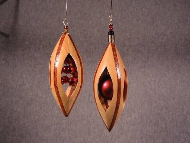

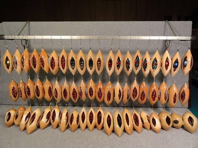

December 17, 20187 yr Author Popular Post comment_170256 1 hour ago, Artie said: So you’re a woodworker, AND a machinist. Those are fantastic. Are these something you make on a regular basis? Or is this a most likely one time project? The breadth of projects in this hobby amazes me. Thanks Artie. I have a metal lathe but all the work for this project was done on the wood lathe. Soft brass,copper and pewter can be cut on the wood lathe with the same tools if one is careful. I made a vase like this for my mother years ago and these are the first vases since. I have done other inside-out projects like these ornaments I did last year. Report
