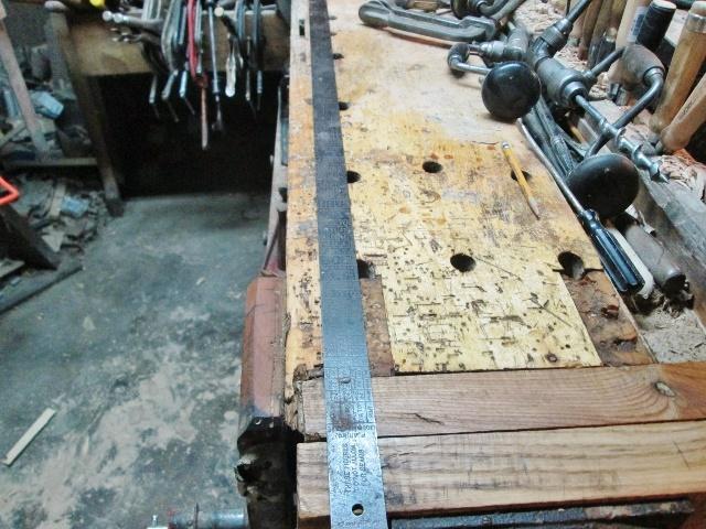

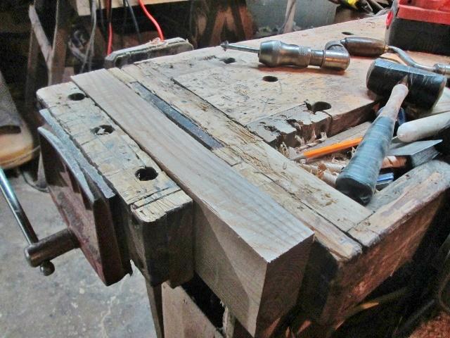

December 5, 20187 yr Popular Post comment_168560 Ok, between Projects at the moment....took a long look at the vise that has seen so much use...and abuse the last 3 years...or so.. Uummmm, yeah. Managed to dig a "dog" out of the bench.. Had to pound it down out of the bench, in fact. May work on ti as well.. Methinks this needs a new set of jaws...may replace the chewed up end of the bench, while I am at it.. Fingers keep getting little slivers up under fingernails...easy enough to remove... May be a couple more under the jaws. Depending on the next trip to Menard's...about when some 2x cut-offs can be brought home. Metal part of this vise came from a vendor @ Tractor Fest 2015...$10..... Then added a few boards to.. Added a thicker jaw to allow for bench dogs... Grandson wants a Coffee Table, too...wonder IF I can get this vise fixed up, first? We'll see.. Report
December 5, 20187 yr comment_168562 Maybe some poly, lacquer, something on all that before you reassemble. Bit of protection ya know? Report

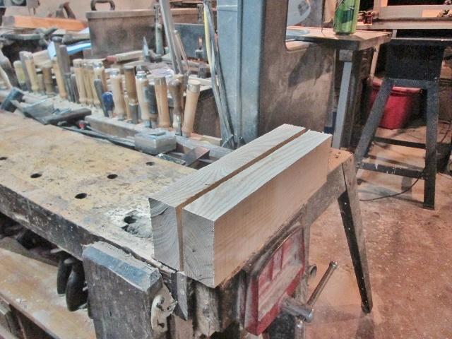

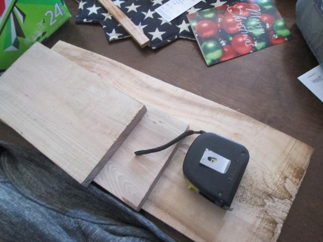

December 10, 20187 yr Author comment_169047 Today, I went to crosscut the 2 x 4 down for jaw parts...Craftsman 7-1/4" saw was deep enough to make the cuts...problem? Seems the saw had fallen onto the floor..not only bent the guard, it broke it...Was able to free the blade up, enough to make a few cuts...stacked those up, out of the way... Middle two will be the jaws...other two are...undecided..yet. Looks like I'll have to "retire" the old saw Will be on the "look out" come spring sales... Both seem about the right size...fitting the non-moving end will be a bear ( anyone want to help) Leg is in the way, otherwise, I could center the vise.. We'll see....may route out a recess for both metal jaws to sit into...need enough room for dog holes, too.. Stay tuned.. Report

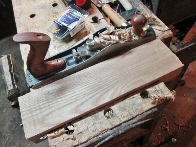

December 10, 20187 yr Author comment_169061 Still have that 6" SKIL Home Shop saw......works like new....just doesn't cut as deep as the Craftsman did.....and, I don't feel like running the Craftsman without the guard... Planed the one jaw smooth, may get to the other one, later...Not sure IF I want to route out a recess for the metal jaws to sit in... Report

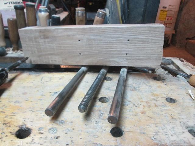

December 11, 20187 yr Author comment_169197 After a glue up, today...had to flatten one face of a jaw.. Decided to go ahead and install this in the vise...which meant removing this "thing" Clamped the new jaw in place, and marked where the LONG FAT screws needed to go.. Had to drill pilot holes...wax the threads , to drive 4 screws...#12 straight slotted flathead screws... I set the new jaw slightly proud... Once I can get the rest of the rebuild done..I can plane both jaws to match each other...I did lay out for the dog holes... Have the right drill bit. Going to wait until the vise is done...recheck the lines, adjust if need be, then drill. 12" brace? For now..I'll see how this works...stay tuned Report

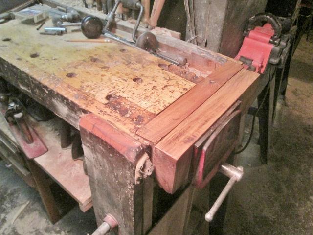

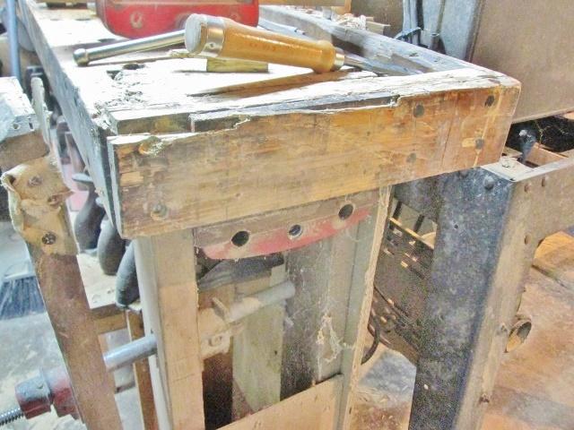

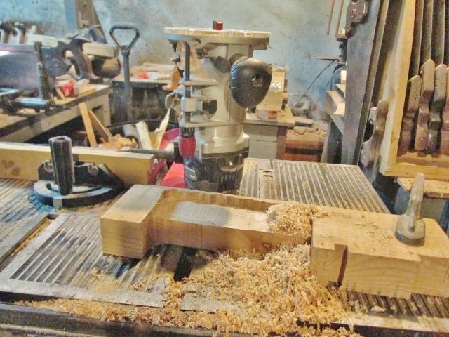

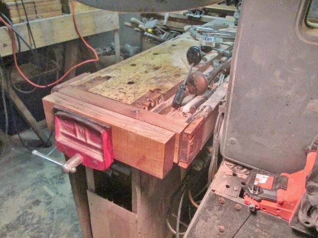

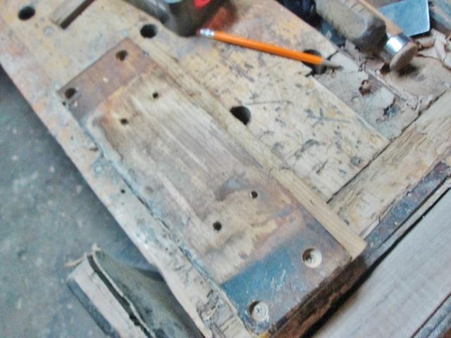

December 18, 20187 yr Author Popular Post comment_170464 Ok...Time for part 2....had some digging to do.. First thing was to remove this thing from.. This mess...Chisel is because many of the screwheads holding the wood in place were too buggered up...I split the wood off the screws, and visegrips to crank the screws out..and right into the trashcan. Two screws were to be saved... 2 lag screw, with washers...what was left? Once again...chisel to split the chunks off, visegrips to crank the screws out...even had two coming up through the tool well... Lots of notches to do...tool well, back of bench, shelf for the vise...rebate for the jaw to sit in...test fit? Close enough. May add a veneer to this face, anyway...for now, need to install this jaw Predrill for the lags..twice first was too small....then find a breaker bar to drive the lags in tight... More drilling, and countersinking to attach it to the bench...3" screws into the legs.. Then add more from the sides. Had to add one screw, check the height of the jaw, add another....trying to get this level with the top of the bench...sand the face flush and smooth. Time to try to assemble things..a few times.. Idea was to install this, check for fit....pull it back out ( this thing ain't light, either) fine tune the fits... Also got tired of the leg vise "chop" always in the way, no longer too tall...Had to sand and plane the top edges, until they matched. Gave all the "new" wood a coat of that smelly BLO.. Laid out for at least one dog hole.. Drilled one hole. . Got this one about deep enough...decided to do the others later... Brace is a PEXTO #8012, 12" sweep, Samson Chuck. Bit is a Craftsman #13 Sweep the floor, move things out of the way...will need to make a few round dogs...need to take the bit along and buy a dowel. For some reason, I am a bit tired....letting the smelly BLO cure out a few days (weeks?) and see how the "new" vise works out. May decide to dress up that corner...stay tuned... Report
December 18, 20187 yr Popular Post comment_170469 Sweet...almost too nice to use now. Knew you couldn't stay out of the Dungeon very long. Well, just to be sure you do, give it a couple more coats of BLO...outta' keep you out until the end of the month...maybe? Report
December 18, 20187 yr Popular Post comment_170478 Now with the nice vice you will have to refresh the rest of the bench Report
December 22, 20187 yr Author comment_170914 Well, the only way a new top would happen....would be to build new bench....not in the budget, right now... Drilled another dog hole in the vise, centered on the middle row of dog holes...whew...takes a while to get things to the right depth... I did have a dowel on hand....was a tad too fat,,,got it "slimmed" down....and made two sets of dogs... 2 longer dogs..with a notch...can be used with the notch or not...and.. A pair of these short dogs...A strip of plywood keeps racking away...notch in use... And, notch not in use....board was a hair too short..that plane? Stanley No. 3c....3 patent dates. dogs held well enough for the plane to make a few Ash shavings... Not sure IF any BLO will get on the dogs... Stay tuned Report
